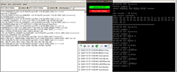

I’ve now built something equivalent, the gr-satellites UPloader, based on gnuradio.
It uses the gr-satellites block Check AX.25 address to recognize the source or destination callsign of a received packet and the block Telemetry Forwarder to upload the data (switchable).

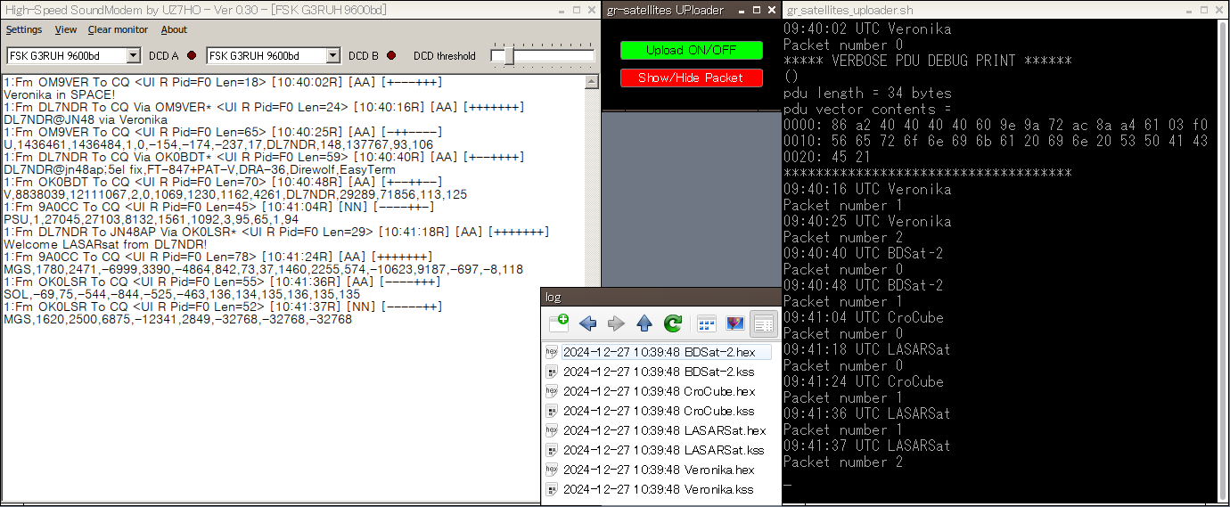

Additionally, it counts the packets, prints its content in hex (switchable) and stores the data as .kss and .hex files named after the satellite.
The uploader can be updated easily via a .ini file with new satellites (callsigns, Norad IDs) and settings for your modem (url, kiss port) and target database (url, sender’s callsign, coordinates).
Packets received by (in this example) the High-Speed SoundModem are timestamped, counted, displayed in hex (if activated), stored as .hex and .kss, and of course uploaded (if activated).
Using this uploader prevents you from uploading non AX.25 packets.
If you also have the problem to decode yourself (mostly near TCA) while digipeating, this uploader also prevents uploading of packets sent by you (instead of your digipeated packets).
This is done by the updated block Check AX.25 address which is checking the so-called hbit.
Have fun.

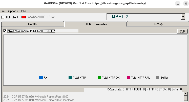

Nice developement, but a correction on the Telemetry Forwarder.
The Online Telemetry Forwarder was replaced with GetKiss+ and if you make sure you use a recent up to date TLE set all new satellites will be available to forward to the SatNOGS database.
As an example ZIMSAT-2 one of the latest satellites launched and active.
The TLEFILE option in conf.ini determines what TLE set is used
