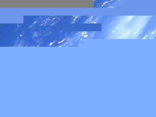

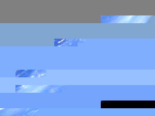

I managed to get this image from only 17 frames I received successfully before the end of the broadcast. Many thanks to Vlad and Scott!

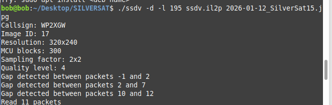

This is all I managed to collect. The packets: Packets

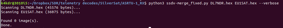

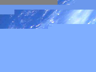

If I go through your file as well as the decodes from EU1SAT and manually copy/paste any frames (in order) that only one of you have into a new file, SSDV then is able to render a more complete image. However, I stopped after a couple dozen frames just to prove the concept. I’ve emailed the author of the ASRTU-1 ‘combine’ script that Bob shared to see if he would have time to create one for the 195-byte frames from SilverSat. I just updated the references to ‘256’ in his script to ‘195’, but something more is required. If I get a reply from him, I’ll post the new script so that multiple HEX decode files can be combined!
Here is my short copy/paste test - clearly some of the missing parts are now complete.

I got an amazingly fast reply from Phil, the author of the SSDV utility.
Skipping to the end, here is that same chopped up, partial image after combining the captures from EU1SAT & DL7NDR:
… quite a difference, huh?

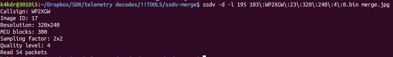

So here is the sequence when you have multiple HEX decodes:
Screenshot from 2026-01-15 20-22-08
… and then use SSDV as usual on the resulting -new- combined .BIN file:
… in the same folder, you should then be able to view the resulting JPG file!!

Here’s my latest attempt from EM12 (North Texas). The SSDV started at about 29 degs elevation as the bird headed over my horizon. Maybe someone can use the hex file (remove .txt). Looks like it may be the same photo as above.Nice to get at least part of the shot!

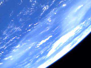

We downloaded the current pic at the SilverSat ground station this evening. This is the first complete SSDV we’ve received at our station, and we were able to receive two successive copies during the pass. We’re sending the next week’s schedule up to the satellite over the weekend. I’ll post it here when its uploaded.
