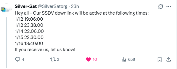

SSDV transmission schedule:
1/12 19:06:00
1/12 23:38:00
1/14 22:06:00
1/15 22:30:00
1/16 18:40:00
from x.com/SilverSatorg

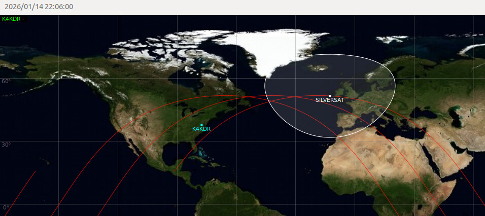

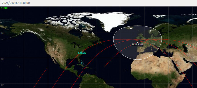

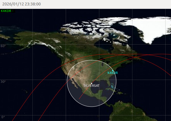

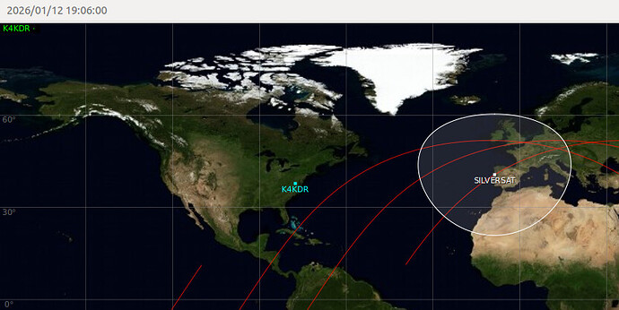

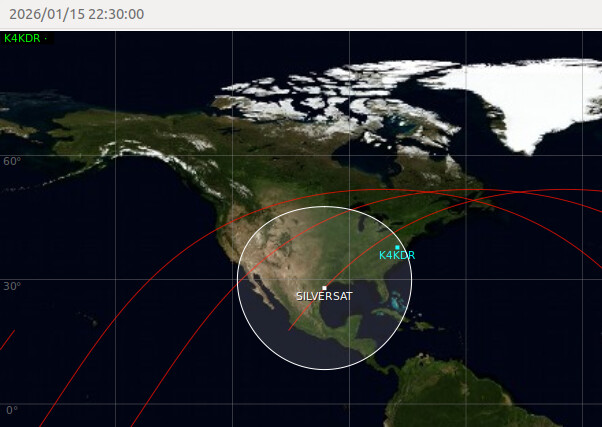

Great news! Assuming those are UTC times, here are the corresponding positions (time in upper-left)

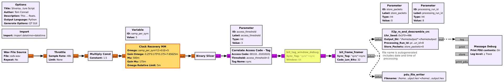

I then adapted silversat_realtime.grc to the below version to work with my recorded wav file.
After 5 minutes of processing, I got this 42.5 KB binary file: silversat_realtime_outputfile.bin(remove.zip).zip (42.5 KB)
At last I processed this file using ssdv with ./ssdv -d -l 195 silversat_realtime_outputfile.bin output.jpg

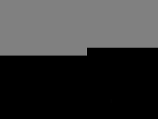

Great job! Obviously we don’t have the frames to render an entire image, but the ability of SSDV to give us partial pics sure is better than a JPG where you get zero if a single frame is missed!

Could you please share the .GRC file shown in the picture? Thanks!
can you decode using recorded audio from this obs
Thank you - downloaded the linked file but it bears little resemblance to his working solution pictured, so I didn’t even know where to begin.

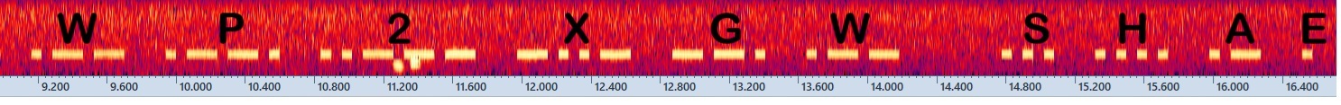

the CW beacon is strong SatNOGS Network - Observation 13186540
