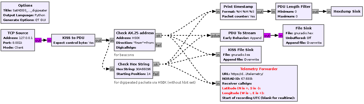

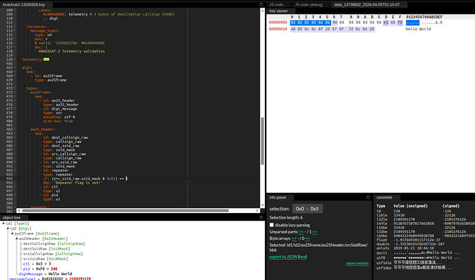

You’re right, the hbit doesn’t unset following repeater protocol.
You don’t see it in this example, because there is no digipeater callsign.
The hbit is the most significant bit in the digipeaters SSID byte.
Since my gr-satellites UPloader only uploads if this hbit is set, I’ve prepared another GNU Radio flowgraph to check just for HS0K in the digipeater field (without hbit set) to upload the packet.
Please enter your callsign or station name along with your coordinates into the Telemetry Forwarder block before use.
SatNOGS_uploader_for_KNACKSAT_2_digipeater.grc.zip (1.4 KB)

DO1AM was able to digipeat 3 times via KNACKSAT-2 on 2026-04-09 at 10:02:08, 10:04:37 and 10:04:43 UTC and uploaded it.
The digipeater callsign was however not HS0K but 0x61 0x48 0x77 0x64 0x3b 0xd4 (aHwd; ).
Something broken?
Almost sounds like the received (digipeated) packet had CRC errors?
The CRC is not uploaded.
But had there been any CRC errors, the packet would have been discarded.
