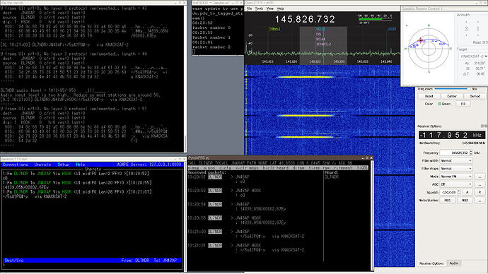

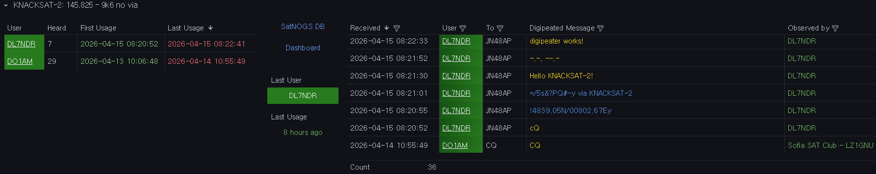

2026-04-15 06:46 zenith pass
Was digipeated 12 times as can be seen in observation 13822014 and 13808647.
The ground stations and I were unfortunately not able to decode the packets due to weak signals.
Will try it on the next pass.
I’ve identified the bug in the decoder. It’ll soon be fixed so the dashboard will show the already digipeated and uploaded packets.

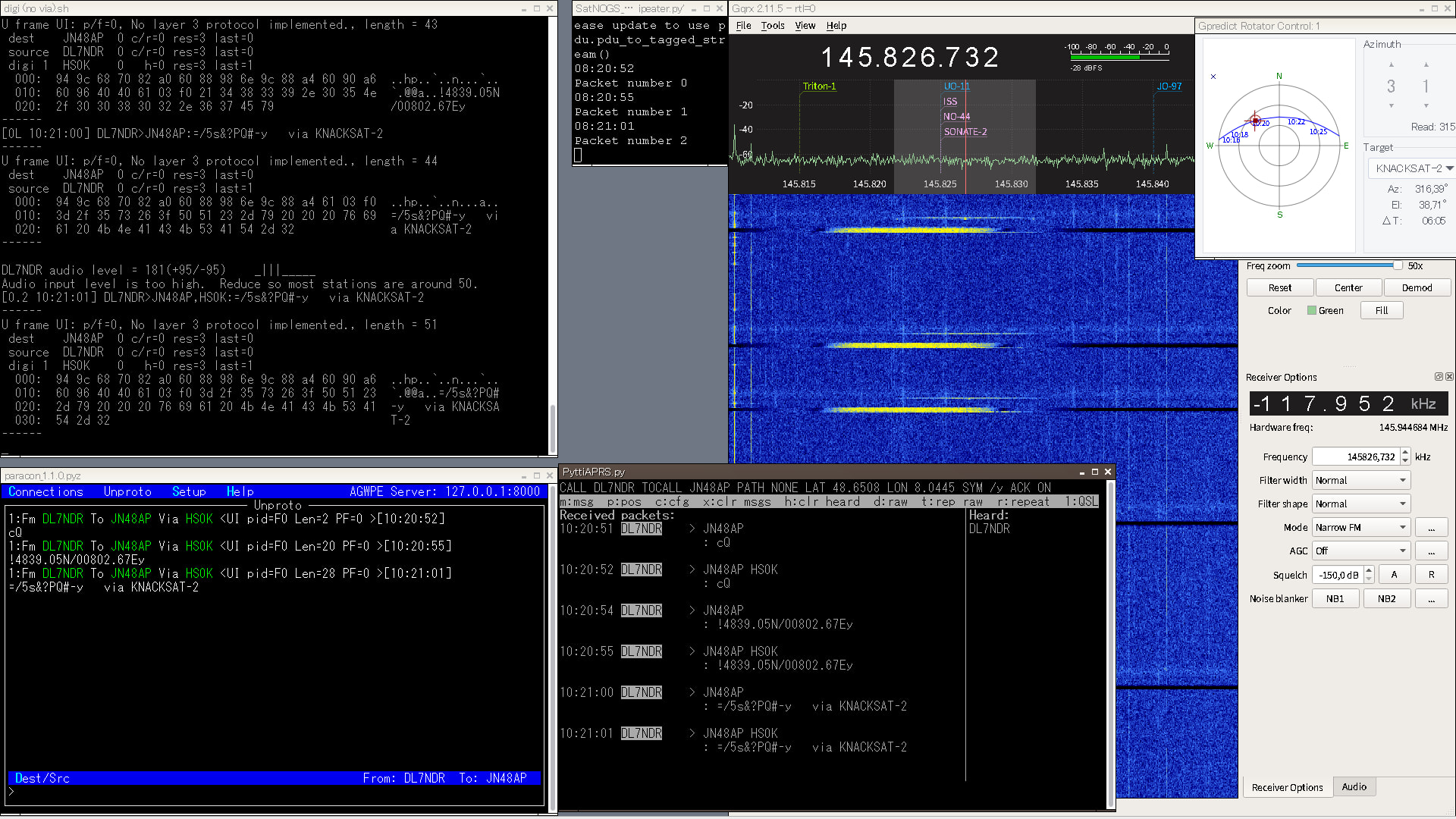

Finally, decoded KNACKSAT-2’s digipeater at 08:2x UTC.
09:5x UTC
Unfortunately, the digipeater’s via callsign is again invalid.
94 9c 68 70 82 a0 60 88 98 6e 9c 88 a4 60 c5 e6 8e 8d fe c5 61 03 f0 63 51
You may decode it to bsGFþb.
KNACKSAT-2 decoder fixed, Dashboard now shows digipeated packets.
Cheers!!! Let’s work with other features :slight_smile: :smiling_face_with_sunglasses:
