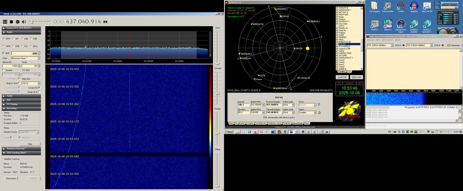

RSP-03 over KO33ru
WIMO 2x9 el.

I saw the amazing waterfall plot from EU1SAT — it looks like a very clean signal from RSP-03 around 437.040 MHz, beautifully tracked over KO33ru using WIMO 2x9 el antennas. This gives us valuable insight into the signal stability and Doppler profile. Thank you for this excellent capture!

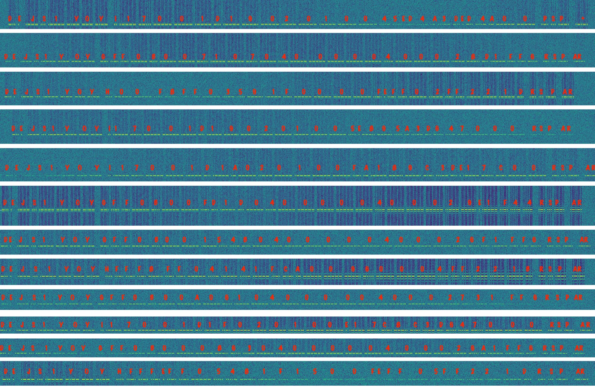

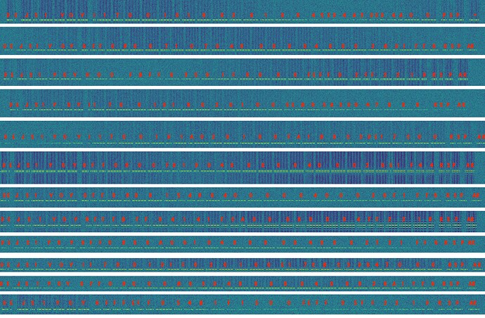

We used the Dwingeloo telescope to observe RSP-03 for four passes today. Each of the observations show good signals in both horizontal and vertical polarization.
IQ data is available at SatNOGS IQ data as mentioned above.
Using the IQ data, I manually decoded the CW and submitted it through https://db0smg.de/~dl7ndr/rsp-03.html, so they all show in the dashboard.

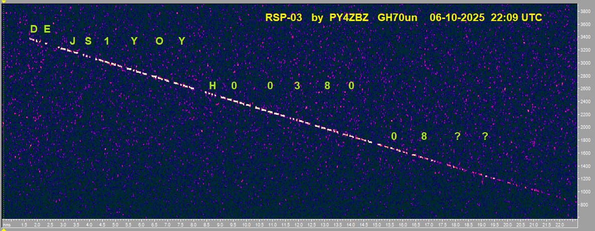

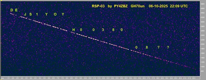

RSP-03 copied over Brazil with a 15 dBi 10 el. OWA Yagi
