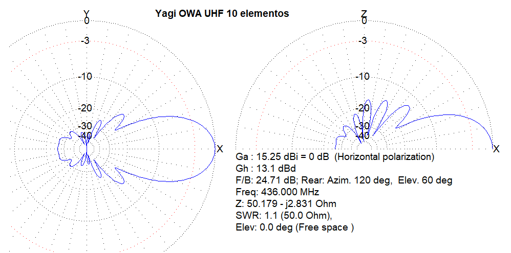

Hi,@PY4ZBZ
Thank you so much for the clear CW capture of RSP-03 and for sharing the plot.
May I ask a couple of details about your setup so we can better compare with other receptions?
  • The “15 dBi 10-el OWA Yagi”: is that 15 dBi referenced to free space (not dBd)? Do you have an approximate gain vs. frequency curve around 437 MHz?
  • Front-end: any LNA in use (gain / NF), coax type & length, and estimated total feedline loss?
  • Polarization used during that pass and whether you used manual tracking or fixed pointing?
  • Approximate SNR of the CW in your receiver (dB in 2.4/3 kHz, or RBW if different)?
With your permission, we’d like to use your numbers as a reference point to cross-check other stations’ results. Thanks again for the excellent report!
czh00361(estima5633)

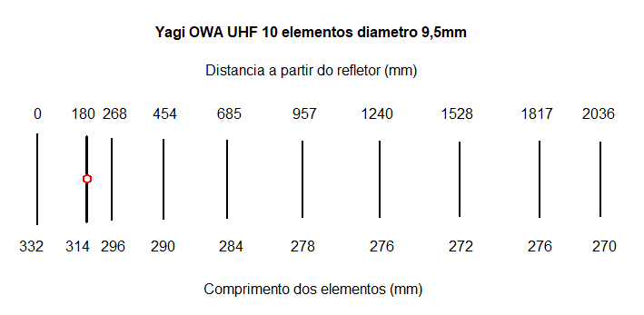

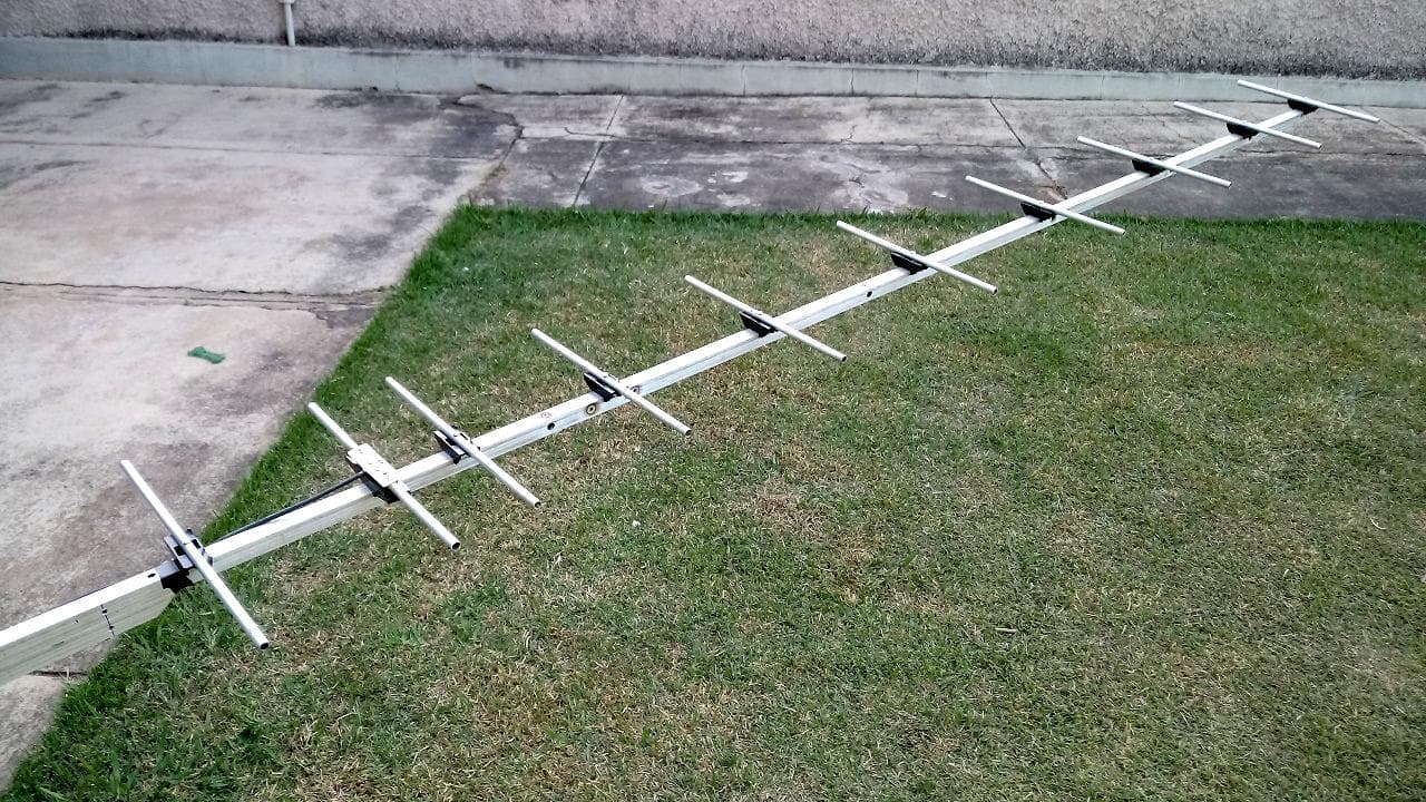

My homemade antenna
My homemade preamp 23 dB gain NF<0,5 dB :
https://www.qsl.net/py4zbz/prea.htm
Feedline loss 1,6 dB.
Manual orientation on the balcony. H pol or V pol. (this RX : H pol.)

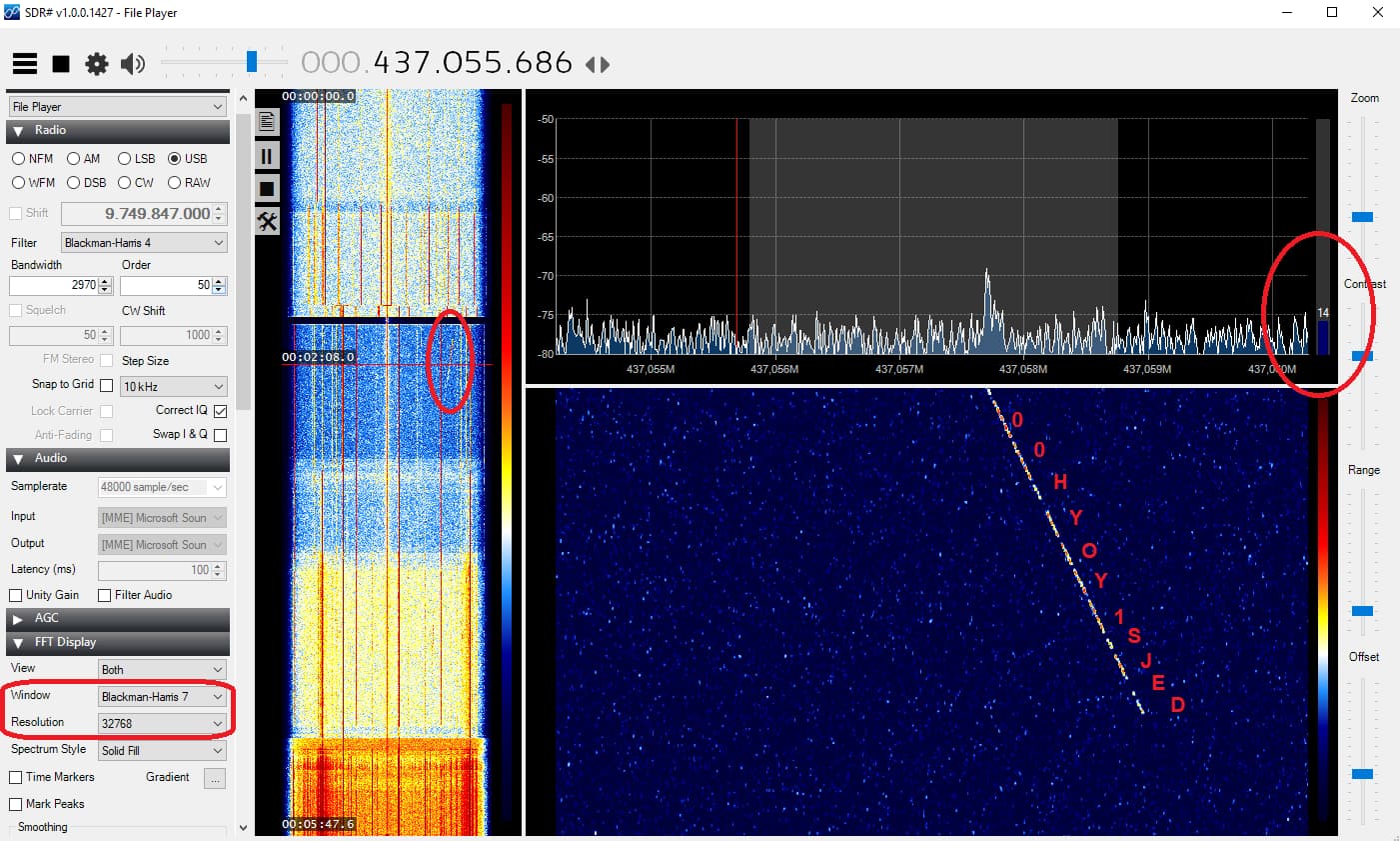

SNR in the folowing picture from SDR# and FunCube dongle pro:
73 de PY4ZBZ
Subject: RSP-03 reception by PY4ZBZ — link budget cross-check
HI,@PY4ZBZ
Thank you PY4ZBZ for your impressive reception report of RSP-03!
Your 10-element OWA Yagi with 15 dBi gain and 23 dB LNA (NF < 0.5 dB) achieved a very clean CW trace at 437.055 MHz around 22:06 UTC on 2025-10-06.
We confirmed that object 65732 (RSP-03) indeed passed over southeastern Brazil at that time, roughly 1000 km slant range and 30–40° elevation.
The resulting FSPL ≈ 145 dB → expected RX level ≈ −83 dBm, which seems consistent with your SDR# screenshot.
Could you please confirm if the observation was done with horizontal polarization only (no switching)?
We are trying to understand if the good SNR may imply partial antenna deployment or favorable polarization match.
The FSPL and RX level calculations were made together with ChatGPT for verification purposes — I believe they are reasonable, but would appreciate confirmation from other experts as well.

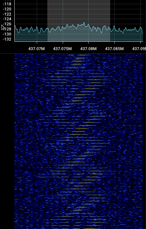

In https://network.satnogs.org/observations/12548804/ (H) and https://network.satnogs.org/observations/12548805/ (V) we tracked GHS-01 and saw convincing signals at the expected frequency and with the correct Doppler. So we are convinced that GHS-01 is indeed 65733. The signals look very strange (like a double helix in the spectrum), maybe an on board failure of some kind.
Here’s a usb demodulation of the recorded IQ, at -6kHz and 8kHz wide, wav:
12548804_usb.zip (271.7 KB)
Thanks for demodulation. We were also confused by the shape of the waveform, we suspect it may be due to some kind of onboard malfunction:

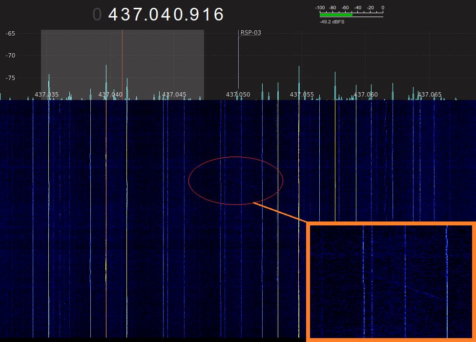

If you have good eye sight, or a really good imagination, MAYBE a hint of RSP-03 on the 2.5-turn helical omni 14-Oct 1134utc over the Eastern U.S.
Could not find it in Inspectrum, so this is my only image.
Hi @K4KDR,
Great catch! It looks quite similar to what we observed here in Japan.
Using SDR# and a V-dipole setup, we detected a clear vertical trace around 437.0499 MHz on Oct 14 (UTC+9).
Here’s the capture: https://x.com/irotori_h/status/1974408503185100806
It might correspond to the same faint signal you spotted near 437.040 MHz — possibly RSP-03’s CW or GMSK beacon.
Dwingeloo has already confirmed reception of GMSK from RSP-03, so your signal could indeed be part of the same transmission path.
(https://network.satnogs.org/observations/12511022/)
Thanks a lot for your continued monitoring and for sharing your spectrum snapshot!
Glad to help!
Please note that while my doppler tracking had moved farther to the left at the time of this screen shot, the observed mark (possibly from RSP-03) was right at 437.050 a few minutes earlier.
Just didn’t want anyone to think they should be watching at the lower freq. Will keep looking!
