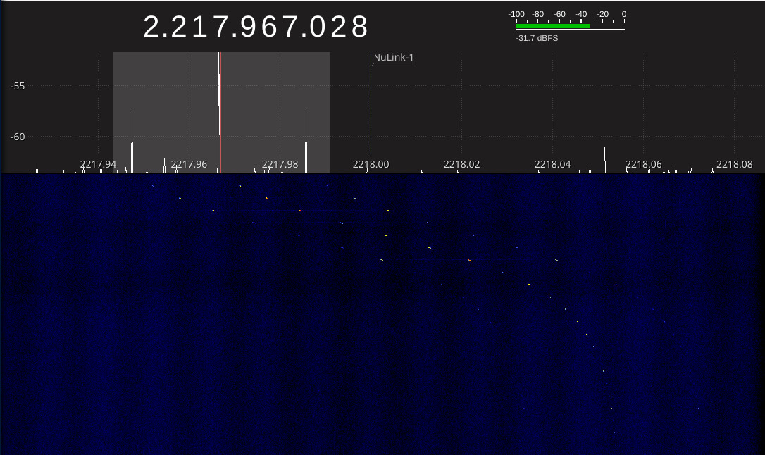

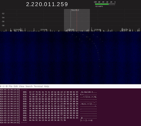

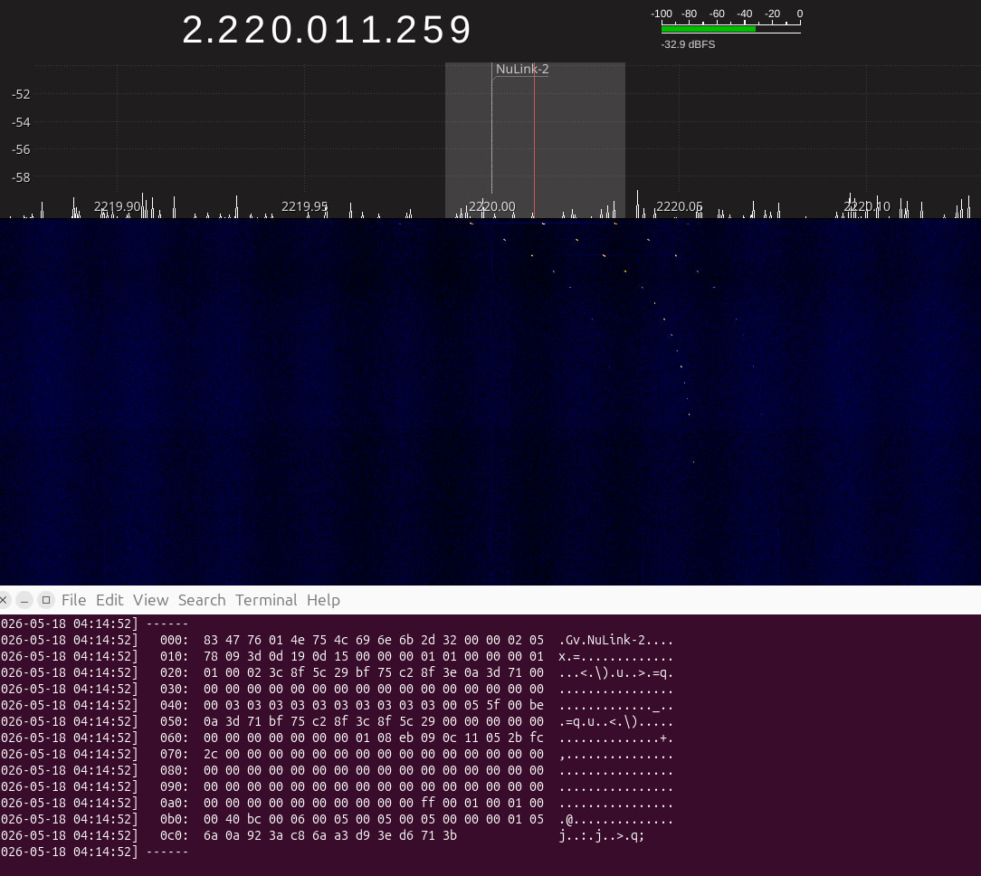

To complete our check of the NuLink sats, tonight I was able to confirm that NuLink-1 is still active on S-Band. Unfortunately not quite enough SNR on this pass to decode the 38k4.

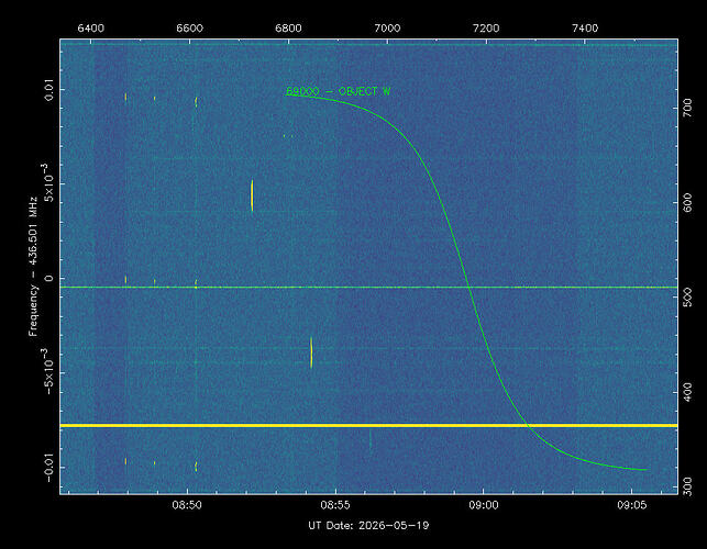

The NORAD ID 69000U seems to be mismatched with GEMINI-POLLUX again.
The current TLE for NORAD ID 69000 no longer matches the observed Doppler curve:
1 69000U 26100W   26138.83335647 -.00062350  00000-0 -56861-2 0  9999
2 69000  97.7056  35.8729 0011987  48.0412 344.6182 14.95387147  1301
Using the TLE from a few days ago, it still matched the observations very well. The fitted TLE that was used is shown below:
1 69000U 26100W   26136.40949124  .00001324  00000-0  13578-3 0  9992
2 69000  97.7354  34.4638 0001856  57.9473 302.1926 14.92103209  1965
The nearby objects are still relatively far from the observed Doppler curve. The closest candidate seems to be object 68999, but it is still not a good match.
It isn’t the first time this happens with large deployments, lets keep monitoring.

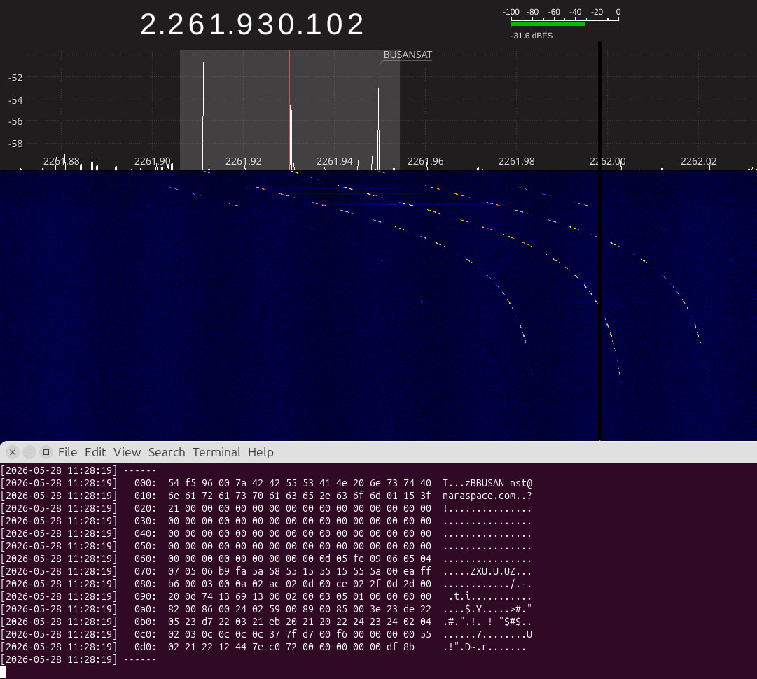

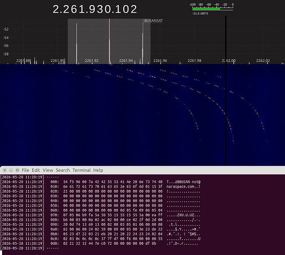

So pleased to finally be able to report both RX and decodes from BusanSat!
https://x.com/scott23192/status/2058782174887793030

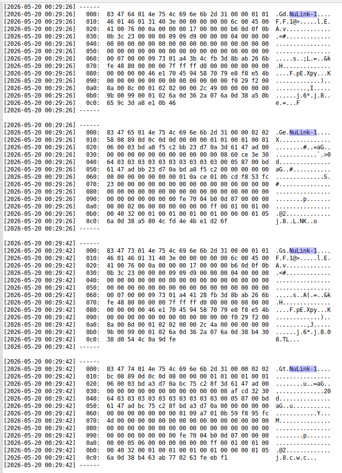

… same 38k4 settings as used w/ NuLink-1 & 2.
Since this one was not transmitting on every pass here, I didn’t know if I would get a pass with enough elevation -and- an active downlink.
… if anyone would like to do any testing, a short crop of the strongest packets is available as a 32-bit float I/Q file (samp rate = 375000) at:
https://www.dropbox.com/scl/fi/aklw9j6lbri3nnh7kd8oy/gqrx_20260525_040500_428950000_375000_BusanSat-crop.raw?rlkey=pdp8qbdye0xjge4teoweptrwt&dl=0

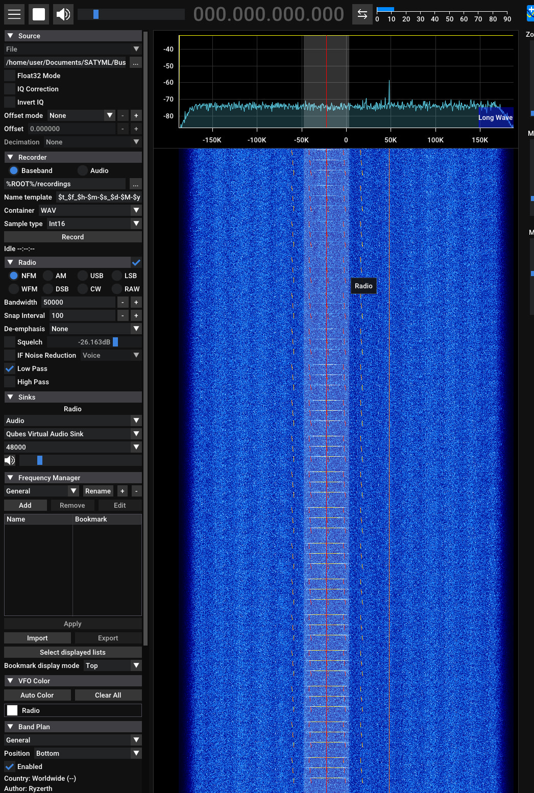

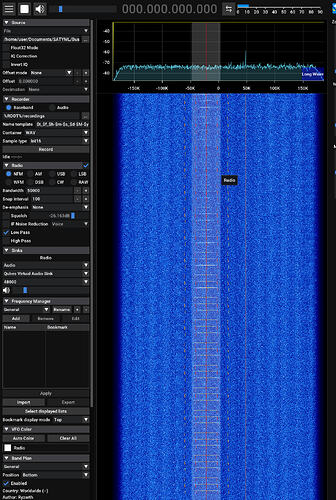

try convert your floating 32 to sdrpp wav, and waterfall signal seen like below. correct?
use nfm, because cannot use usb because usb max only 1200 hz.
try create satyml
norad: 68989
  &tlm Telemetry:
    unknown
  38k4 FSK downlink:
    frequency: 2218.000e+6
    modulation: FSK
    baudrate: 38400
    deviation: 9600
    framing: AX100 ASM+Golay
    scrambler: CCSDS
    syncword: 4
gr_satellites BUSANSAT.yml --audio --samp_rate 48000
but no decode data
Thanks @K4KDR and @bali

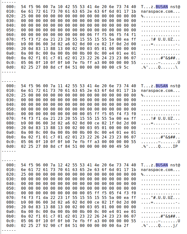

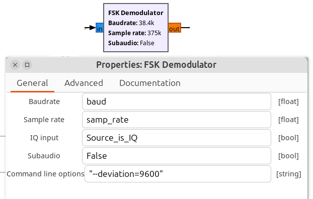

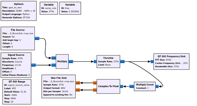

After converting the IQ and also moving it to the center of the IQ, I got the following signal and frames.
Then the following command was used to decode:
gr_satellites BUSANSAT.yml --rawint16 gqrx_20260525_040500_428950000_375000_BusanSat--crop.wav --samp_rate 375000 --iq

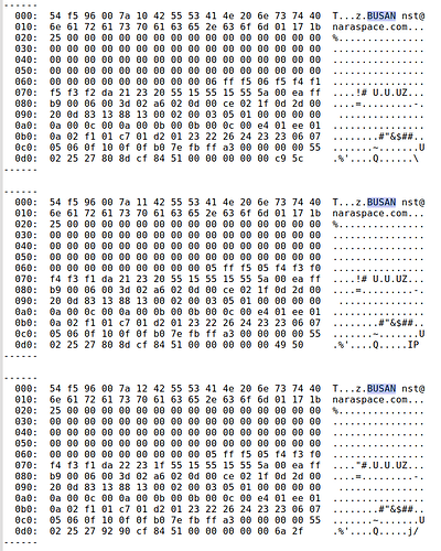

((transmitter . 38k4 FSK downlink))
pdu length =        223 bytes
pdu vector contents =
0000: 54 f5 96 00 7a 10 42 55 53 41 4e 20 6e 73 74 40
0010: 6e 61 72 61 73 70 61 63 65 2e 63 6f 6d 01 17 1b
0020: 25 00 00 00 00 00 00 00 00 00 00 00 00 00 00 00
0030: 00 00 00 00 00 00 00 00 00 00 00 00 00 00 00 00
0040: 00 00 00 00 00 00 00 00 00 00 00 00 00 00 00 00
0050: 00 00 00 00 00 00 00 00 00 00 00 00 00 00 00 00
0060: 00 00 00 00 00 00 00 00 00 06 ff f5 06 f5 f4 f1
0070: f5 f3 f2 da 21 23 20 55 15 55 15 55 5a 00 ea ff
0080: b9 00 06 00 3d 02 a6 02 0d 00 ce 02 1f 0d 2d 00
0090: 20 0d 83 13 88 13 00 02 00 03 05 01 00 00 00 00
00a0: 0a 00 0c 00 0a 00 0b 00 0b 00 0c 00 e4 01 ee 01
00b0: 0a 02 f1 01 c7 01 d2 01 23 22 26 24 23 23 06 07
00c0: 05 06 0f 10 0f 0f b0 7e fb ff a3 00 00 00 00 55
00d0: 02 25 27 80 8d cf 84 51 00 00 00 00 00 c9 5c
0000: 54 f5 96 00 7a 11 42 55 53 41 4e 20 6e 73 74 40
0060: 00 00 00 00 00 00 00 00 00 05 ff f5 05 f4 f3 f0
0070: f4 f3 f1 da 21 23 20 55 15 55 15 55 5a 00 ea ff
00d0: 02 25 27 80 8d cf 84 51 00 00 00 00 00 49 50
0000: 54 f5 96 00 7a 12 42 55 53 41 4e 20 6e 73 74 40
0070: f4 f3 f1 da 22 23 1f 55 15 55 15 55 5a 00 ea ff
00d0: 02 25 27 92 90 cf 84 51 00 00 00 00 00 6a 2f

lol. i forget to centre it..
reply the audio with centering at sdrpp, and voila:
-> Packet from 38k4 FSK downlink

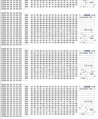

Great, only the telemetry doesn’t make sense, this isn’t ax25, maybe csp.
My guess is that @K4KDR uses a direwolf Virtual KISS TNC to decode the hex data.
Of course you’re correct, Jan. I like the view provided; makes it easy to spot ASCII, for example.
Screenshot from 2026-05-25 18-36-31
Thanks Scott, just gave it a try and got the following output.
And needs some tuning, I only need the hex/ascii part, and tips?
[2026-05-25 20:42:19] [0L] (Not AX.25)T<0xf5><0x96><0x00>z<0x12>BUSAN nst@naraspace.com<0x01><0x17><0x1b>%<0x00><0x00><0x00><0x00><0x00><0x00><0x00><0x00><0x00><0x00><0x00><0x00><0x00><0x00><0x00><0x00><0x00><0x00><0x00><0x00><0x00><0x00><0x00><0x00><0x00><0x00><0x00><0x00><0x00><0x00><0x00><0x00><0x00><0x00><0x00><0x00><0x00><0x00><0x00><0x00><0x00><0x00><0x00><0x00><0x00><0x00><0x00><0x00><0x00><0x00><0x00><0x00><0x00><0x00><0x00><0x00><0x00><0x00><0x00><0x00><0x00><0x00><0x00><0x00><0x00><0x00><0x00><0x00><0x00><0x00><0x00><0x00><0x05><0xff><0xf5><0x05><0xf4><0xf3><0xf0><0xf4><0xf3><0xf1><0xda>"#<0x1f>U<0x15>U<0x15>UZ<0x00><0xea><0xff><0xb9><0x00><0x06><0x00>=<0x02><0xa6><0x02><0x0d><0x00><0xce><0x02><0x1f><0x0d>-<0x00> <0x0d><0x83><0x13><0x88><0x13><0x00><0x02><0x00><0x03><0x05><0x01><0x00><0x00><0x00><0x00><0x0a><0x00><0x0c><0x00><0x0a><0x00><0x0b><0x00><0x0b><0x00><0x0c><0x00><0xe4><0x01><0xee><0x01><0x0a><0x02><0xf1><0x01><0xc7><0x01><0xd2><0x01>#"&$##<0x06><0x07><0x05><0x06><0x0f><0x10><0x0f><0x0f><0xb0>~<0xfb><0x
[2026-05-25 20:42:19] ------
[2026-05-25 20:42:19]   000:  54 f5 96 00 7a 12 42 55 53 41 4e 20 6e 73 74 40  T...z.BUSAN nst@
[2026-05-25 20:42:19]   010:  6e 61 72 61 73 70 61 63 65 2e 63 6f 6d 01 17 1b  naraspace.com...
[2026-05-25 20:42:19]   020:  25 00 00 00 00 00 00 00 00 00 00 00 00 00 00 00  %...............
[2026-05-25 20:42:19]   030:  00 00 00 00 00 00 00 00 00 00 00 00 00 00 00 00  ................
[2026-05-25 20:42:19]   040:  00 00 00 00 00 00 00 00 00 00 00 00 00 00 00 00  ................
[2026-05-25 20:42:19]   050:  00 00 00 00 00 00 00 00 00 00 00 00 00 00 00 00  ................
[2026-05-25 20:42:19]   060:  00 00 00 00 00 00 00 00 00 05 ff f5 05 f4 f3 f0  ................
[2026-05-25 20:42:19]   070:  f4 f3 f1 da 22 23 1f 55 15 55 15 55 5a 00 ea ff  ...."#.U.U.UZ...
[2026-05-25 20:42:19]   080:  b9 00 06 00 3d 02 a6 02 0d 00 ce 02 1f 0d 2d 00  ....=.........-.
[2026-05-25 20:42:19]   090:  20 0d 83 13 88 13 00 02 00 03 05 01 00 00 00 00   ...............
[2026-05-25 20:42:19]   0a0:  0a 00 0c 00 0a 00 0b 00 0b 00 0c 00 e4 01 ee 01  ................
[2026-05-25 20:42:19]   0b0:  0a 02 f1 01 c7 01 d2 01 23 22 26 24 23 23 06 07  ........#"&$##..
[2026-05-25 20:42:19]   0c0:  05 06 0f 10 0f 0f b0 7e fb ff a3 00 00 00 00 55  .......~.......U
[2026-05-25 20:42:19]   0d0:  02 25 27 92 90 cf 84 51 00 00 00 00 00 6a 2f     .%'....Q.....j/
I’m sure there are parsing commands to pull out only the ASCII; I prefer to see both.

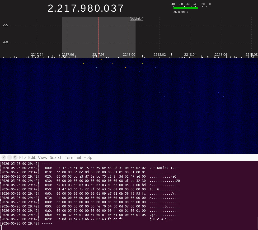

k4kdr@3010i5:~$ more non-ax25_KISS-direwolf.sh
#!/bin/bash
clear
# create 'log' folder under current directory if it doesn't already exist
mkdir -p log
direwolf -c kiss.conf -dup -t 0 -qd -p | ts '[%Y-%m-%d %H:%M:%S]' | tee -a log/$
(date +%Y-%m-%d--%H%M).txt | grep -v -e "0L" -e "Invalid" -e "all communication"
 -e "Troubleshooting" -e "000:  09 00 00" -e "direwolf command line" -e "dest" -
e "source" -e "Station address" -e "Source Address" -e "*** The origin" -e "Dest
ination Address"
… I hope those are helpful.
Thanks Scott,
I combined the two and used some variables, maybe also helpful for you and others.
The ts command is part of the debian moreutils package.
#!/usr/bin/env bash
CONFDIR="${HOME}"/etc
DCONF="${CONFDIR}"/kisstnc.conf
DLOG="${HOME}"/log
if [ ! -d "${DLOG}" ]; then mkdir -p "${DLOG}"; fi
ax25 () {
direwolf -c ${DCONF} -dupkn -t 0 -qd -p | \
	ts "[%Y-%m-%d %H:%M:%S]" | \
	tee -a "${DLOG}"/direwolf-"$(date +%Y-%m-%d_%H:%M)".log | \
	grep -v -e "0L" -e "Invalid" -e "all communication" \
		-e "Troubleshooting" -e "000:  09 00 00" \
		-e "direwolf command line" -e "dest" -e "source" \
		-e "Station address" -e "Source Address" \
		-e "*** The origin" -e "Destination Address"
non-ax25 () {
direwolf -c "${DCONF}" -dupkn -t 0 -qd -p | \
	ts '[%Y-%m-%d %H:%M:%S]' | \
		-e "Station address" -e "Source Address" -e "*** The origin" \
case "${1}" in
	"ax25")
		ax25
	"non-ax25")
		non-ax25
		echo "Exit, no valid input, use ax25 or non-ax25."
		exit 1
esac
Check the variables if you want to use this script.
After that it only need an ax25 or non-ax25 commandline option to run the function needed.
Example kisstnc-direwolf.sh non-ax25

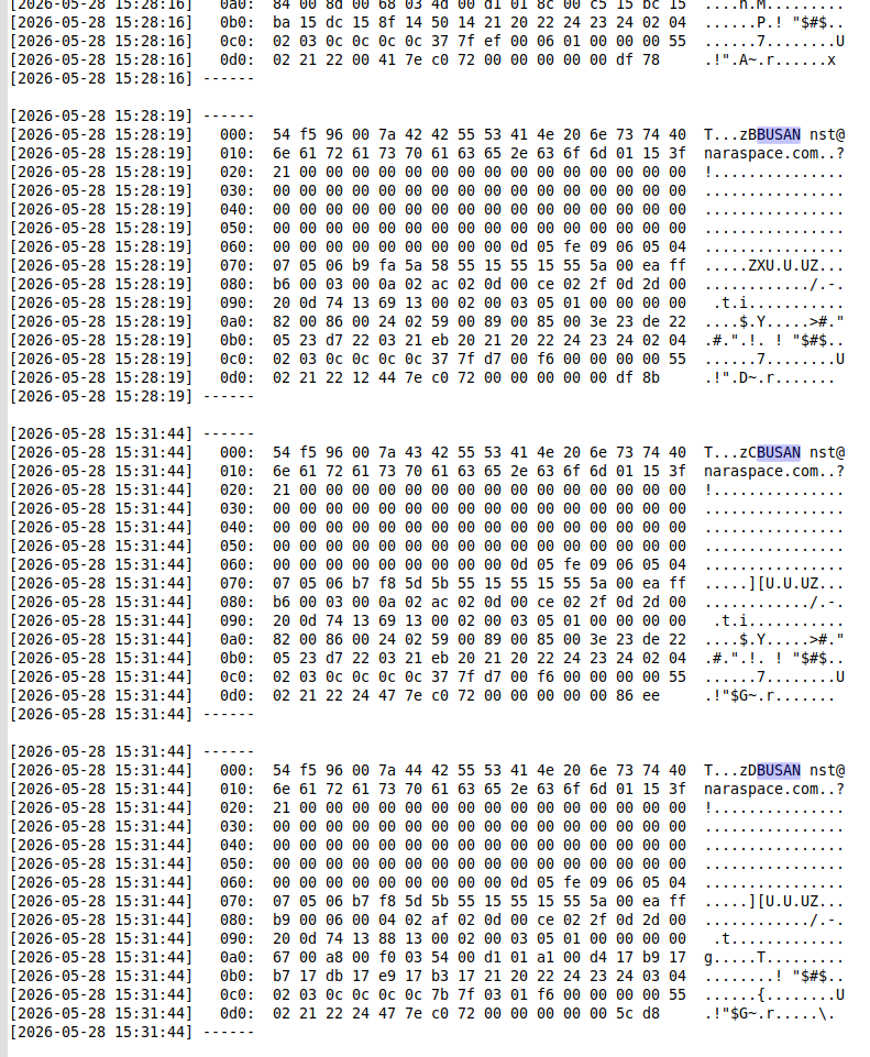

I hope BusanSat doesn’t have a problem…
With the modulation & framing figured out, I was anxious to catch some ‘live’ decodes one of these passes. Tonight I got more than I bargained for: 405 frames of the same 9-byte pattern:
… will have to keep an eye on this one and hope that we see a return to the pretty packets seen the other night w/ some ASCII included. Here’s my post w/ additional images:
https://x.com/scott23192/status/2059503906082652535
BusanSat back to proper frames again. Always hate to see a satellite lock-up or otherwise fail so early in the mission!
https://x.com/scott23192/status/2060030733687603350
