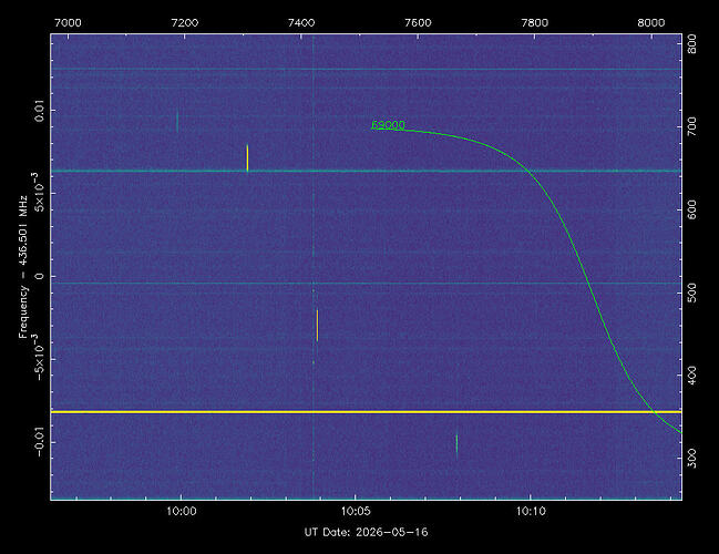

GEMINI-POLLUX NOT matching object 69000 now!
I used old TLE from @pe0sat now:
1 69000U 26100W   26134.19647575  .00001402  00000-0  14346-3 0  9992
2 69000  97.7357  32.2913 0001929  59.4376 300.7033 14.92097460  1638
It is possible that space-track is swapping objects.
For GEMINI-POLLUX apart from the match I found, there where also others confirming the match.
Lets investigate.
SatNOGS Network - Observation 14076274 can someone explain this observation. its look like its a signal but can’t confirm
GEMINI-POLLUX TLE Update
Looking at my latest STRF data I can confirm that the object (69000) data shared by space-track is no longer a match.
When trying to match against new data there is no longer a match, we will need to wait for an update or try to create our own set.

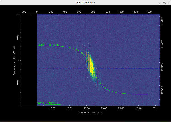

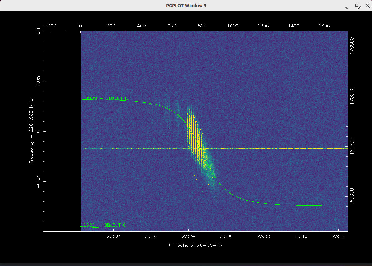

Hi Scott,
I had a look at today’s S-band pass and found a possible match.
At the moment object 68986 is a candidate.
68986: 0.282 kHz 2261.920855 MHz | OBJECT G
Identified 1 candidate(s), best fitting satellite is 68986 - OBJECT G.
0 OBJECT G
1 68986U 26100G   26136.27851732  .00001009  00000-0  10568-3 0  9992
2 68986  97.7394  34.3278 0001030 158.3572 201.7690 14.91734866  1948

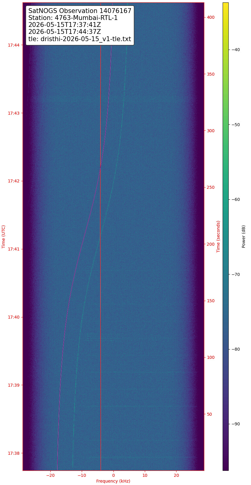

im sure this signal is not from drishti sat. btw since today, seen like dristhi signal is off
is it due to the solar storm g2?
Thanks @PE0SAT I’ve set it for BusanSat in DB to follow it.
last signal SatNOGS Network - Observation 14076167, around 2026-05-15 17:40 UTC
also matches the 2026-05-12 pass at 09:30 UTC

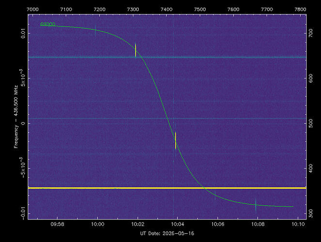

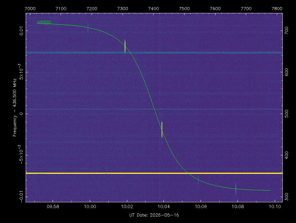

GEMINI-POLLUX TLE Update:
Using the latest space-track TLE object 69000 is again matching the received Doppler data.
We will keep monitoring, maybe just a glitch :wink:
0 OBJECT W
1 69000U 26100W   26136.40949124  .00001324  00000-0  13578-3 0  9992
2 69000  97.7354  34.4638 0001856  57.9473 302.1926 14.92103209  1965

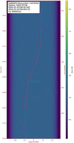

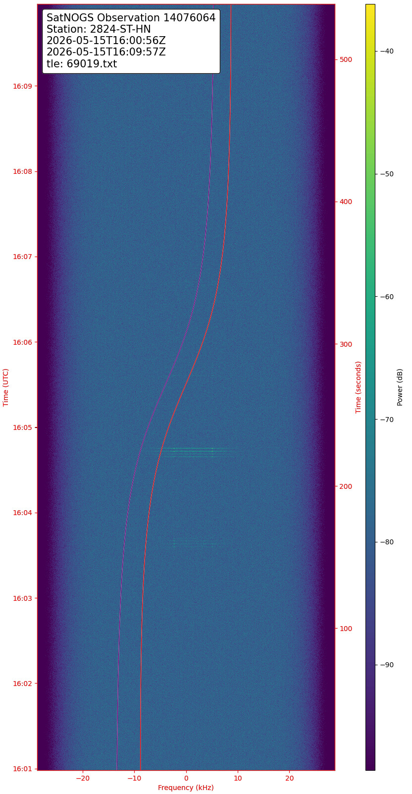

Hey @fredy @bali @PE0SAT Can we observe 98313 on following TLE as we haven"t got any signals since last 24 hrs, can we track on this?
SAT-69019
1 69019U 26100AR 26136.95823444 .00001714 00000-0 82079-4 0 9994
2 69019 97.4070 35.3405 0006640 124.6616 235.5246 15.20261941 2062
SAT-69011
1 69011U 26100AH 26136.95744626 .00001756 00000-0 83860-4 0 9995
2 69011 97.4078 35.3472 0005951 128.8594 231.3173 15.20344987 2066

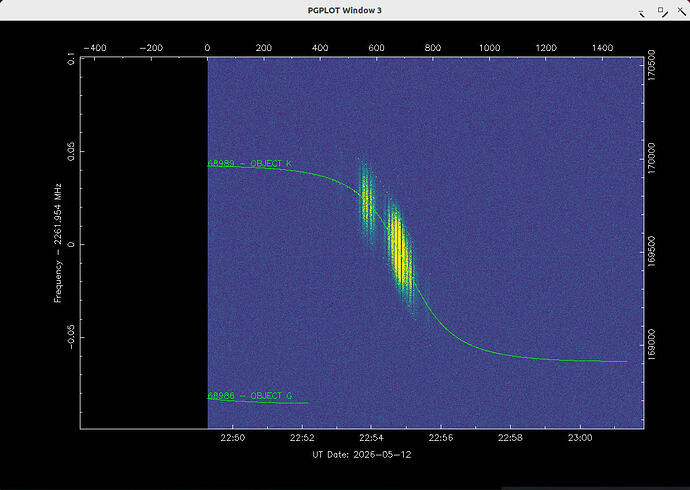

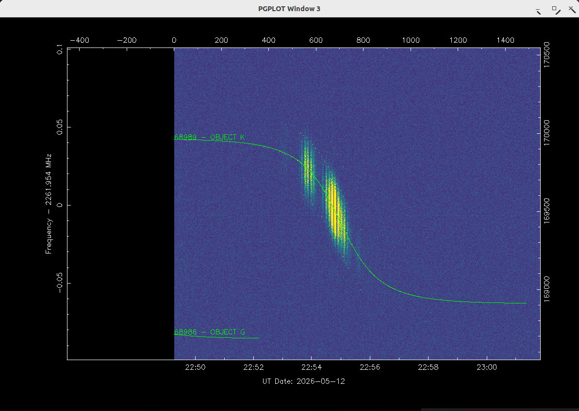

68989 Object K 2261.944 MHz
and one day later
Excellent! About a minute away from the original BusanSat TLE.
By chance do you have an audio or I/Q recording? Those marks look strong enough to decode.
No IQ sorry. It’s PE0SAT’s message which triggered me with a known frequency on which I could check the CAS500-2 payloads pass times which made it more comfortable to check in and see what was around.
both not match

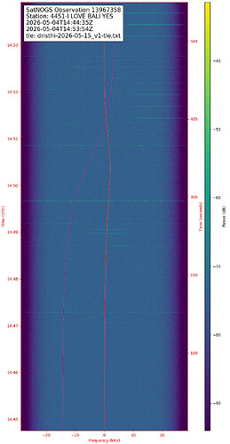

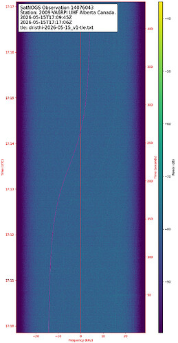

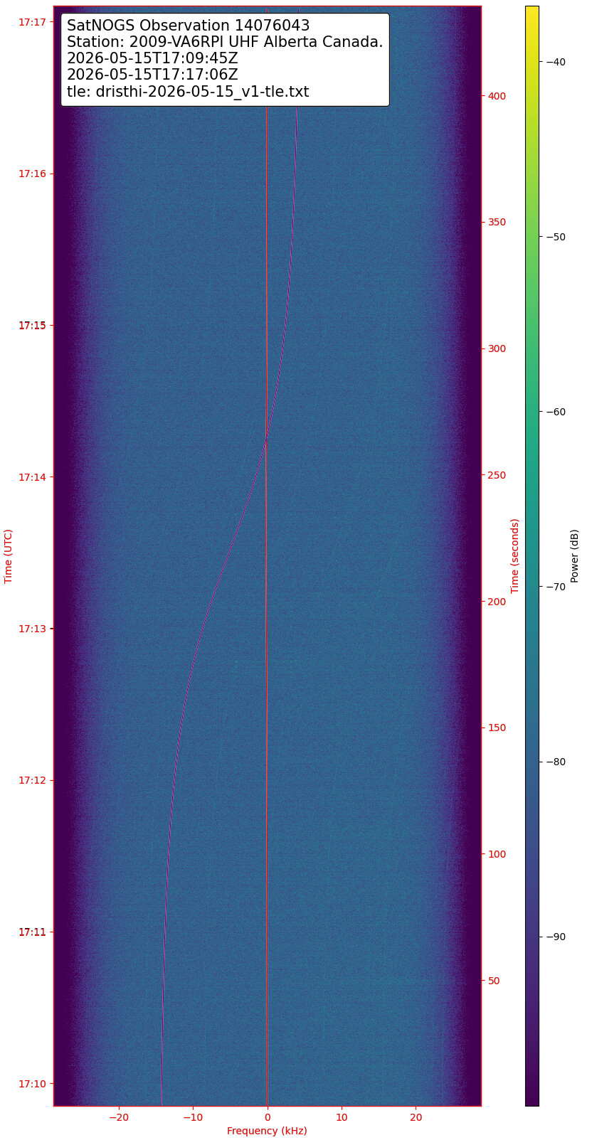

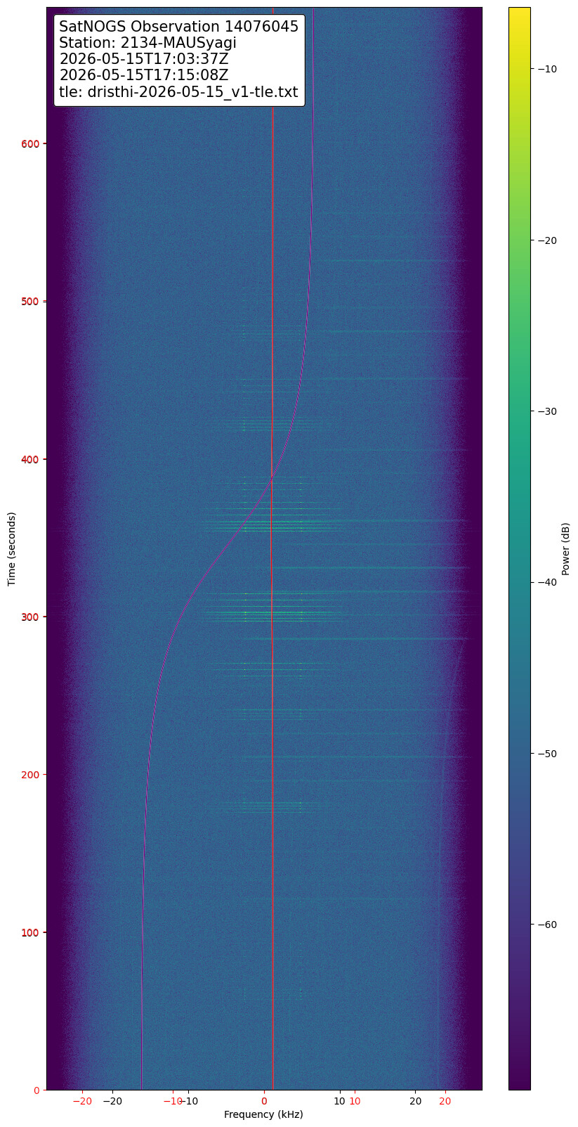

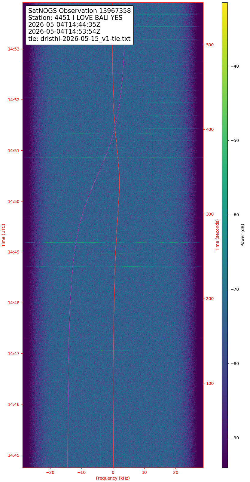

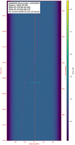

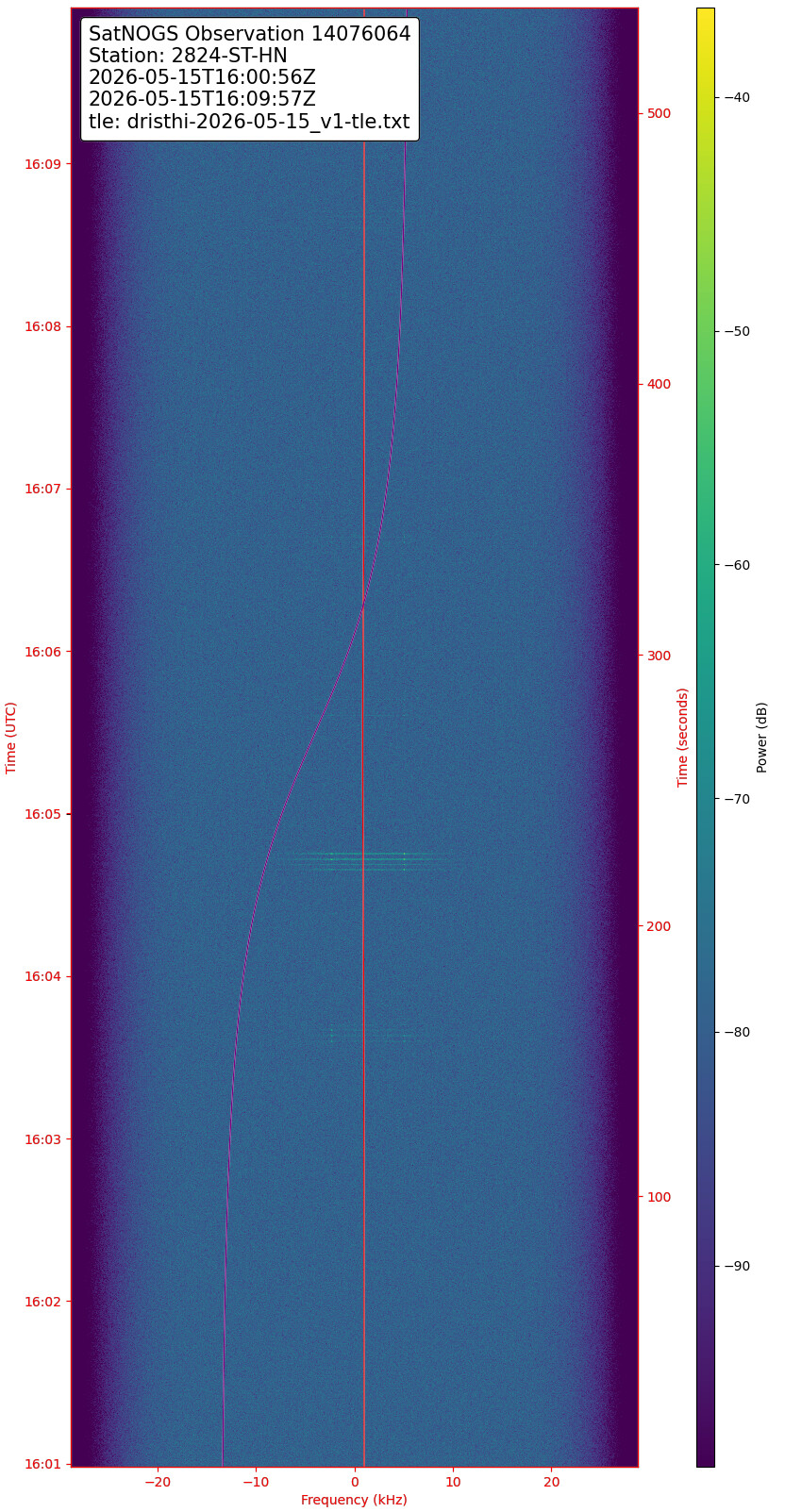

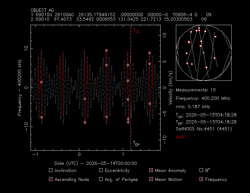

i try create this new TLE based on latest obs on satno:
OBJECT AG
1 69010U 26100AG  26135.17949152  .00000000  00000-0  70906-4 0    09
2 69010  97.4073  33.5492 0006553 131.0425 221.7213 15.20300503    06
# 20260513.14-20260515.61, 15 measurements, 0.187 kHz rms
# 14041253_14048973_14056636_14056640_14069139.dat (total: 5 obs) (duration: 59 hours) (magic key: 256sfefef)
# generated using: https://github.com/hobisatelit/satno2tle (v0.02)
dristhi-2026-05-15_v1-tle.txt (386 Bytes)
Drishti gives 4 packets each 120sec 14076103 is matching the same

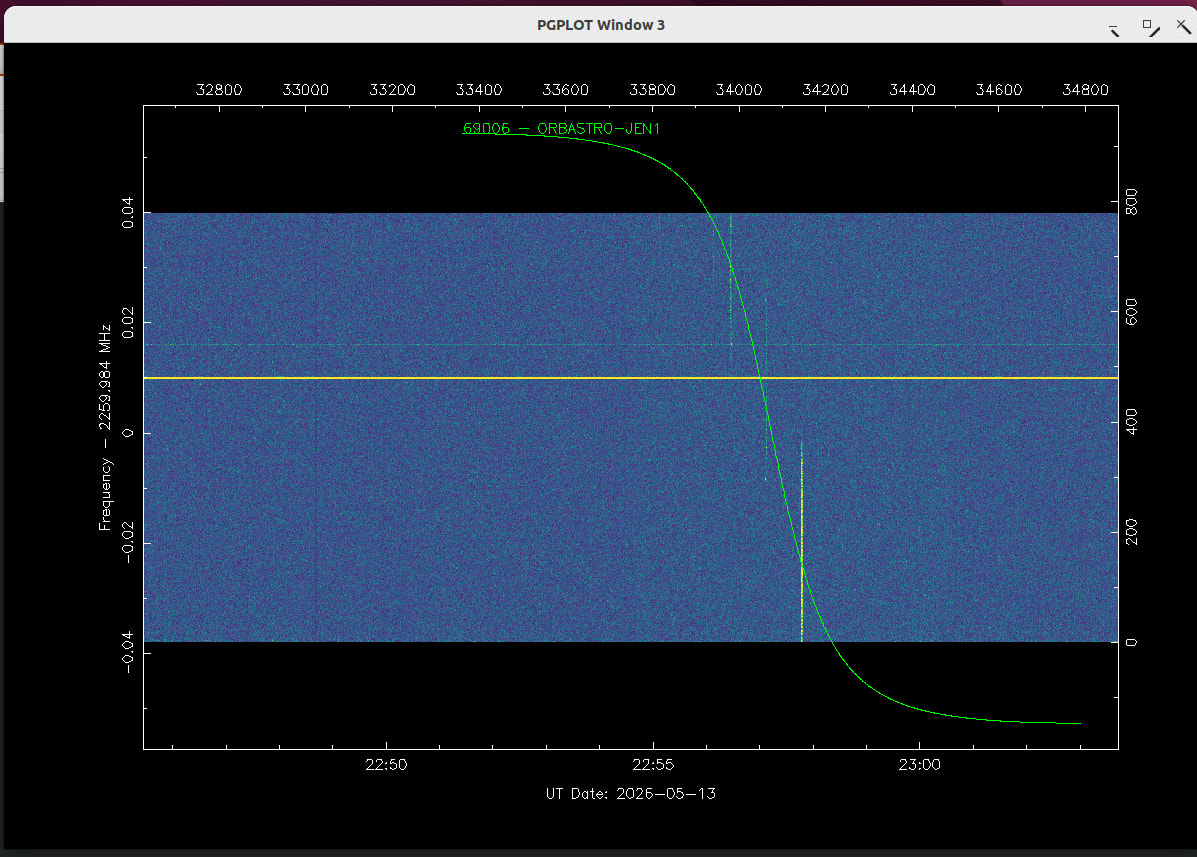

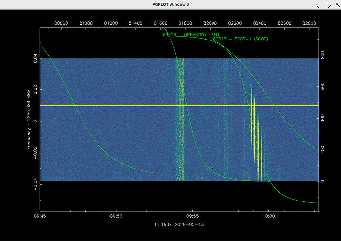

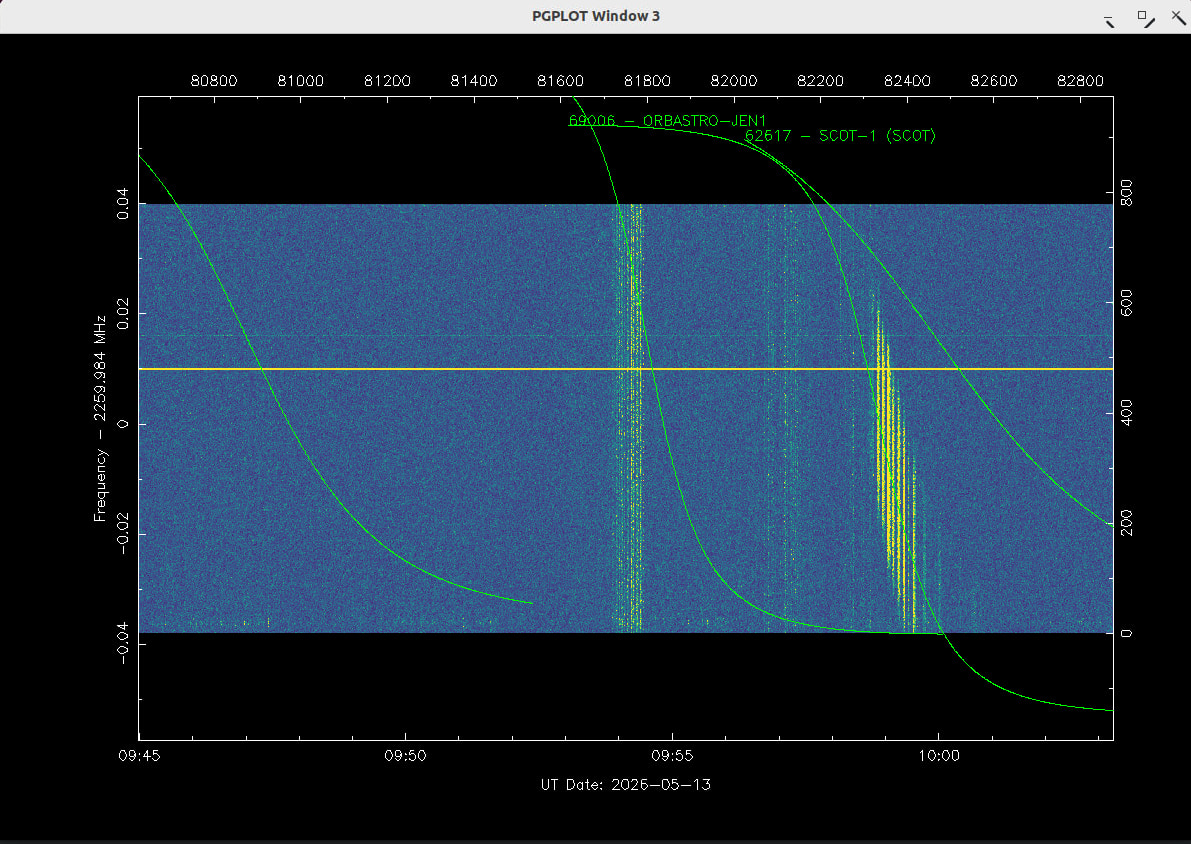

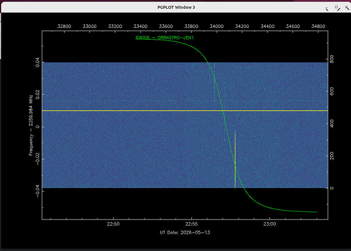

I have JEN-1 , “Orbastro JEN-1” 69006 on 2259.985 MHz
2 matching passes.
I’ve changed Drishti in DB to follow 69019 as requested.
