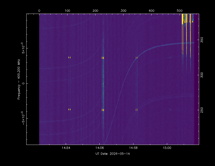

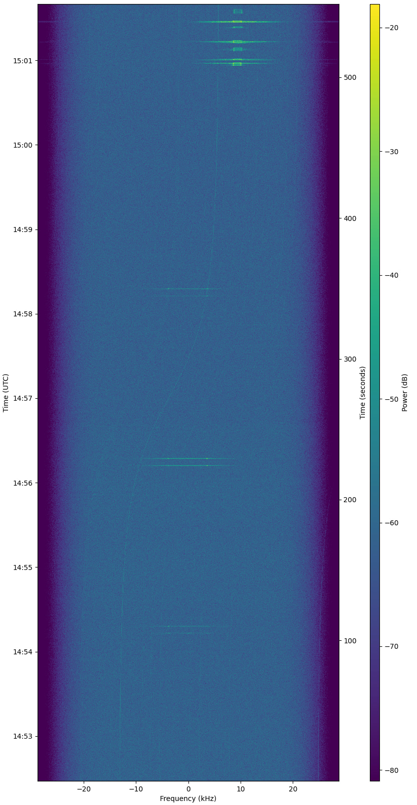

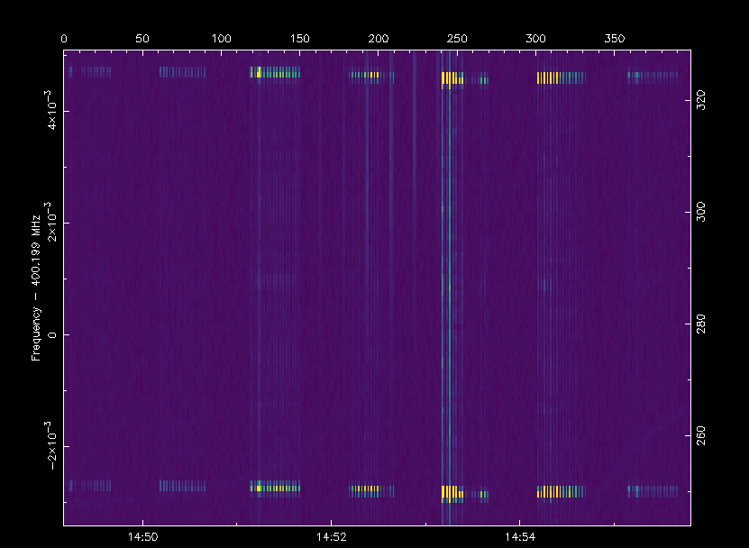

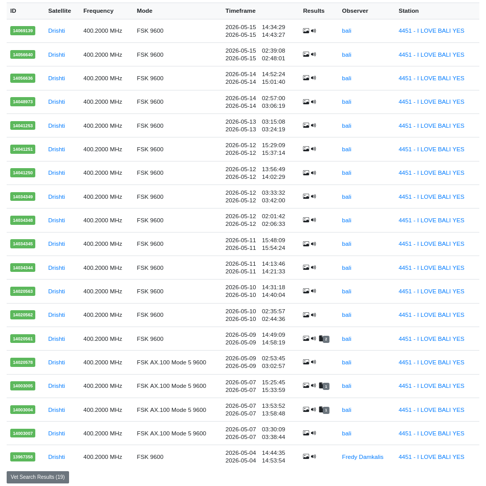

based on iq raw from this observations
the signal in strf should be like this (with doppler adjusted)
with interval 120 seconds:
or when burst, based on this observation (less than 120 seconds)

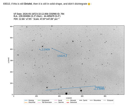

latest optical observation 2026-05-16 by @EelkeVisser , from this post

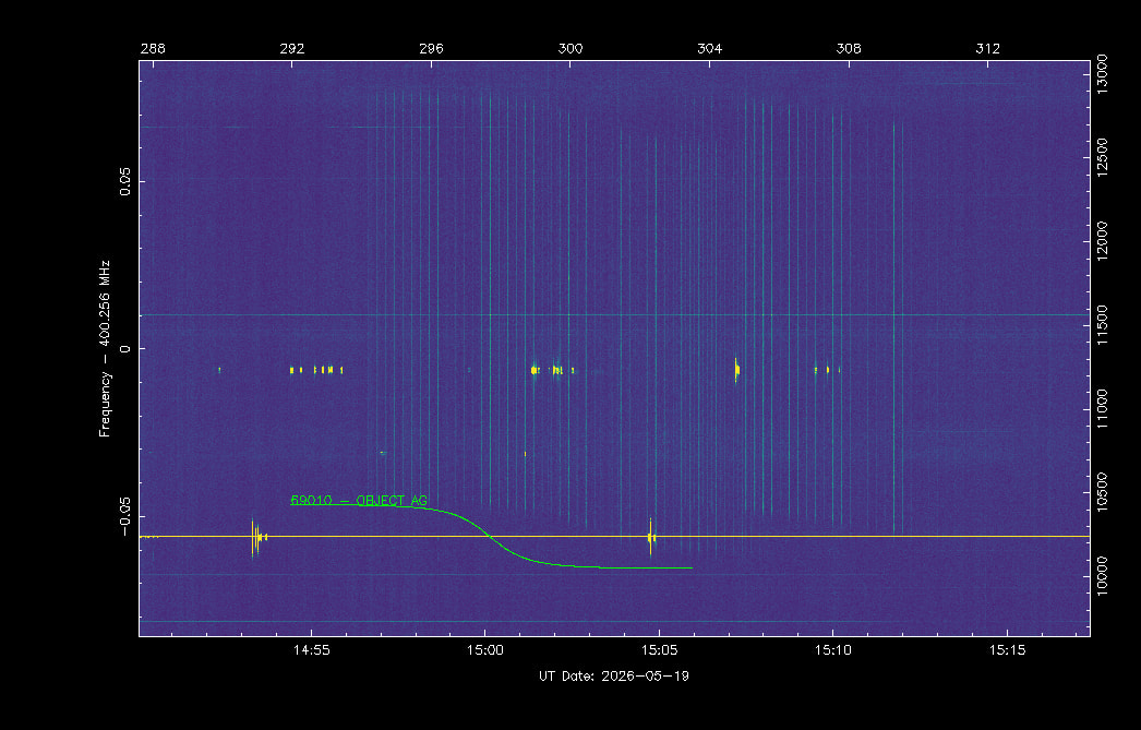

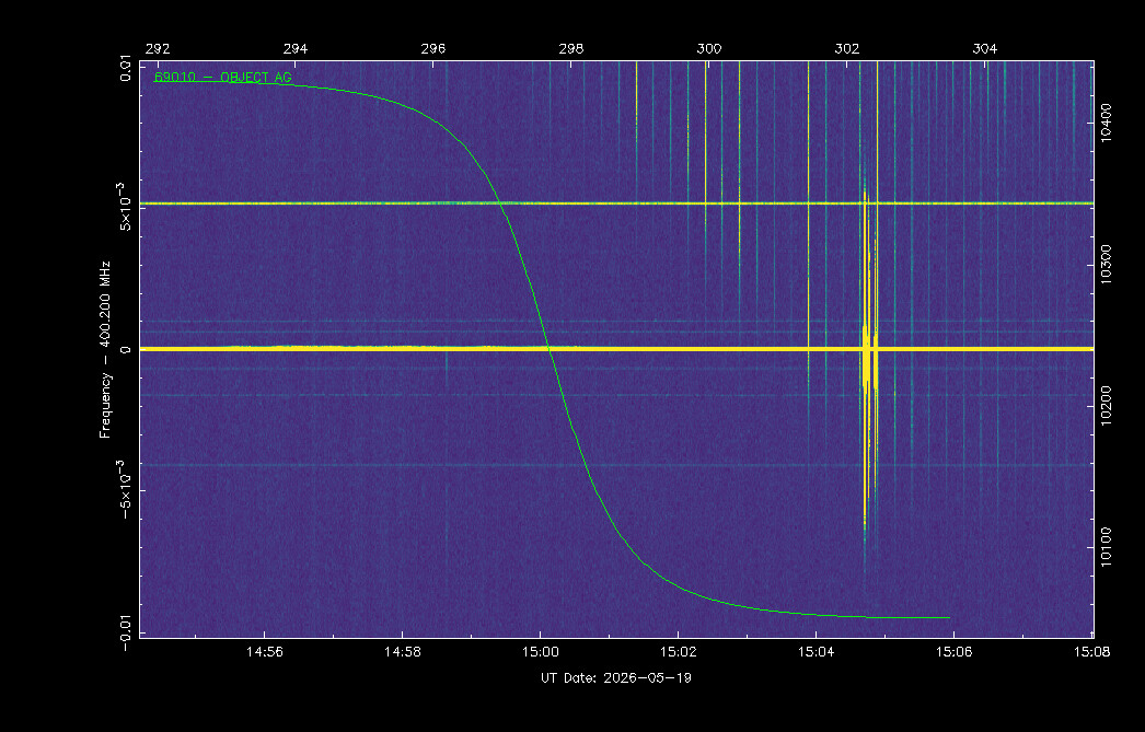

running strf-capture by @PE0SAT on station-4365, using 1/4 ground plane noob antenna. hopefully will got the signals…
$ ./strf-capture.sh 4 400.200 48h strf-data
# Using SDR device /usr/local/bin/rtl_sdr
# Base        : strf-data
# Directory   : strf-data/400.200/2026-05-19T06:14:28+00:00
# Duration    : 48h
# Frequency   : 400.200e6 Hz
# Timestamp   : 2026-05-19T06:14:28+00:00
# Sample rate : 1.024e6
# Starting SDR and RFFFT for a duration of 48h
Filename: stdin
Frequency: 400.200000 MHz
Bandwidth: 1.024000 MHz
Sampling time: 0.976562 us
Number of channels: 20480
Channel size: 50.000000 Hz
Integration time: 1.000000 s
Number of averaged spectra: 50
Number of subints per file: 60
Starting index: 0
Found 3 device(s):
  0:  RTLSDRBlog, Blog V4, SN: 1004451
  1:  Realtek, RTL2838UHIDIR, SN: 1004330
  2:  Realtek, RTL2838UHIDIR, SN: 1004365
Using device 2: Generic RTL2832U OEM
Found Rafael Micro R820T tuner
[R82XX] PLL not locked!
Sampling at 1024000 S/s.
Tuned to 400200000 Hz.
Tuner gain set to 44.50 dB.
Tuner error set to 25 ppm.
Reading samples in async mode...

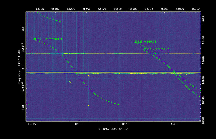

Had strf till the 13th of may, transmitter and frequency 400.200 all ok.

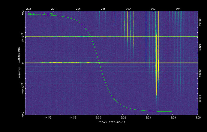

Started new strf yesterday, no traces of 69010 , neither within + and - 200 kHz.
same with this obs
no traces :frowning:

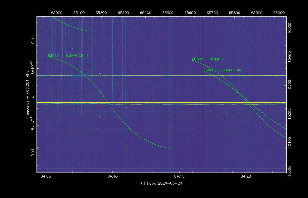

zoom out:
note: the big wide signal above dristhi is from tianqi (lora signal)
I switched strf to 2240 MHz to check if there is a transmitter active over there. But only 20 minutes ago so this would take some time.

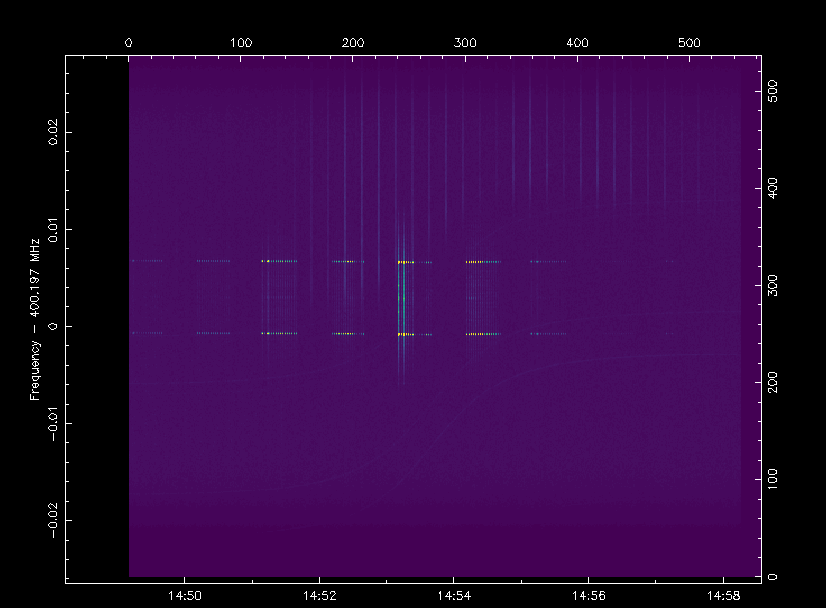

i think i found the signal trace around 04:06 utc today.. wait…
im wrong. this not object AG / dristhi sat. but elevation-1. sorry
sample waterfall from elevation-1 that seen almost same with drishti, but not..
taken from this obs
yeah i also noticed the same, bad luck nothing from object AG

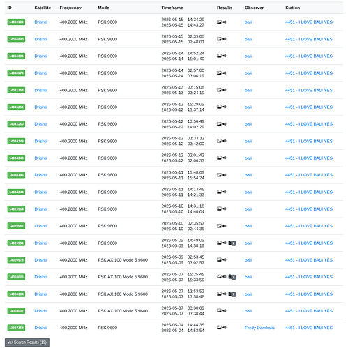

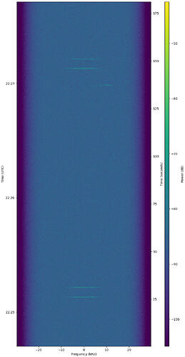

all RAW IQ (rawint16, signed integer) file of obersavations below (total: 19),
available here

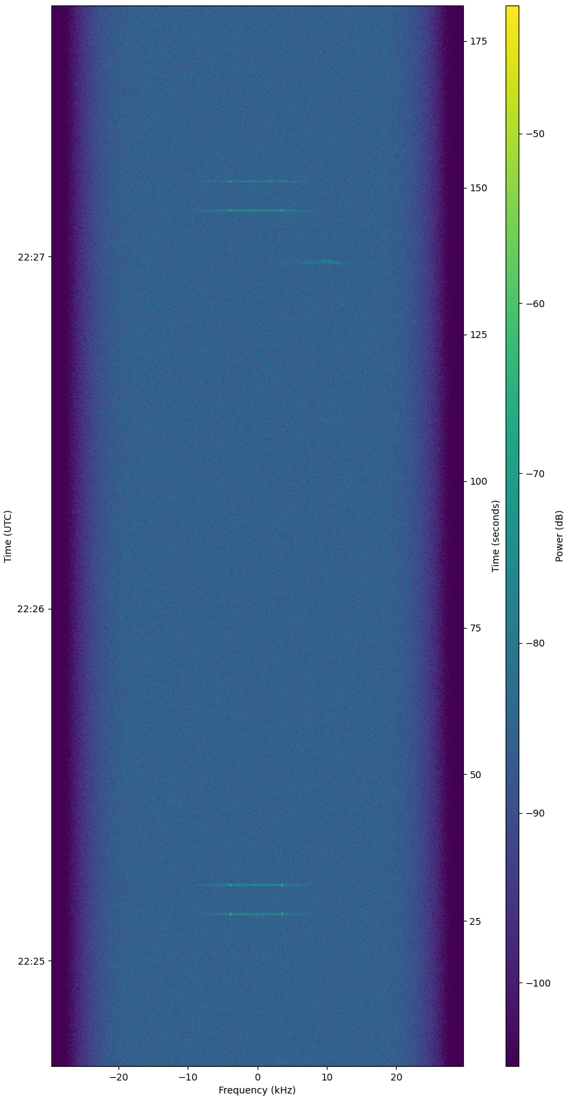

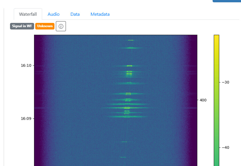

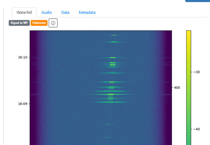

what does this kind of signal mean here?
You might look here as well Observation 13966841: Drishti (98313) - #12 by N6RFM
Not 100% sure if the AI solution is correct as the framing appears to be encrypted.

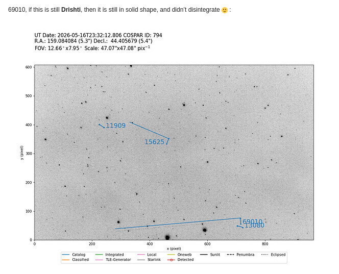

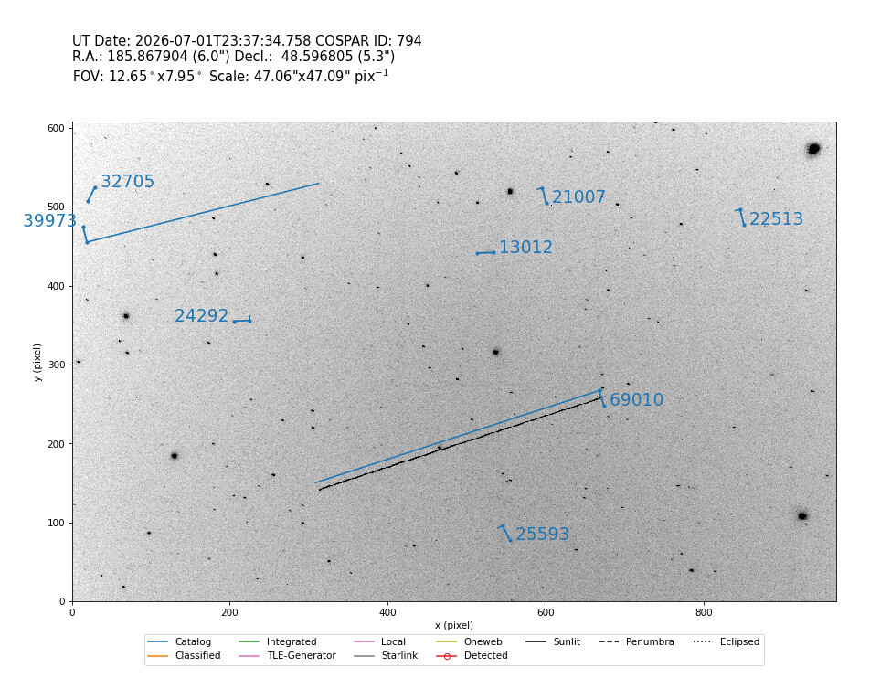

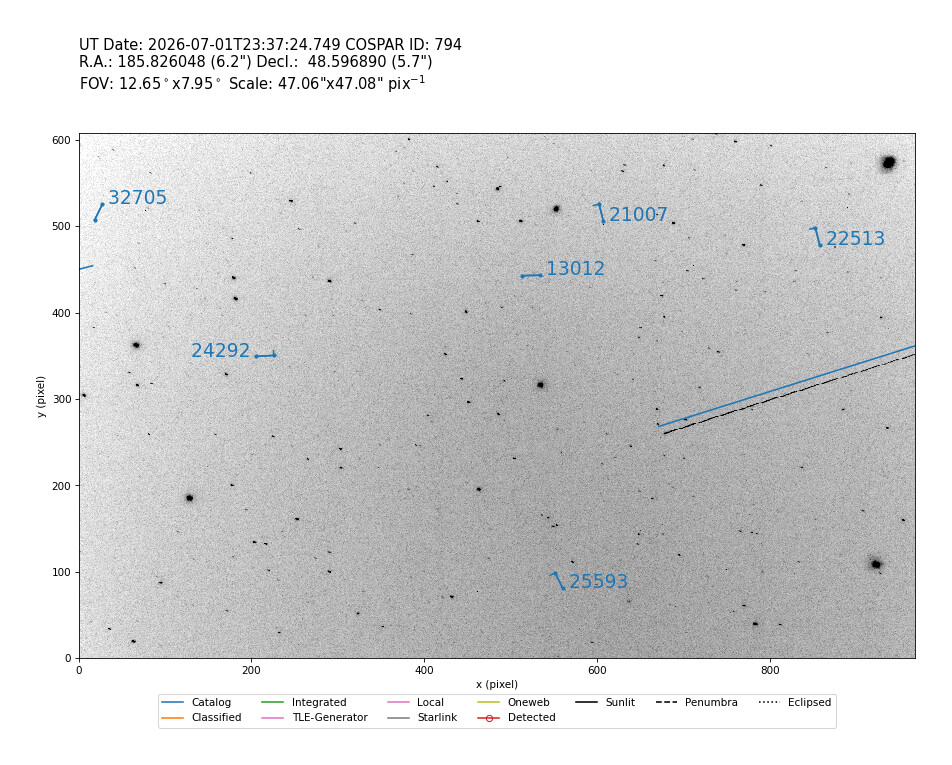

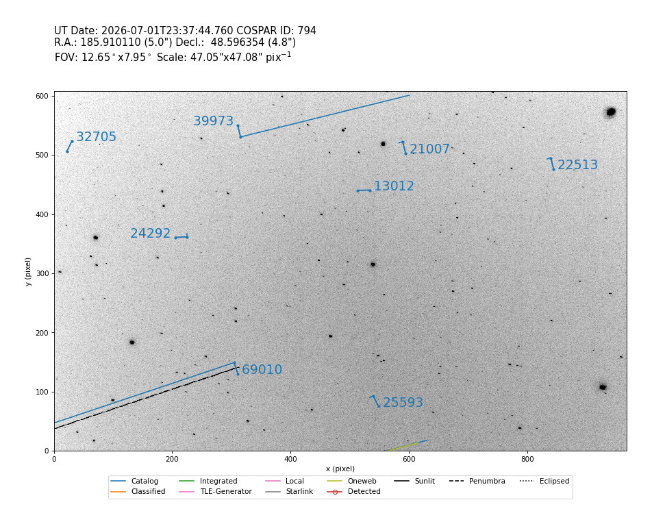

@gigasignal asked for an optical observation:
Measurements show accurate TLE.
69010 26 100AG  0794 G 20260701233730548 17 25 1157397+495801 37 S |  0.00414 deg    0.0814 sec   0.746 day, 883.3 km
69010 26 100AG  0794 G 20260701233739707 17 25 1219900+472351 37 S |  0.00267 deg    0.0767 sec   0.746 day, 868.2 km
69010 26 100AG  0794 F 20260701233748959 17 25 1240810+442599 37 S |  0.00451 deg    0.0836 sec   0.746 day, 858.2 km
@gigasignal QSL?
@dvdiyen I’m not from Drishti team but yeah I’m actively following the stats, and there no confirmation from there side @bali.
@EelkeVisser thanks for the optical Observations it help me to document.
@gigasignal noted
