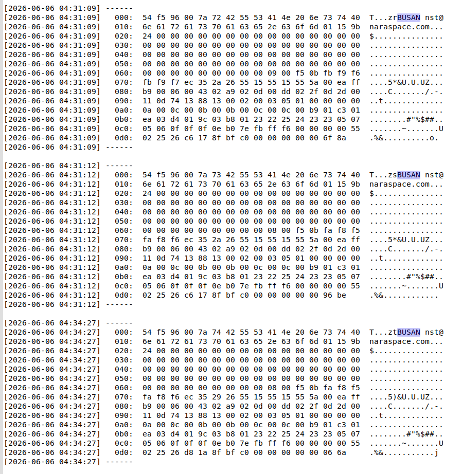

Almost didn’t bother with today’s BusanSat pass but even at a max elevation lower than is ideal for my location, the strongest 38k4 S-Band downlink I have seen from this satellite thus far!
https://x.com/scott23192/status/2060407218382479711
… Oh, I did email the address in the payload but no reply (so far).

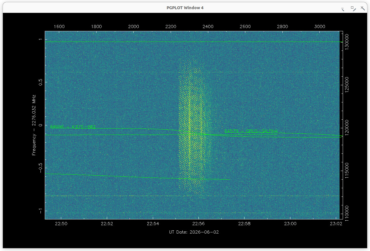

68996 ICEYE-X82 on 2276 MHz

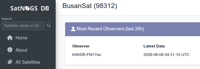

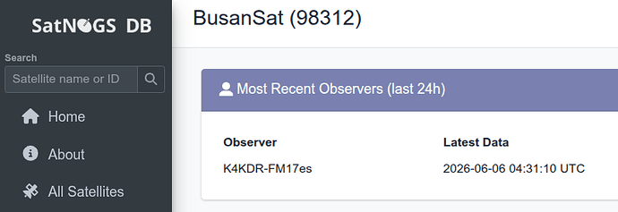

After several nights of no S-Band downlinks from BusanSat, it was great to see those 38k4 packets again!
… at a max EL of only 57°, I didn’t know if there would be enough SNR to decode anything, but a few were just strong enough.
… I never got a reply from the email address in the payload body, but at least I tried to make contact. Still can’t believe we’re decoding frames from an S-Band downlink; I never really expected that to happen (since S-Band signals are often weaker and/or the modulation is beyond my abilities)!

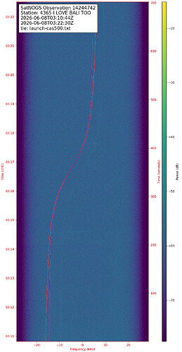

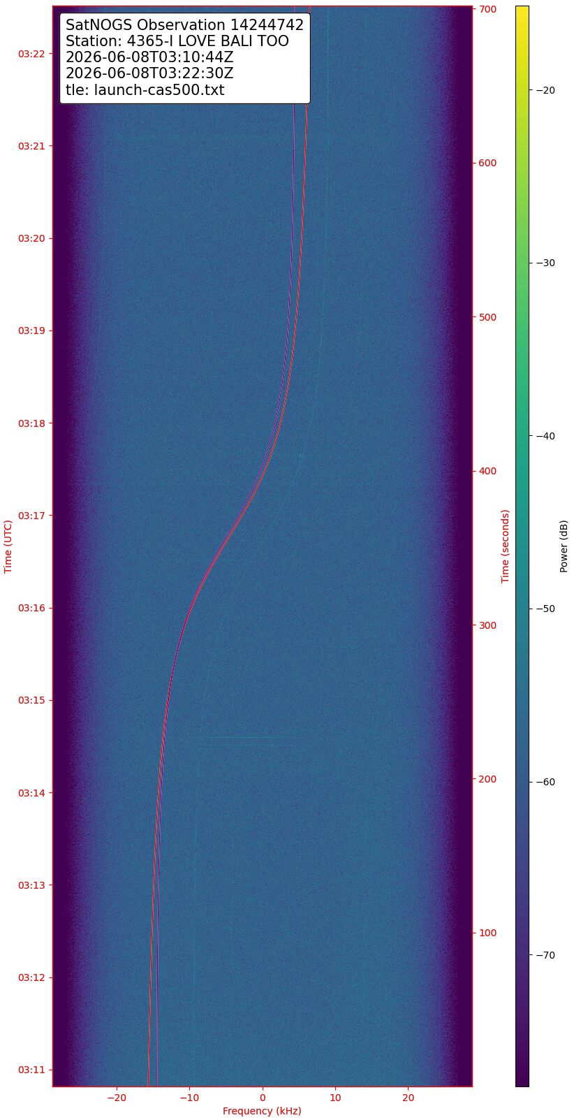

launch-cas500.txt (1.9 KB)
sites.txt (1.2 KB)
14244742.dat (280 Bytes)
14244555.dat (140 Bytes)

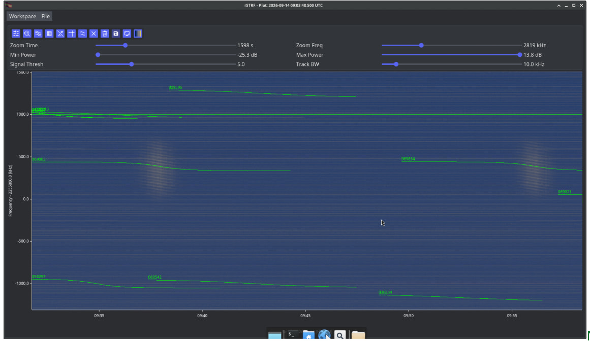

68992 YAM-16 appears to be from this launch too
Frequency to be decided, 2255.388 but at 22 MSPS it can be 22 MHz up or down too.

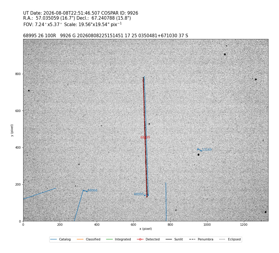

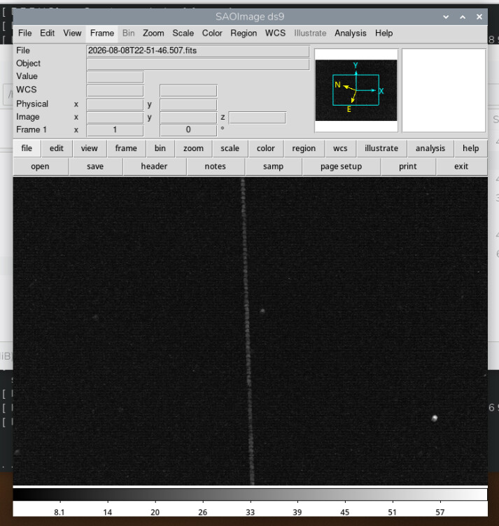

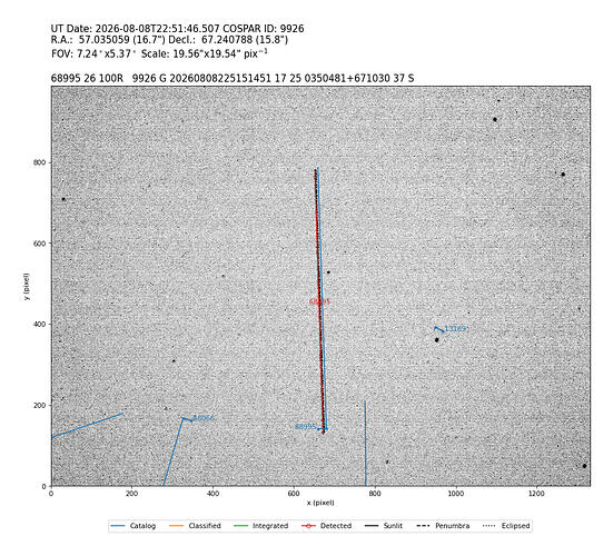

68995 ICEYE-X78 visual observation :slight_smile:
