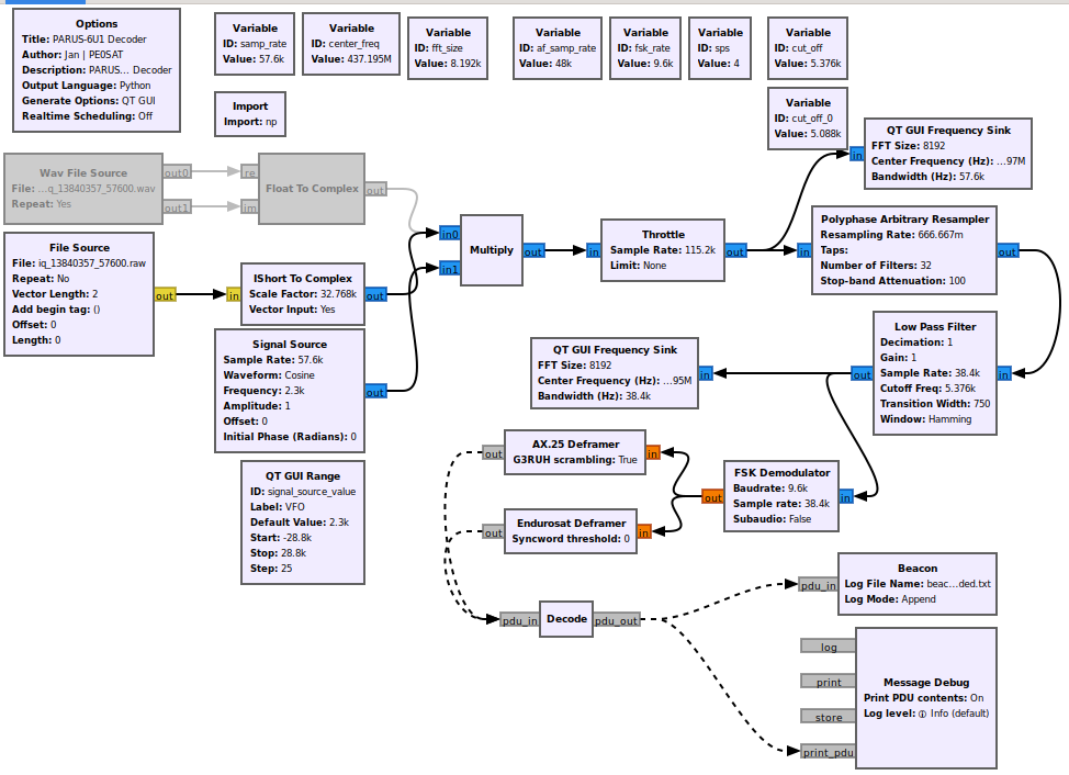

install PARUS_6U1
create grc flowgraph using gnuradio-companion:
contoh.grc.txt (2.1 KB)
run & wow it work (but i think still complicated for noobs)

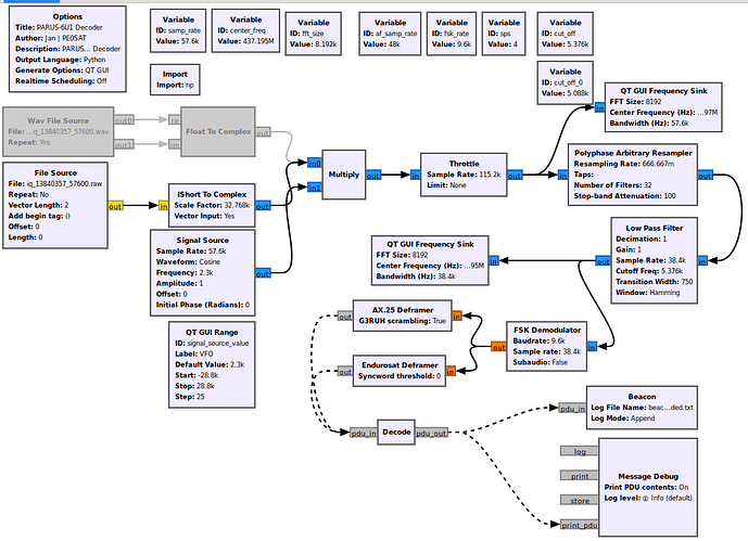

Thanks for the information, I created the following GNURadio flow graph
Producing:
>>> Classification: [ Unknown Beacon ] (Func ID: 4)
