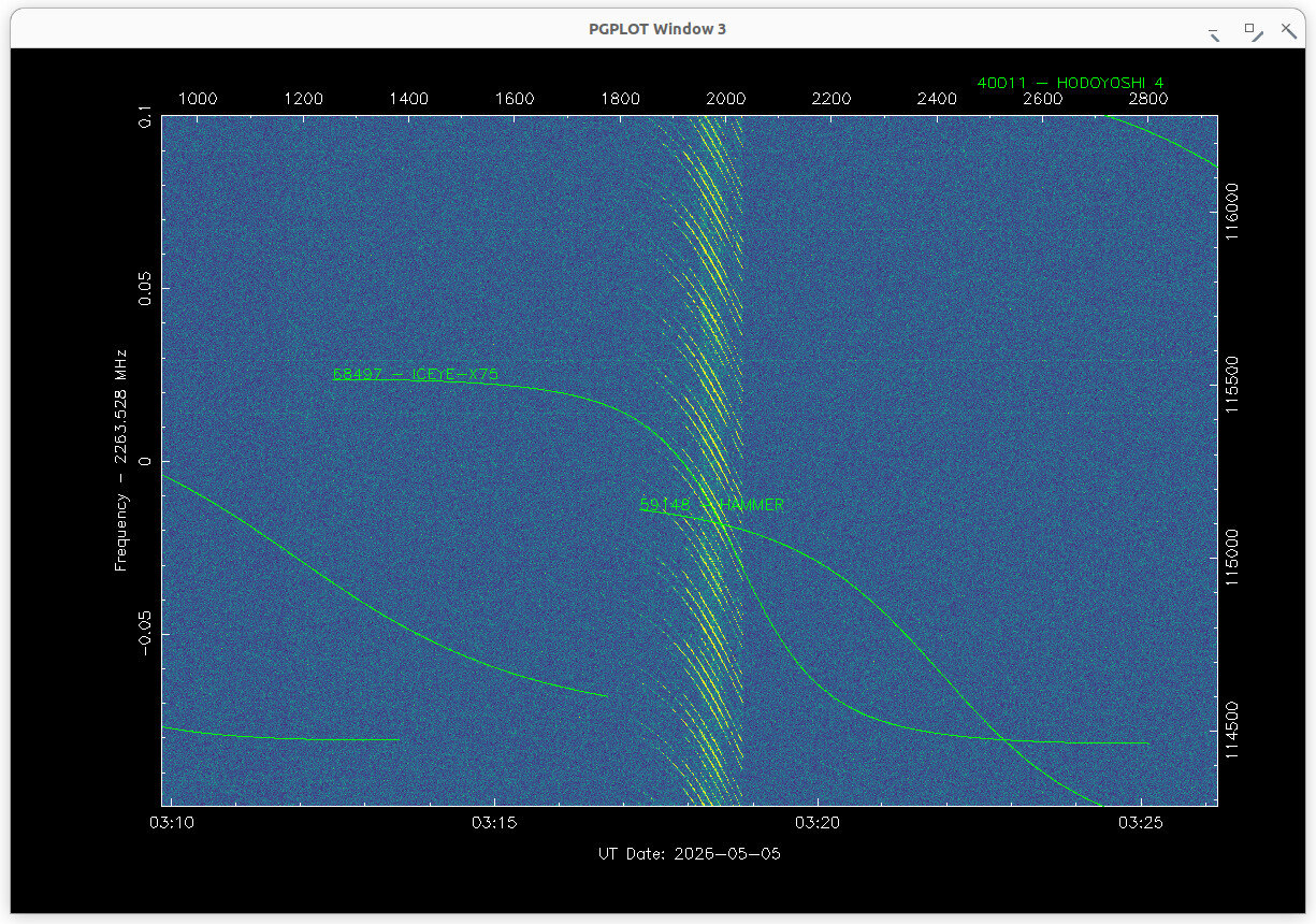

68497 Iceye-X75 2263.500

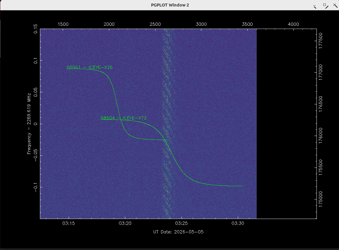

68504 Iceye-X72 2269.600

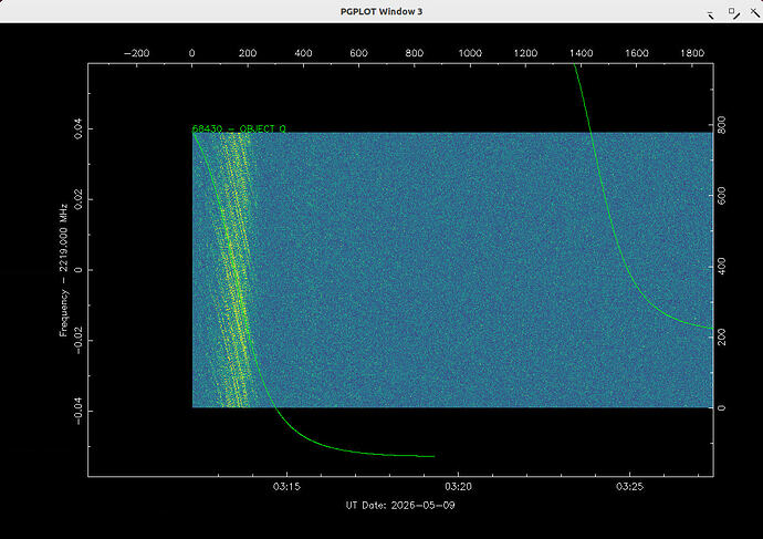

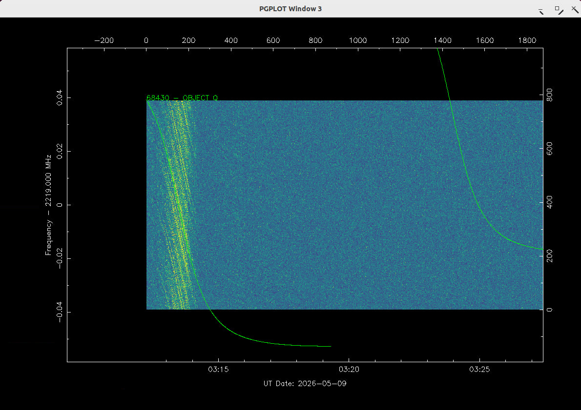

68430 Object Q confirmed at 2219 MHz

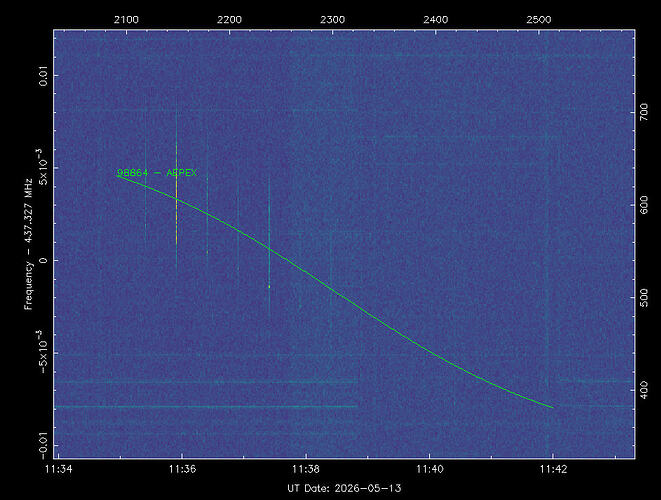

AEPEX TLE
Still a pretty good match for the current TLE data used.
AEPEX
1 98864U          26127.14605859  .00004986  00000+0  24857-3 0  9996
2 98864  97.4503  86.1993 0002641 138.9030 221.2403 15.17988152  5712

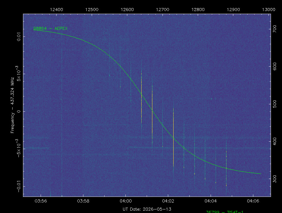

AEPEX TLE Update.
Only based on Europe passes so needs correction.
AEPEX
1 98864U          26133.54973662  .00000000  00000-0 -10326+0 0    07
2 98864  97.4503  92.3722 0002641 138.9030 275.5967 15.17550114    08
# 20260513.10-20260513.55, 28 measurements, 0.277 kHz rms

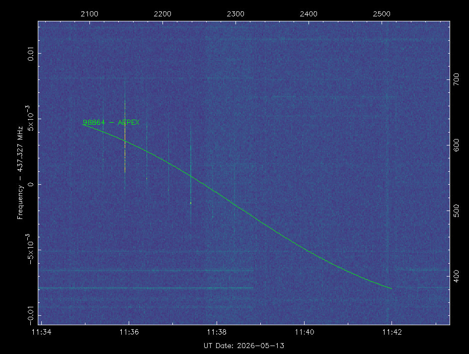

AEPEX TLE, some first B* drag corrections based on other 6U cubesat values.
AEPEX
1 98864U          26133.61543589  .00000000  00000-0  10386-3 0    05
2 98864  97.4503  92.4231 0002641 138.9030 274.6200 15.18593247    09
# 20260513.10-20260513.62, 33 measurements, 0.295 kHz rms
Keep making adjustments, Jan! With each update this afternoon’s pass gets higher in my sky!! :slight_smile: (Thanks for all the great work)

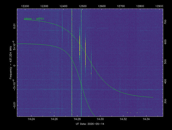

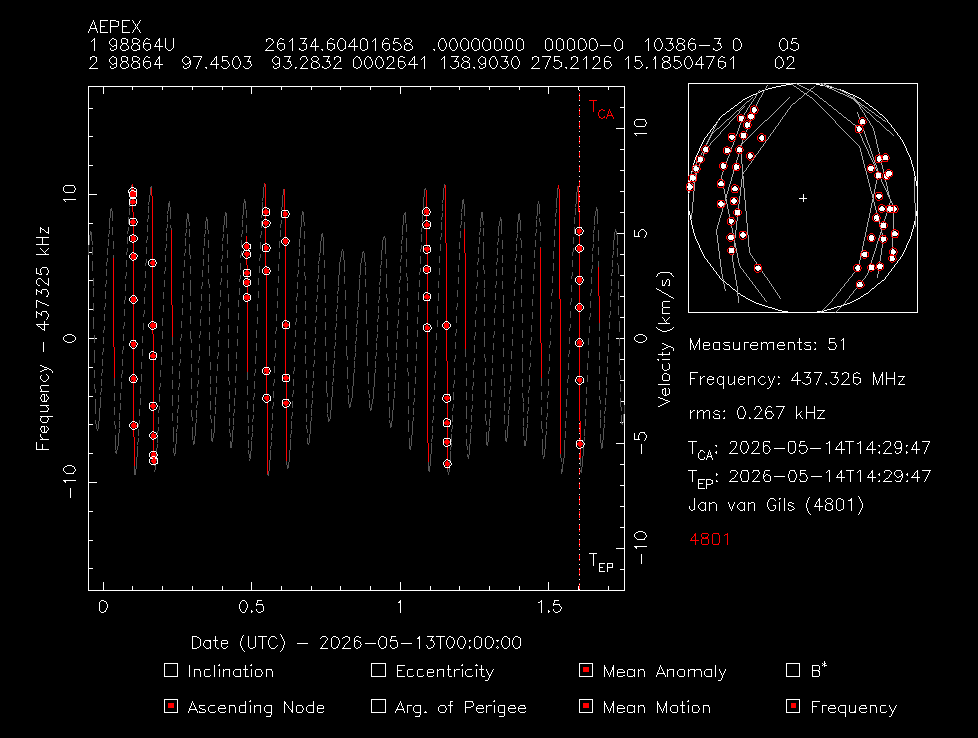

AEPEX TLE Update
AEPEX
1 98864U          26134.60401658  .00000000  00000-0  10386-3 0    05
2 98864  97.4503  93.2832 0002641 138.9030 275.2126 15.18504761    02
# 20260513.10-20260514.61, 51 measurements, 0.267 kHz rms

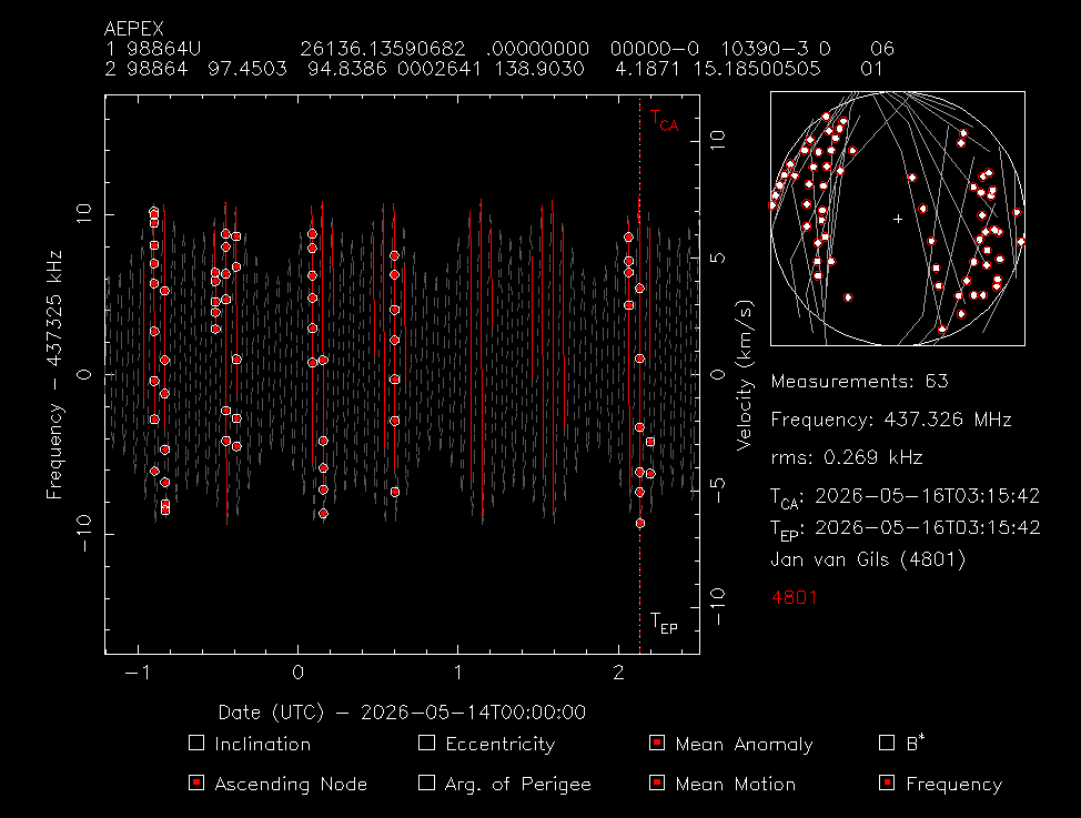

AEPEX TLE Update:
AEPEX

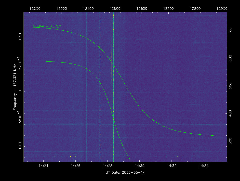

Thanks @PE0SAT we’ve been using your strf refined TLEs for AEPEX over the last several days with success. Space-track just issued NORAD ID 68506 for AEPEX. We’ll keep an eye on both IDs over the next 24 hours.
Thanks for the update, let me check this object with what I have.

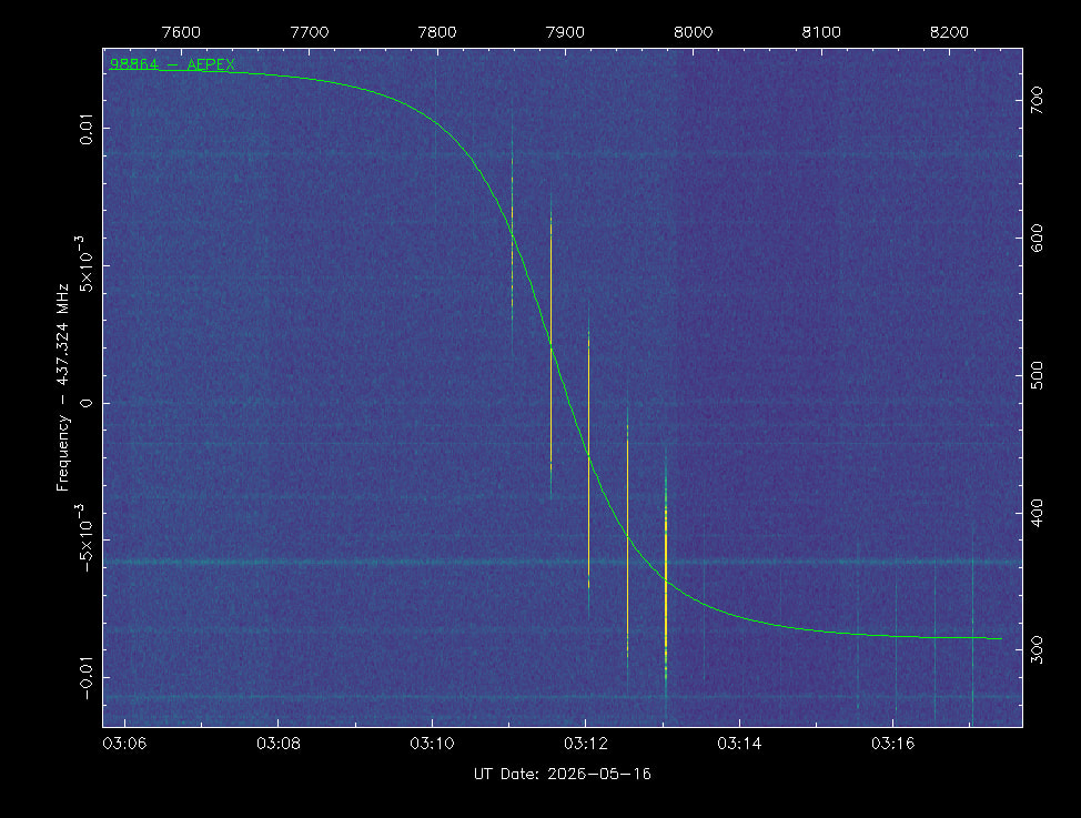

AEPEX TLE Update
A good match with object 68506, I also have the impression the RF gain is increased, strong signals. @satcolintel5
