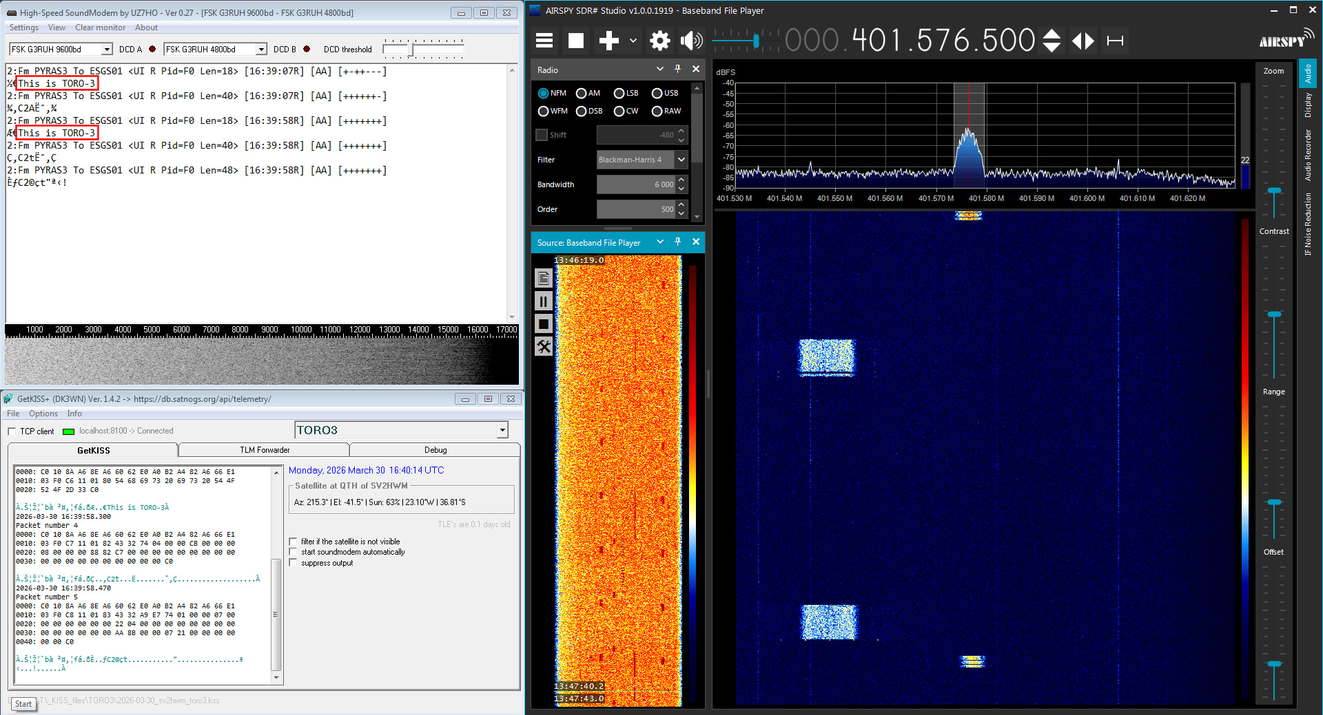

13:46 UTC - TORO-3 rx on 401.580 MHz.

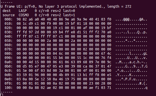

2026-03-30 13:47:04 | len: 272 | 9882A6A0404040869EA69A9E404103F0081CD9C100F9000019BF01180000000000000000000019C1000100AF000019BFFFFD972D000069B4FFE8D151FFF270A0FFFF07C1FFFF07C1000000000000000000000000002A0000002A0000000000000000000000000000000000000000000000000000000000000000000200000000000000000000046C000000000000674C00000000000155B60000551C000076F400004D150000066106630968097E009C08D505E7004705E3003908CA06370147055E006F038D003A0001004F00010000035901960000004B090113B1FFF800E5030A005E12500A4619750000000000000100010100000A02000000002300280000000A8802AE020000000000AEF10371
2026-03-30 13:47:34 | len: 272 | 9882A6A0404040869EA69A9E404103F0081CD9DF00F9000019DD01180000000000000000000019DF000100AF000019DDFFFE36160000C450FFE8A500FFF270A0FFFF07C1FFFF07C1000000000000000000000000002A0000002A0000000000000000000000000000000000000000000000000000000000000000000200000000000000000000046C000000000000675D00000000000155D50000551C000076F400004D15000006610662096E0981009C08D405E6004305E3003B08C906370155055E0072038D003B0001004F00010000035901B90000004B08FF13BEFFAE00D102F3006611E40BAC1A4C0000000000000100010100000A02000000002300280000000A8802AE0200000000008BAF8740
Source & destination AX.25 addresses look good!!
Thank you so much @K4KDR !
We were able to hand-decode this packet. COSMO is alive and well!
Thank you @sv2hwm !
Glad to hear it!

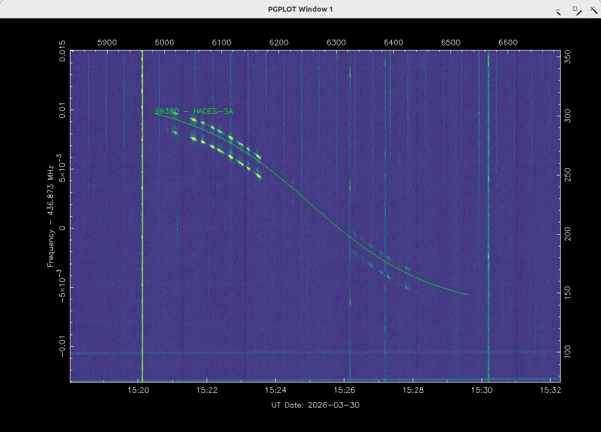

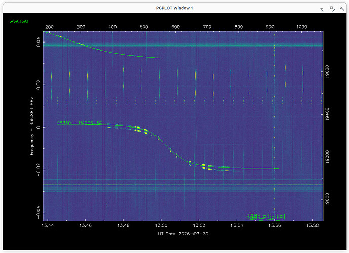

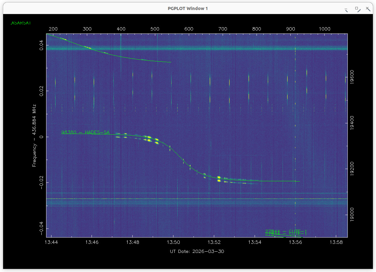

98380 HADES-SA 436.875 selected because matching frequency
and pass later:

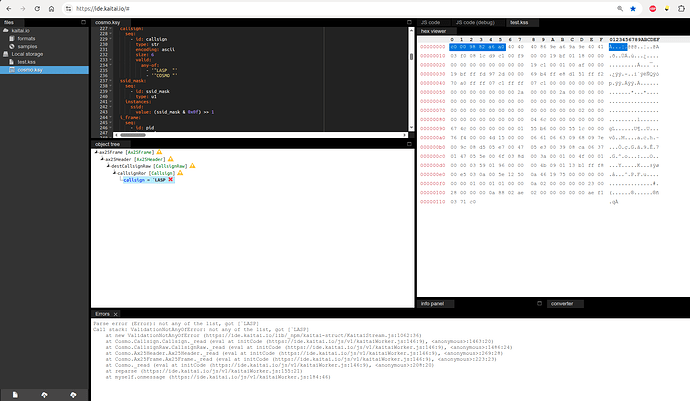

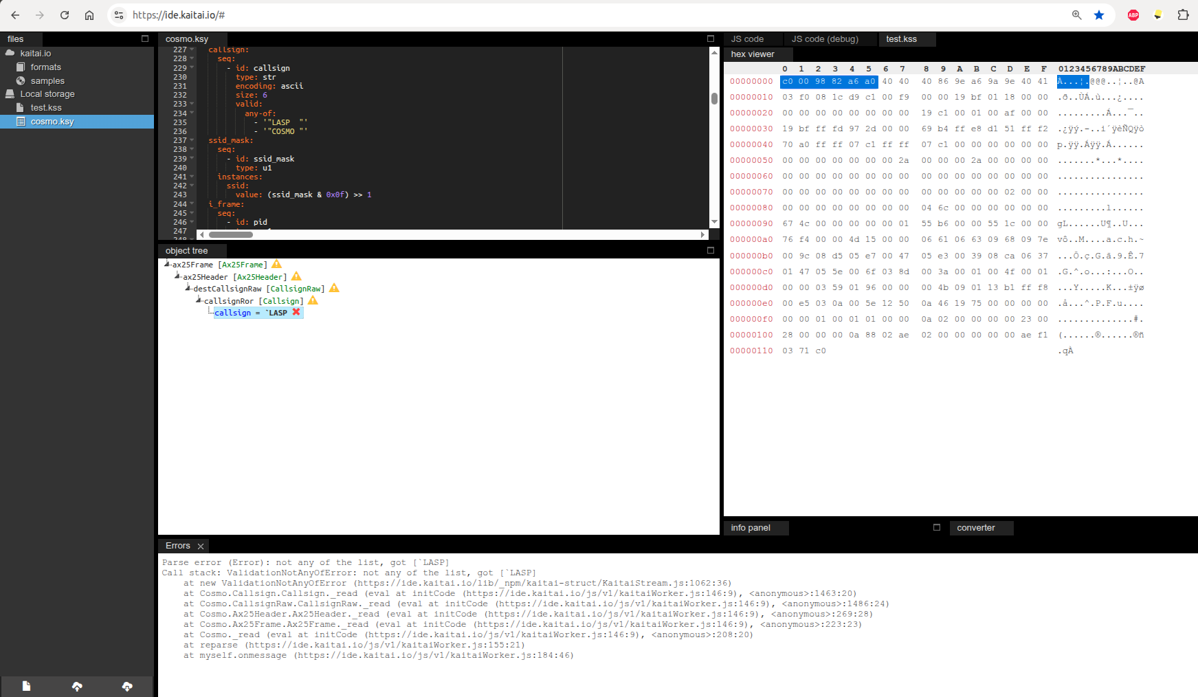

Very likely an error on my part, but FYI, I ‘borrowed’ your KSY file from that Merge Request to view a frame in the Kaitai Online Parser (ide.kaitai.io).
It’s not liking the KSY file, apparently… only reads one of the AX.25 addresses and then stops w/ an error.

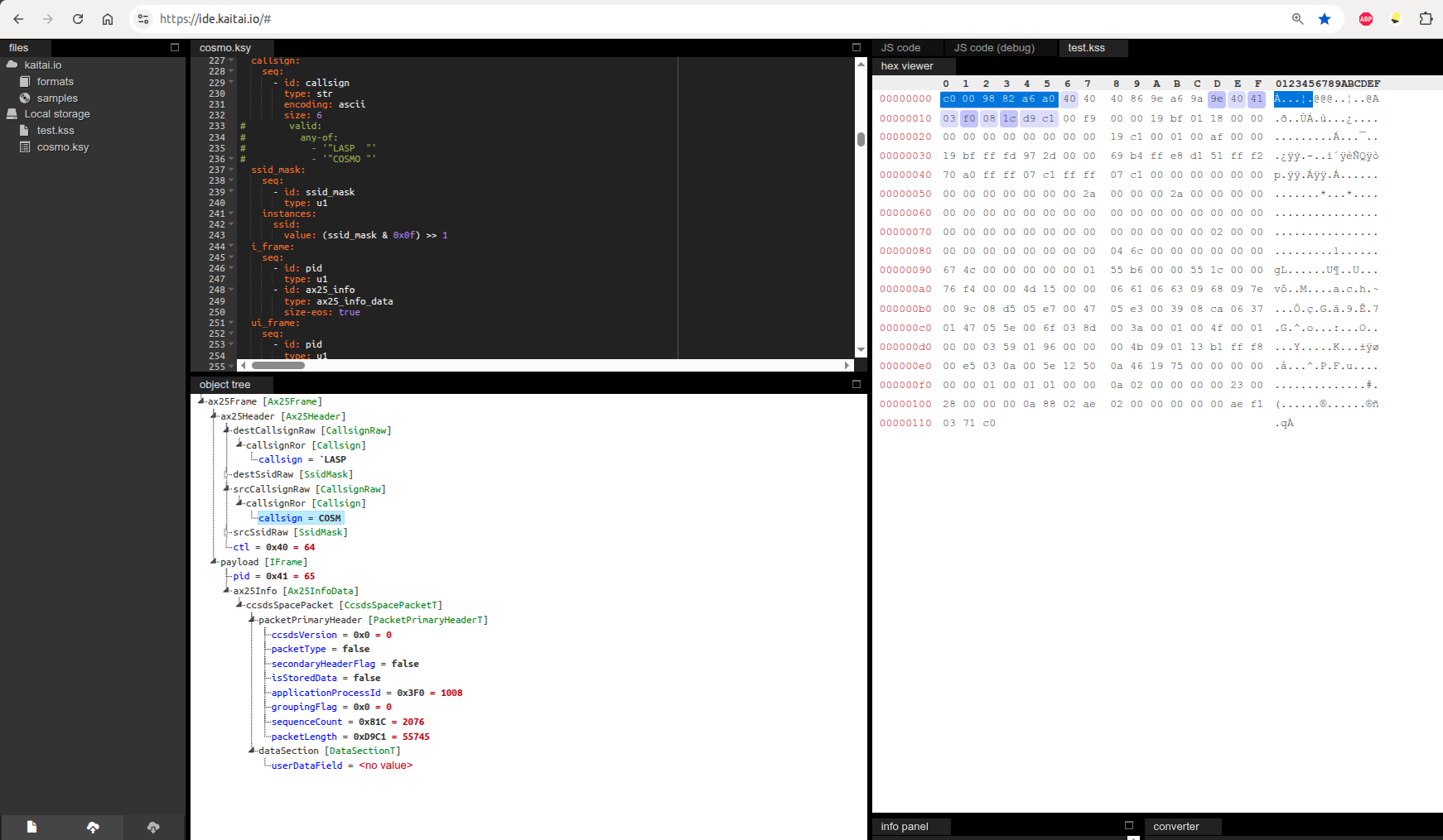

Follow-up:
Commented out the ‘valid’ checks in the KSY file and the Kaitai parser read the frame without errors!

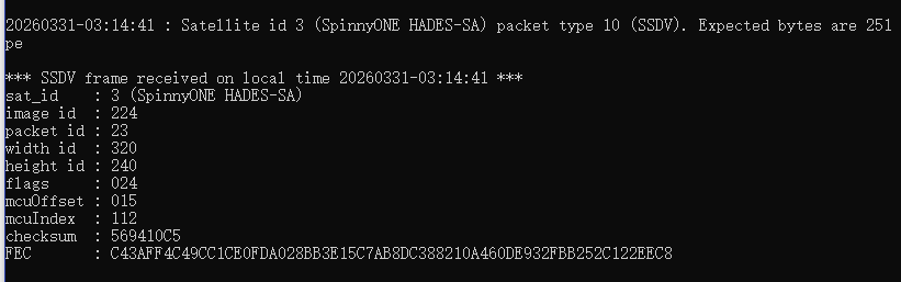

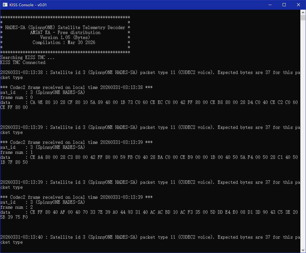

CODEC2 AND SSDV?
Excellent! How many SSDV frames did you get? Any partial image?
Signal QSB is severe, I cannot guarantee the SSDV image is intact.
I will open the SSDV software to check!
