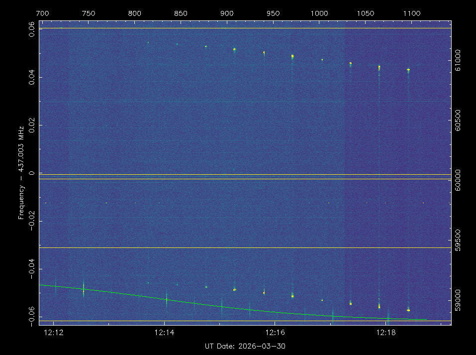

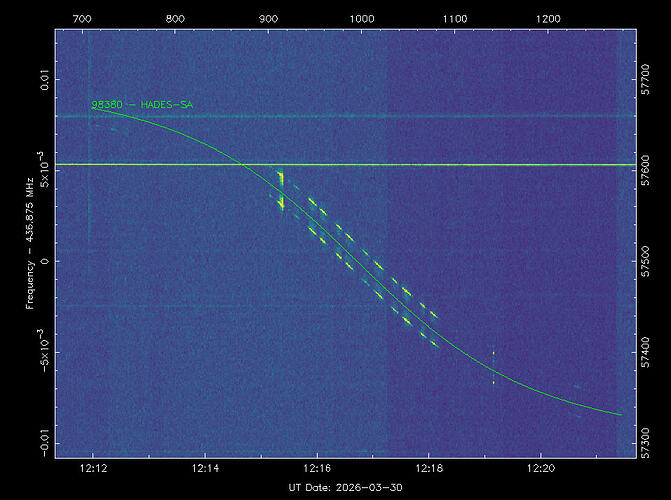

First T16 satellites in the Ham UHF range received

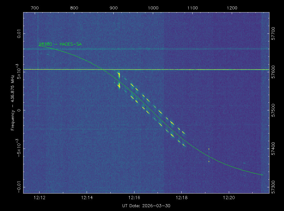

HADES-SA 436.875 MHz
Unknown 437.000 MHx very wide
From the first observations:
Vegafly-1, HADES-SA, Optisat seems to be alive.
Also I’ve created two unknown objects one for 437.000 MHz @PE0SAT discovered as well as one for 401.350 MHz visible in EMISAR observations:
Unknown 1 - T16
1 98346C 26066AB  26089.50170542 -.00003004  00000+0 -14893-3 0    08
2 98346  97.4431  49.1553 0000362 126.4920 237.1910 15.17819254    19

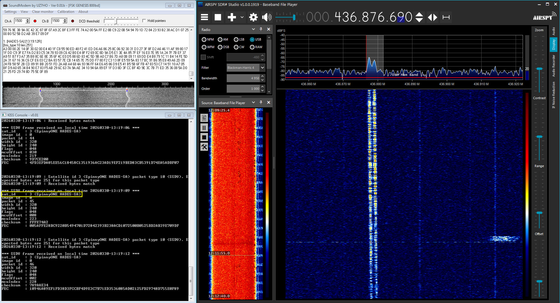

Regarding the issue of receiving a newly deployed satellite
Should I strictly follow the predicted events, or should I prepare well in advance to receive the signal?

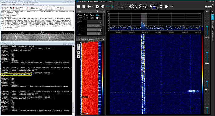

HADES-SA/SpinnyONE rx in :greece:
Given that the TLE are not fully accurate usually 2min before/after the pass you can start observing the satellite for the manual observation.
For the Network we follow a pre launch TLE, so we expect to see the satellite but not in a straight line as usually.
Okay, I will proceed with an unplanned manual observation of Hades-SA. Thank you for the message.
If all goes well, I will immediately record the IQ baseband and send it to AMSAT-EA.

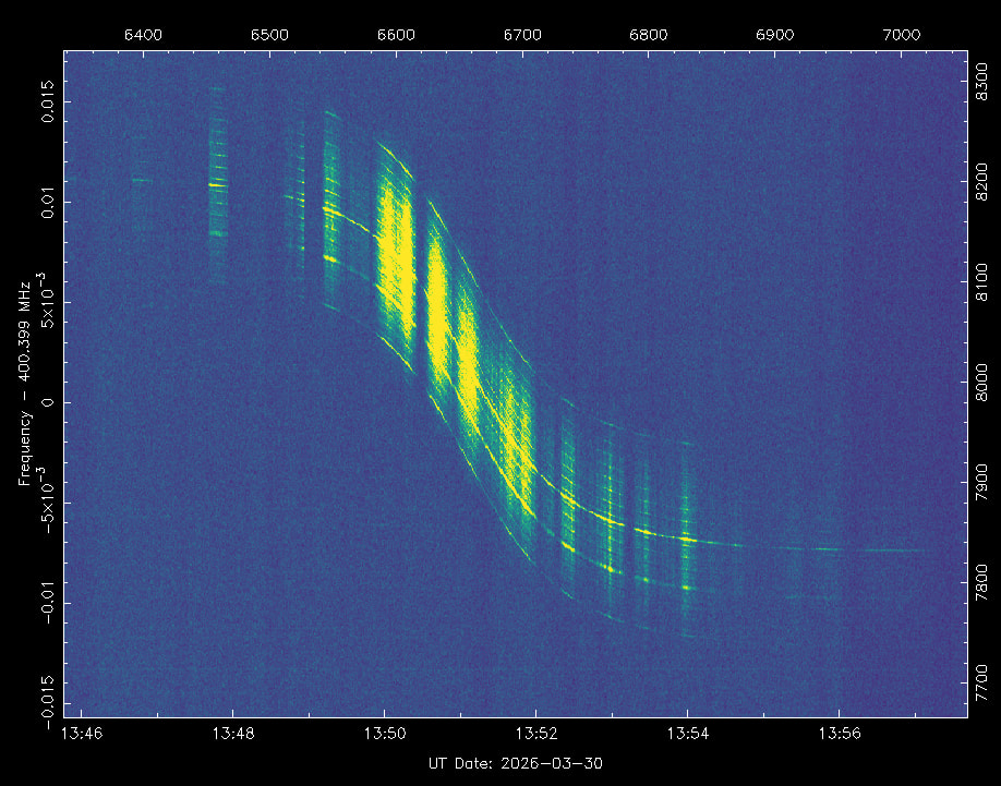

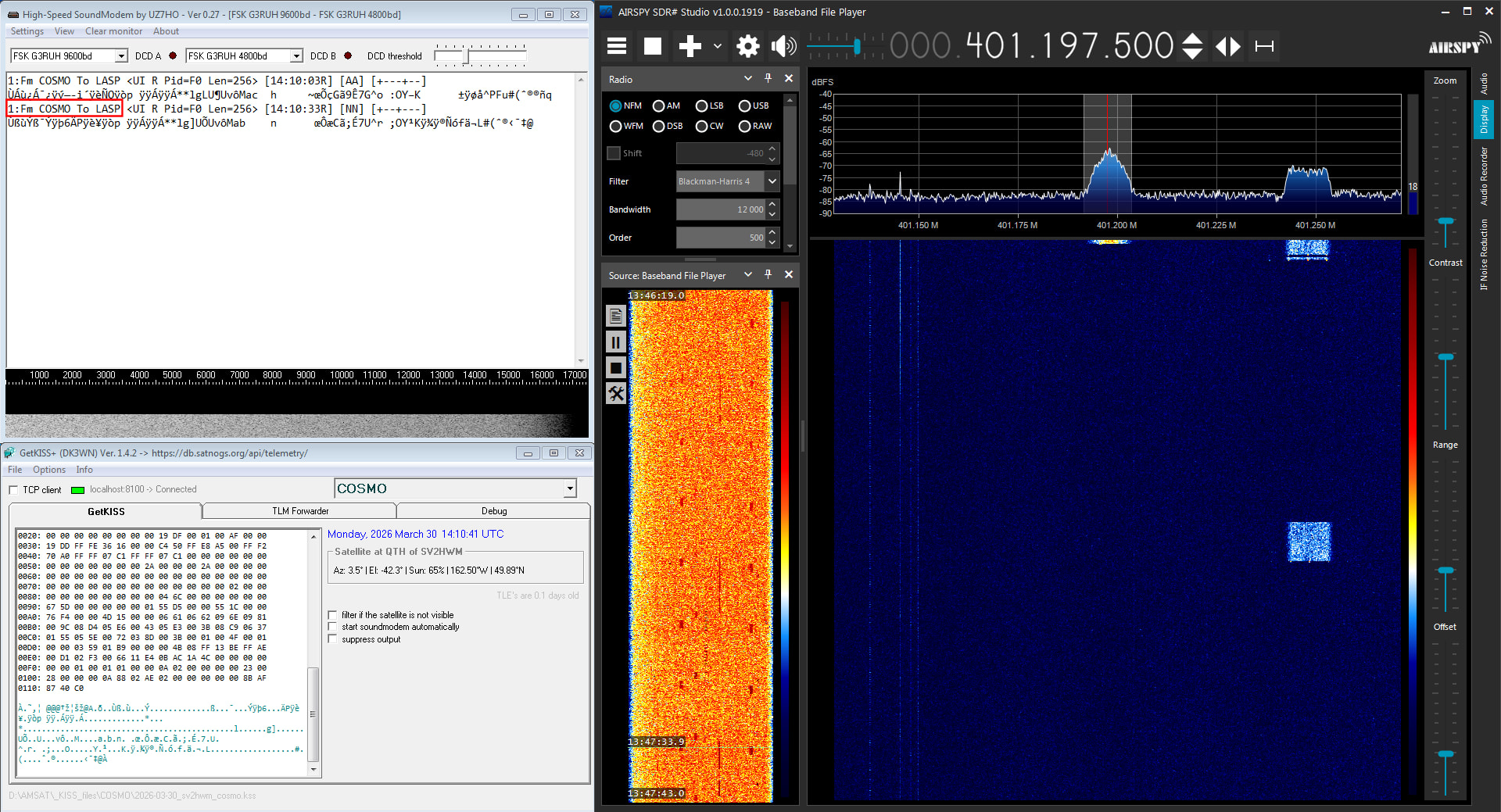

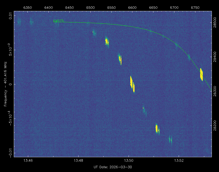

13:47 UTC - COSMO active on 401.200 MHz
SatNOGS Network - Observation 13696441 At the right, the signal is around 401.312 MHz, which is where we expect ERMIS-3 satellite :slight_smile:

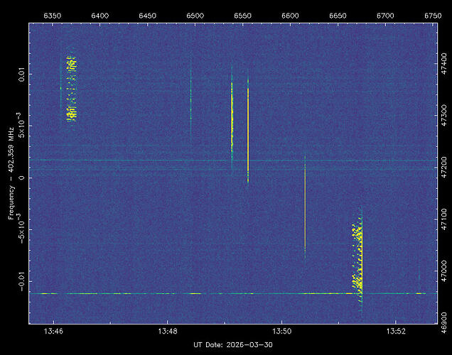

More unknowns from @PE0SAT strf observations:
At 400.350 MHz

At 402.360 MHz
Unknown 8 - T16
1 98339C 26066H   26089.49848319 -.00017647  00000+0 -86272-3 0    00
2 98339  97.4377  49.1533 0003071 132.7149 213.3884 15.18310102    16

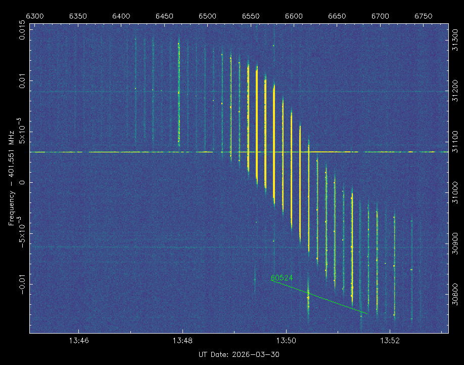

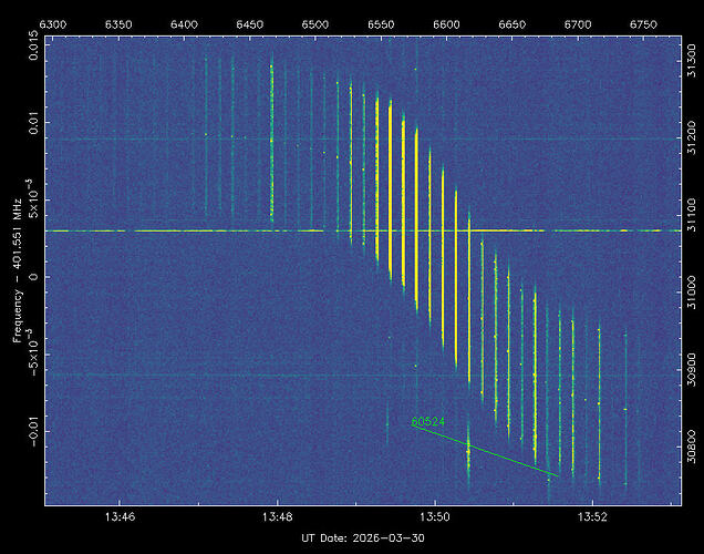

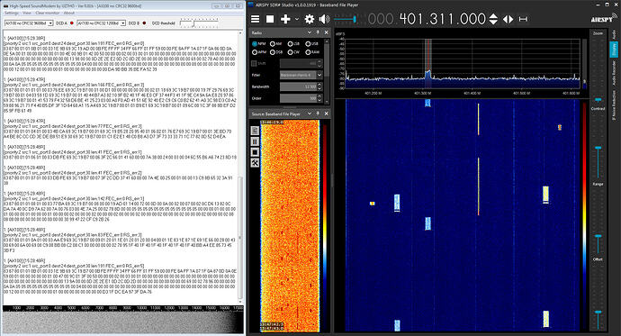

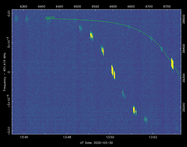

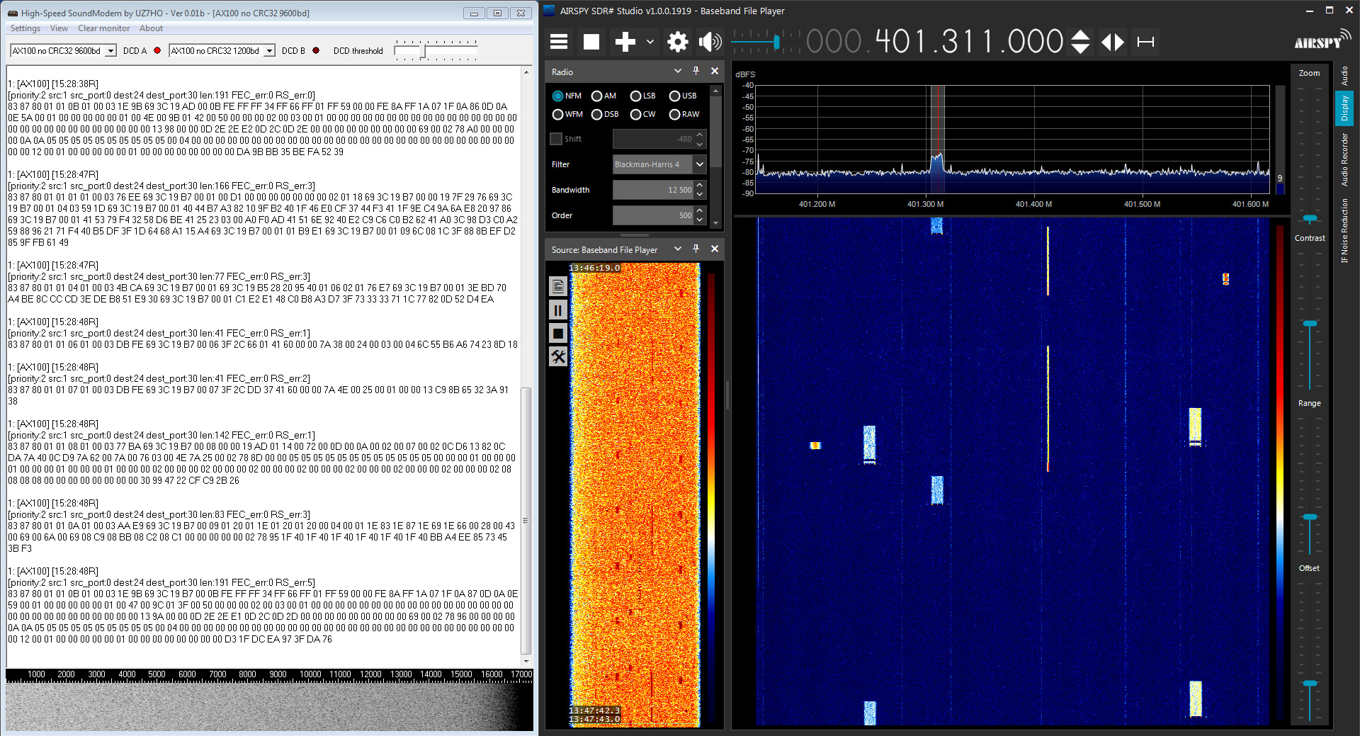

On the waterfall there are 3 identical AX.100 signals on ~401.250 MHz, ~401.313 MHz and ~401.550 MHz. All decoded frames start with “83 87 80 01 01…”
Could these signals be from the three ERMIS satellites?

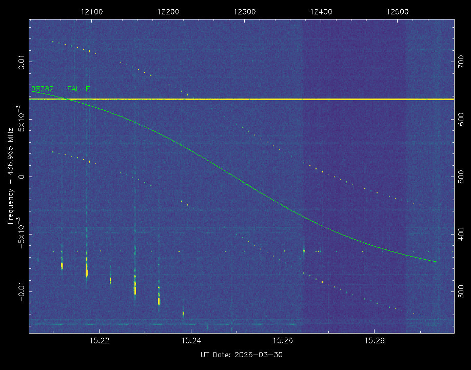

SAL-E / CP16 received
Great point!
According to ITU filing
we expect them in these two ranges: 401.2 - 401.275 and 401.3-401.325
So, 401.250 and 401.313 looks good. 401.550 not but if it decodes similar packet then it could be the third Ermis.
I’m going to add the right mode in DB for these three and let’s keep observing to find out.
