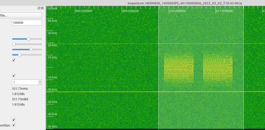

HERMES H6 received in Texas EM12jw RX 1548Z 3April25
Good signal despite low pass.

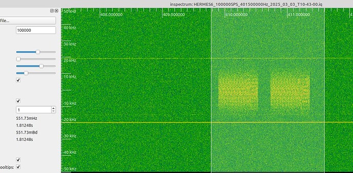

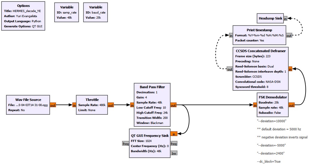

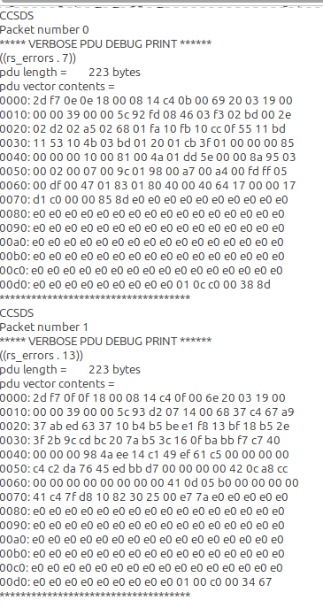

By the way it seems that, almost in defiance of the Shannon’s theorem, high SNR HERMES beacons can also be decoded from 48kHz ogg files…
I’ve tried this flow on observation 11343693 and the one from @geoscan, getting 2 and 3 good beacons respectively

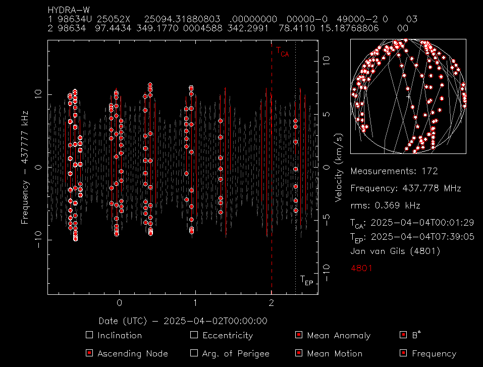

HYDRA-W TLE Update
HYDRA-W
1 98634U 25052X 25094.31880803 .00000000 00000-0 49000-2 0 03
2 98634 97.4434 349.1770 0004588 342.2991 78.4110 15.18768806 00

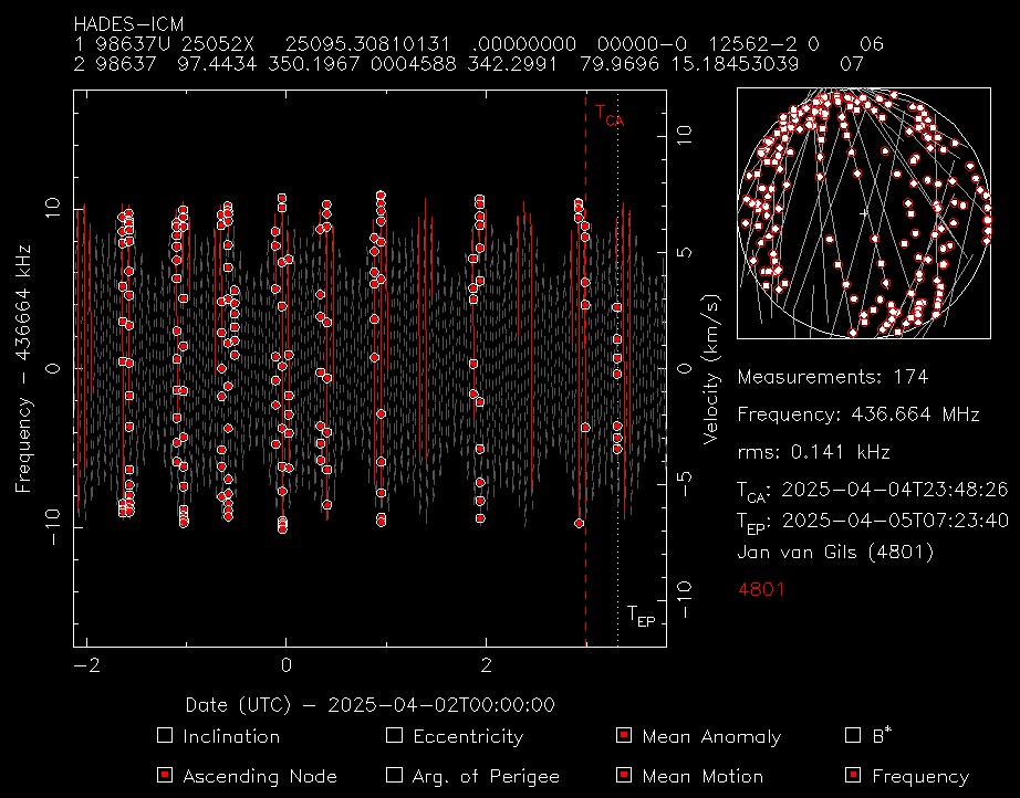

HADES-ICM and HYDRA-W TLE Update
HADES-ICM
1 98637U 25052X 25095.30810131 .00000000 00000-0 12562-2 0 06
2 98637 97.4434 350.1967 0004588 342.2991 79.9696 15.18453039 07

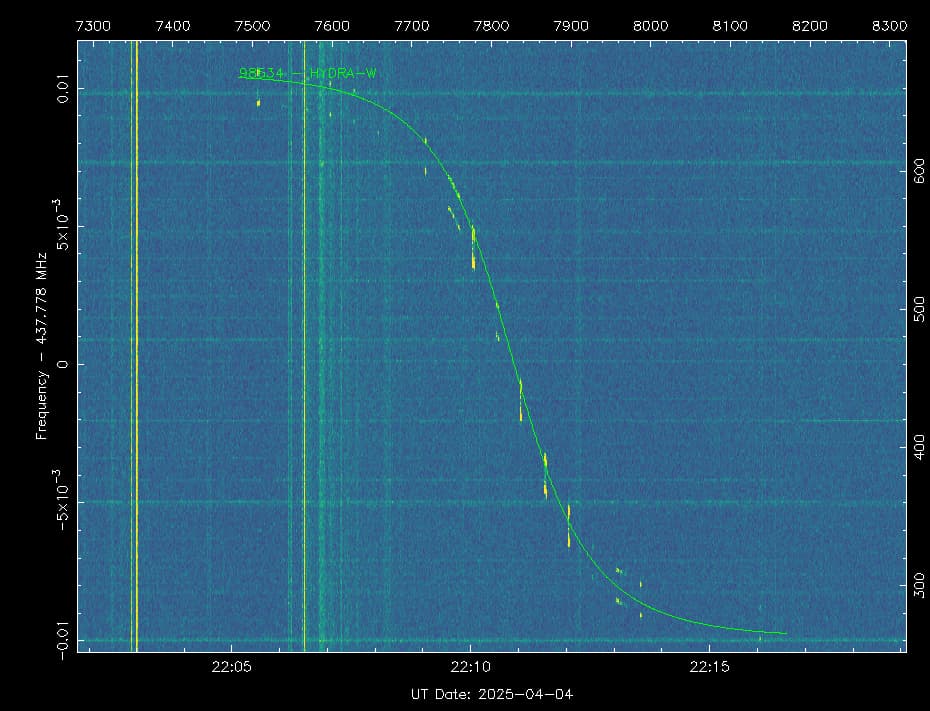

It is puzzling why with HYDRA-W it is more difficult to get decent TLE set.
@ea4gqs are they different in size or shape and therefore more sensitive to drag, or do we have the same LO issue as with HADES-x and that influences the selected data points?
HYDRA-W
1 98634U 25052X 25095.30731647 .00000000 00000-0 58055-2 0 04
2 98634 97.4434 350.1461 0004588 342.2991 80.1271 15.19034575 07

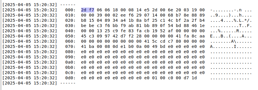

Good day!
Since the objects tracked as likely Hermes-H* sats are still fairly close together, I’m not clear what I might be decoding sometimes. I recall that my original ‘H2’ decode was confirmed by the Team based on the first two bytes.
Is this frame received today (5-Apr) with ‘2d F7’ as the first two bytes perhaps from Hermes-H6?
Hi @K4KDR,
yes this is HERMES H6, which is reguarly transmitting his beacon
We are still looking for H2 (2d 47), so if you see him…
Thanks a lot!

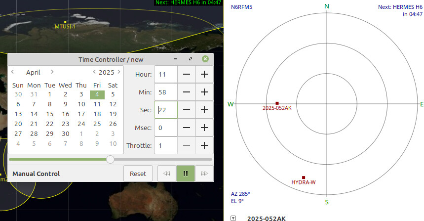

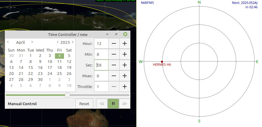

Scott,
Recent results from em12jw and the timing of frames being received indicate it’s Hermes H6, despite H1 (AJ) and H2 (AK) passing over in succession.
Despite multiple attempts, I have never seen H1 or H2 active.
Here’s the beginning of some decoded hex
0000: 2d f7 0a 0a 18 00 08 14 d9 23 00 69 20 03 19 00

Yes, this is the ID of HERMES H6.
As Francesco previously mentioned, you should convert the first two bytes in binary and take a subset of the bits:
2DF7 = 0010110111110111
bytes [2:11] = 1011011111 = decimal 735, which is HERMES H6 ID.
The IDs of the HERMES satellites is as follows:
We confirm that H6 is alive and well, while we are still looking for H1 and H2.
