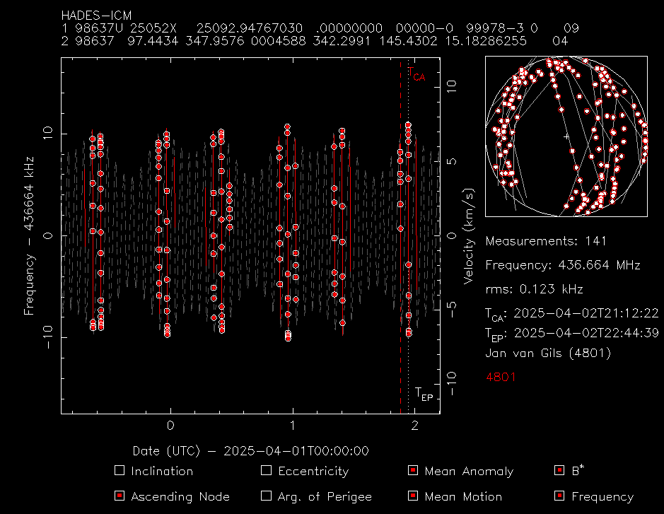

HADES-ICM TLE Update
HADES-ICM
1 98637U 25052X 25092.94767030 .00000000 00000-0 99978-3 0 09
2 98637 97.4434 347.9576 0004588 342.2991 145.4302 15.18286255 04

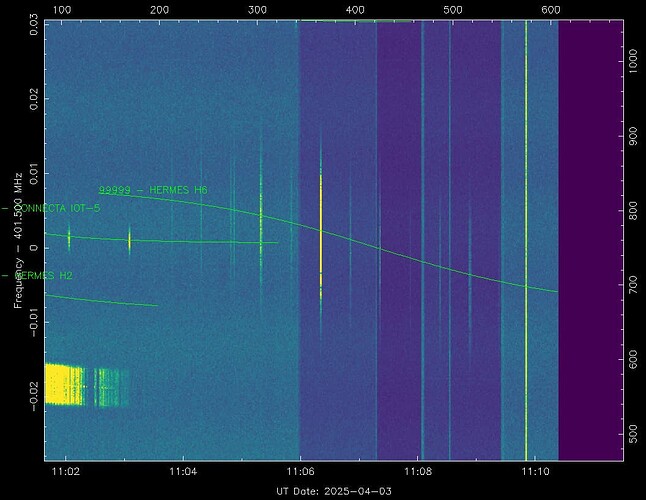

Is it HERMES H6 signal visible on ~360th second?

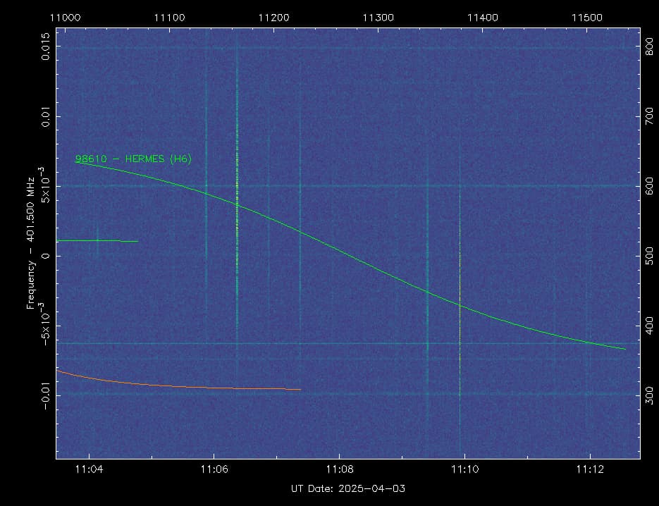

Update: (13:28 UTC)
Also signal is visible on this observation more clearly:
Yep this seems HERMES H6!
Do you happen to have IQ data (or uncompressed audio) for the second one at least?

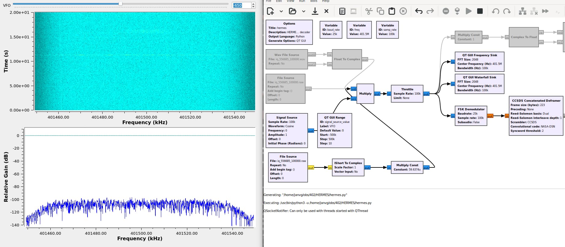

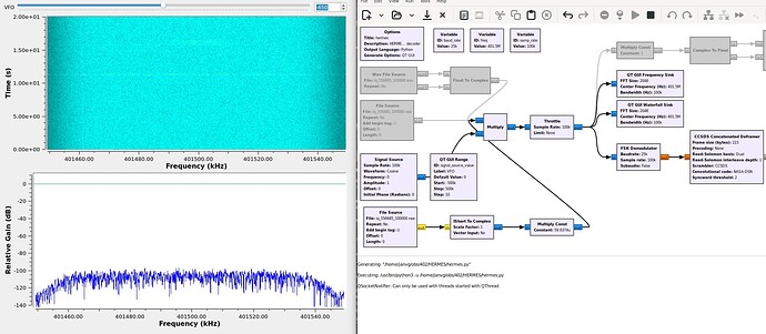

@geoscan sorry to bother you, I’m quite new to data decoding. Can I ask you which format your IQ file is? With my standard gnuradio flow I’m not able to read it
Thanks again
y
Inspectrum does not seem to view the .RAW I/Q file either.

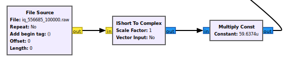

This should work
And producing the following frames:

The raw file is converted to PCM 16 wav
sox -t raw -b 16 -e signed-integer -r "${SAMP}" -c 2 "${1}" "${1%.raw}".wav
gr_satellites HERMES-H6.yml --rawint16 iq_556685_100000.wav --samp_rate 100000 --iq
