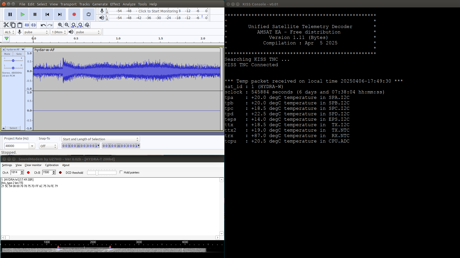

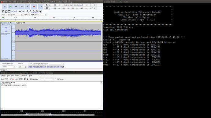

And on replay of my Hydra-W I/Q files, Iβm not getting a decode. So, emailed Andy back to ask.
The back story on this is that earlier this morning he emailed asking if I had any Hydra-W I/Q files for him to test with. I did not, but much to my surprise it was coming over in about 30-seconds from the time of that email!
I quickly reconfigured & got -3- decent frames. He decoded one of them and sent the link I posted above. Here was his decode:
1: [HYDRA-W] [18:44:29R]
[frm_type:2 len:15]
21 5C 54 08 00 78 78 75 7D FF 6C 75 76 FE 79
β¦ so, hope to hear back from him to see if Iβm just doing something wrong or what. Here are the I/Q files that I gave him:

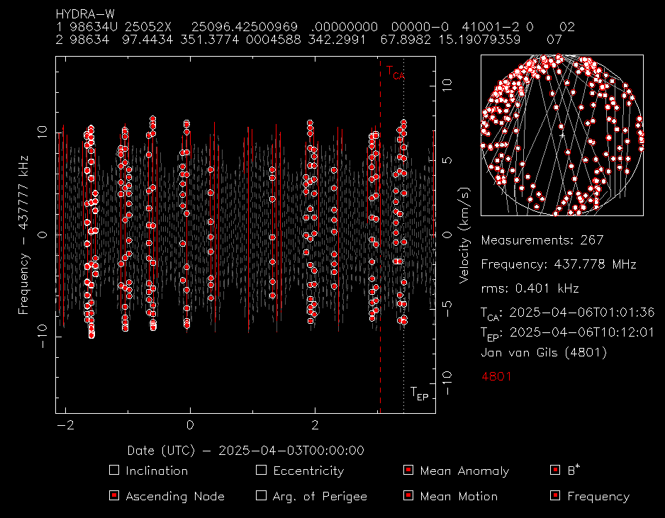

HYDRA-W TLE Update:
HYDRA-W
1 98634U 25052X 25096.42500969 .00000000 00000-0 41001-2 0 02
2 98634 97.4434 351.3774 0004588 342.2991 67.8982 15.19079359 07

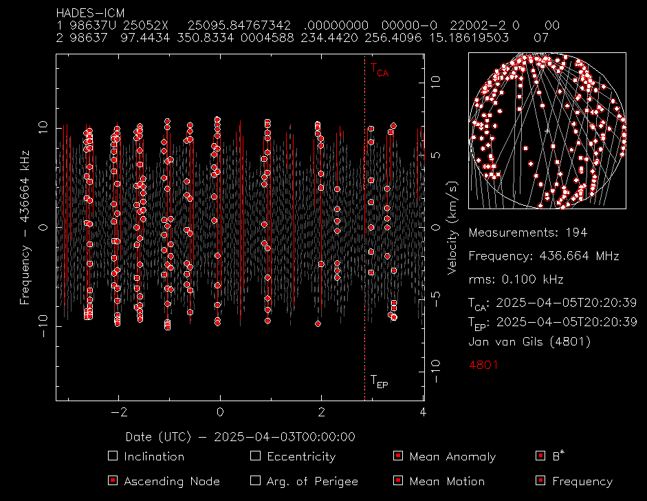

ikhnos check:
HADES-ICM TLE Update
HADES-ICM
1 98637U 25052X 25095.84767342 .00000000 00000-0 22002-2 0 00
2 98637 97.4434 350.8334 0004588 234.4420 256.4096 15.18619503 07
ikhnos check
Not an answer for why Iβm not decoding Hydra-W on I/Q replay when using the new UZ7HO SoundModem but Andy replied with some helpful info.
He produced an audio file from my sample from this morning and shared it with me - clearly that decodes just fine both in SoundModem and the included βKISSGENESIS.exeβ decoder:
β¦ so, Iβll do some further testing here!

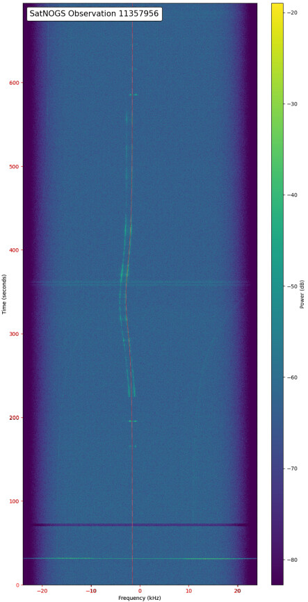

I have created some obs on my satnogs stations and try to create some useful HADES-ICM and HYDRA-W IQ recordings.
I will keep you both informed

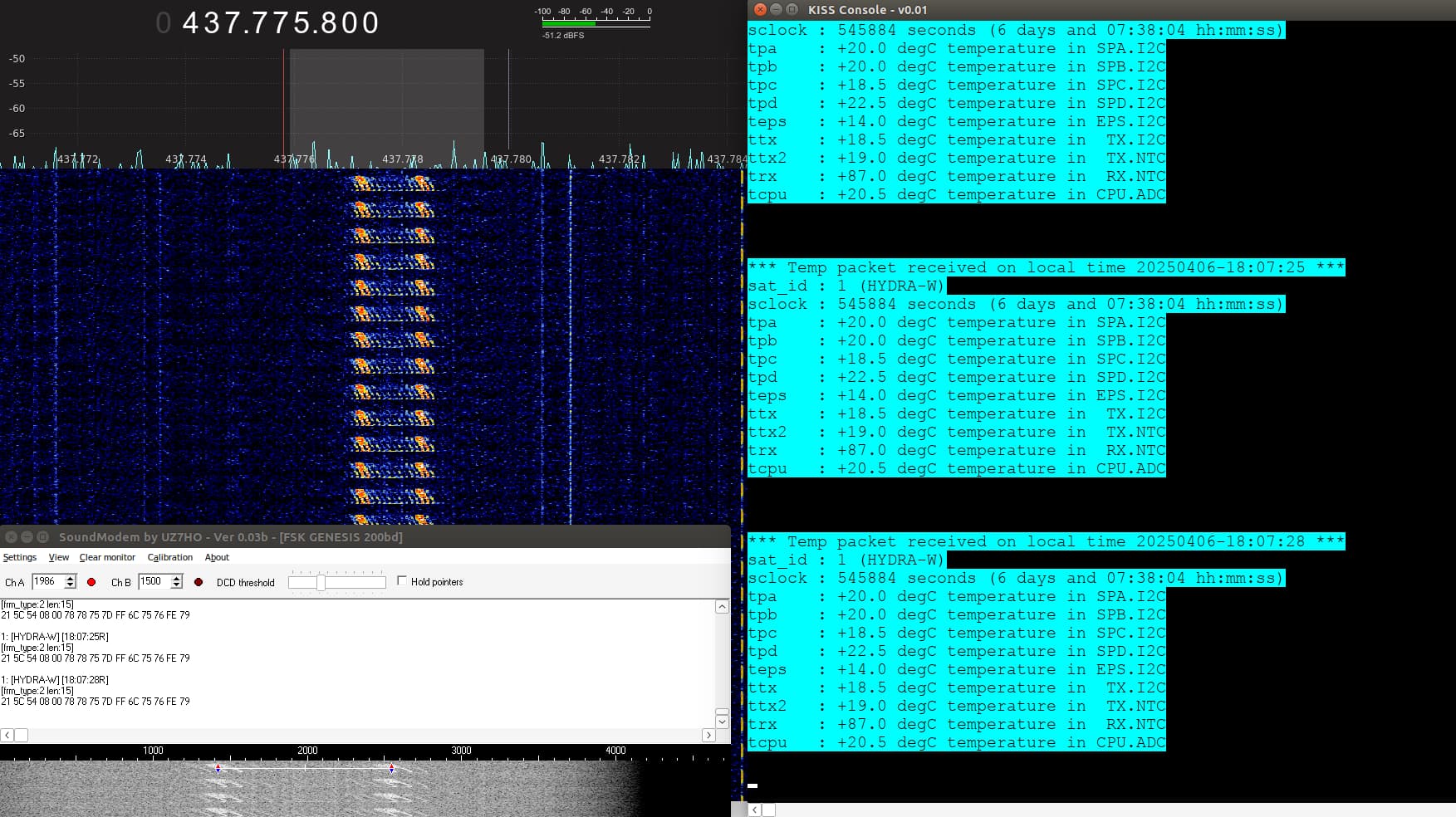

Update!
Yes, the previous download was removed.

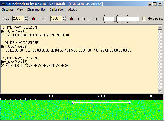

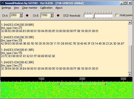

Here is a βUniversalβ SoundModem that should accommodate any
HADES or HYDRA satellites on any SSB sideband.
http://uz7.ho.ua/genesis200.zip
β¦ I/Q replay in GQRX of my packets from this morning now decodes. Will look forward to trying sats other than Hydra-W!

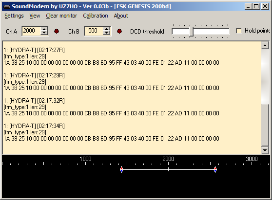

I gave HYDRA-T a try using an old IQ recording, and all looks fine
1: [HYDRA-T] [20:24:25R]
[frm_type:3 len:27]
3A 2A 40 12 00 2A 40 12 00 01 00 FF 09 00 05 10 00 01 00 00 FF FF FF FF FF FF 00

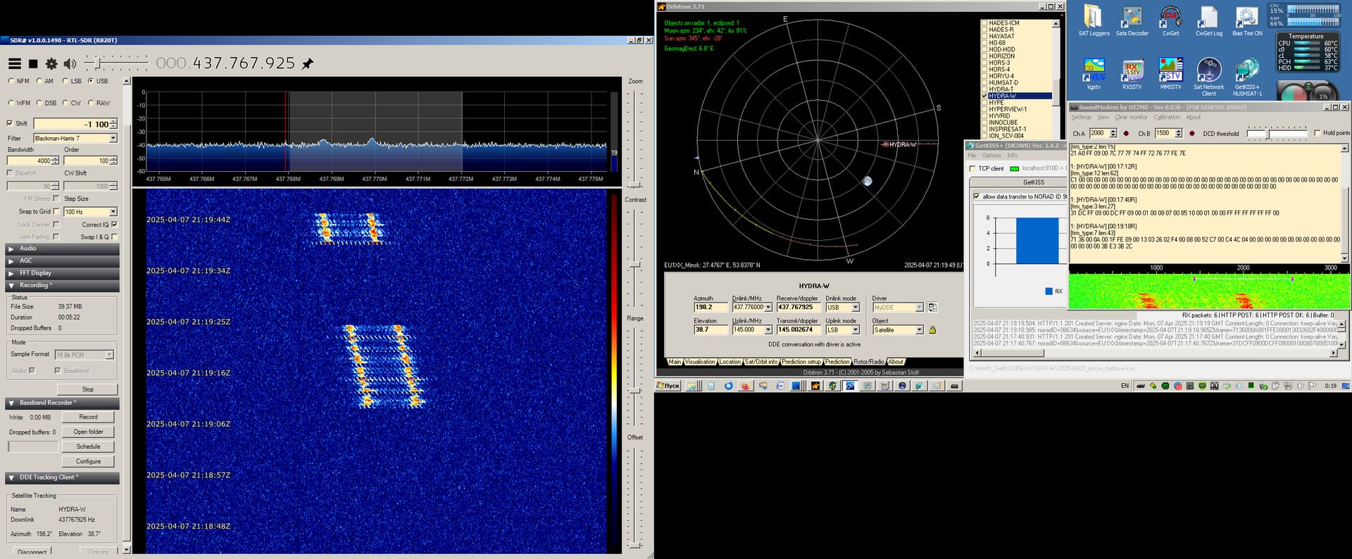

Good morning,
I have created an HYDRA-W IQ recording, do we still need one?
Decoded the following frames:

HYDRA-W RAW Telemetry
Used new SoundModem.
1: [HYDRA-W] [00:14:40R]
[frm_type:3 len:27]
31 28 FF 09 00 28 FF 09 00 01 00 08 07 00 85 10 00 01 00 00 FF FF FF FF FF FF 00
1: [HYDRA-W] [00:15:10R]
[frm_type:1 len:29]
11 46 FF 09 00 44 37 76 00 1A 00 FB B5 6B 55 FD B3 D3 3F 00 F6 01 04 CD 20 00 00 00 00
1: [HYDRA-W] [00:16:40R]
[frm_type:2 len:15]
21 A0 FF 09 00 7C 77 7F 74 FF 72 76 77 FE 7E
1: [HYDRA-W] [00:17:12R]
[frm_type:12 len:62]
C1 00 00 00 00 00 00 00 00 00 00 00 00 00 00 00 00 00 00 00 00 00 00 00 00 00 00 00 00 00 00 00 00 00 00 00 00 00 00 00 00 00 00 00 00 00 00 00 00 00 00 00 00 00 00 00 00 00 00 00 00 00
1: [HYDRA-W] [00:17:40R]
[frm_type:3 len:27]
31 DC FF 09 00 DC FF 09 00 01 00 08 07 00 85 10 00 01 00 00 FF FF FF FF FF FF 00
1: [HYDRA-W] [00:19:18R]
[frm_type:7 len:43]
71 36 00 0A 00 1F FE 09 00 13 03 26 02 F4 00 08 00 52 C7 00 C4 4C 04 00 00 00 00 00 00 00 00 00 00 00 00 00 00 00 00 3B E3 3B 2C
1: [HYDRA-W] [00:20:10R]
[frm_type:2 len:15]
21 72 00 0A 00 73 71 73 70 FF 73 76 71 FE 7B
1: [HYDRA-W] [00:22:10R]
[frm_type:3 len:27]
31 EA 00 0A 00 EA 00 0A 00 01 00 08 07 00 85 10 00 01 00 00 FF FF FF FF FF FF 00
1: [HYDRA-W] [00:23:10R]
[frm_type:1 len:29]
11 26 01 0A 00 00 00 00 00 00 00 3B B4 6B 4D F2 B3 33 3F 00 F3 01 23 CD 20 00 00 00 00
1: [HYDRA-W] [00:24:10R]
[frm_type:2 len:15]
21 62 01 0A 00 67 65 66 66 FF 6E 6B 66 FE 71
