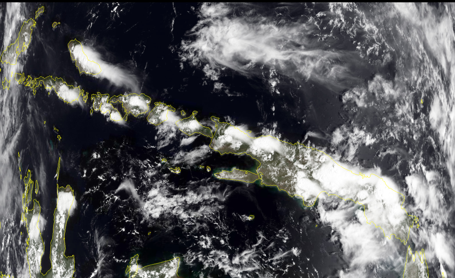

inspired by all posting on this thread, i’m trying recode meteor.sh but now with satdump as the decoder.
this work flawless on latest satnogs-client docker (version 2.1.1) (running on raspberry with satnogs manual docker installation)
the result can be check on this obs

and.. finish! :partying_face:
just create a new meteor m2-3 or m2-4 observation
