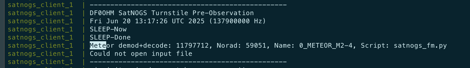

  • The message Could not open input file appears in the log after calling meteor.sh.
  • I cannot understand where this message comes from, since this error message does not appear in udp2ishort.py, meteor_demod, and meteor_decode either!?
  • I’m also confused as to why satnogs_fm.py is logged as the script name.

Hi,
some clues in meteor_decode.
if the flowgraph running is satnogs_fm then you have selected the wrong transmitter. the client doesn’t support lrpt so selects fm in that case, and as you can see in the spectrum plots, it is only about +/- 20kHz.
that is the reason we added the “IQ recording usage” transmitters some years ago, as these specifies fsk as modulation and 40k as baudrate, which results in a wider bw.
I can see you made at least one of these in 11813358.
what does “SLEEP-Now” do btw ?
