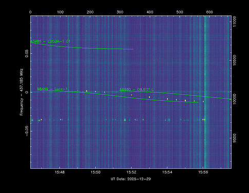

not found in two observation (29-12-2025):
14:15:03 UTC
15:46:21 UTC

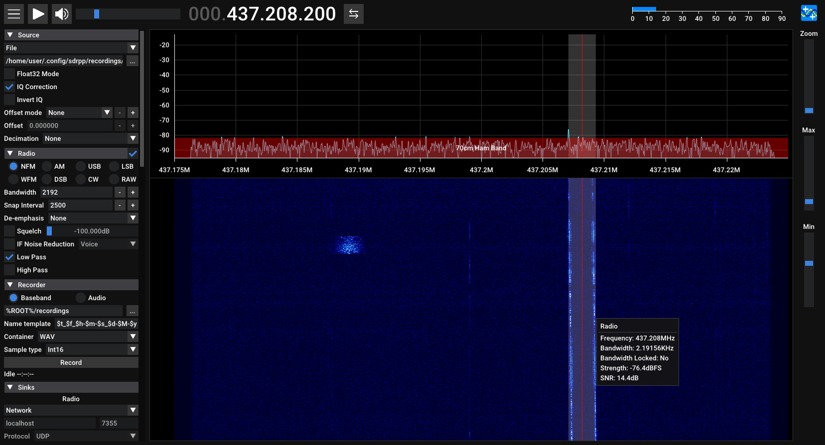

but i will put here screenshot of the signal that seen same size between me and @pu4elt . i download the iq file of @pu4elt and replay on sdrpp.
same bandwidth around 2.19khz

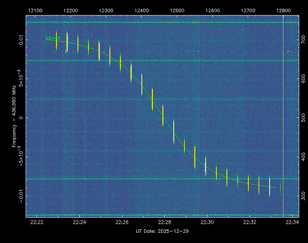

The pair (at least!) of 62.5k LoRa transmitters continue to be decoded along the same orbit as KOSAR-1.5 (now UN-encrypted!), so it’s reasonable that they are likely from the 28-Dec launch.
I had made a mistake on the frequency of the 2nd object; now that that is corrected (to 436.175) in tinyGS, both objects are accumulating decodes when over populated areas:

based on this tle, i try identified mysterious signal that @pu4elt and me got on 437.2 Mhz with strf tools, and best fitting satellite is 98441 - AIS 62

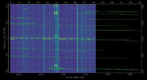

no mysterious signal there. the mysterious signal should seen like a double line and continues signal on waterfall,
i also make obs on 02:09-02:17 UTC, and the mysterious signal not found:

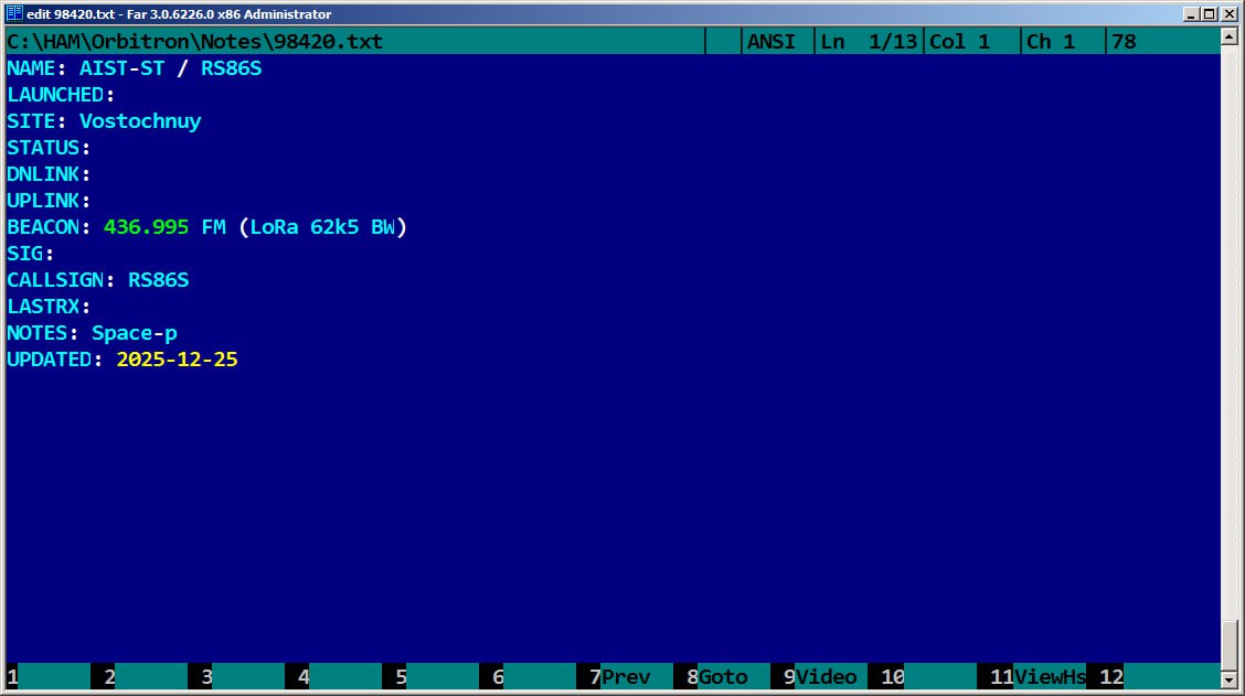

And… seeing that the sonic.space site had marked AIST-ST as ‘active’, I found in their documentation a reference to 62k5 LoRa on 436.995 MHz. After recording tonight’s pass centered on 436.995 and determining the remainder of the LoRa parameters, I was able to decode most of the 1-minute interval frames centered quite neatly on AIST-ST’s frequency. I’ve submitted my findings to tinyGS in case they would like to add it as an object for that network to track.

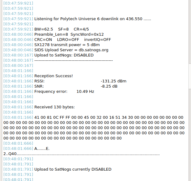

Tonight I made an I/Q recording centered on 436.350 looking for anything (LoRa or otherwise) from Polytech Universe 6. Nothing was seen on that freq, but up on 436.550 there was a perfect 62.5k LoRa signal:
… which decodes as follows:
… since I don’t know what a good frame from PU-6 should look like, I have no idea if this is a PU-6 downlink 200 kHz higher than expected, or if it’s “yet another” of these 28-Dec satellites showing up w/ a LoRa downlink.
I have not found any listing for ‘anything’ on 436.550 from this deployment, but I could easily miss something. Please let me know if anyone spots documentation of an object that is supposed to be on 436.550 (assuming it’s not PU-6 way off-freq).
