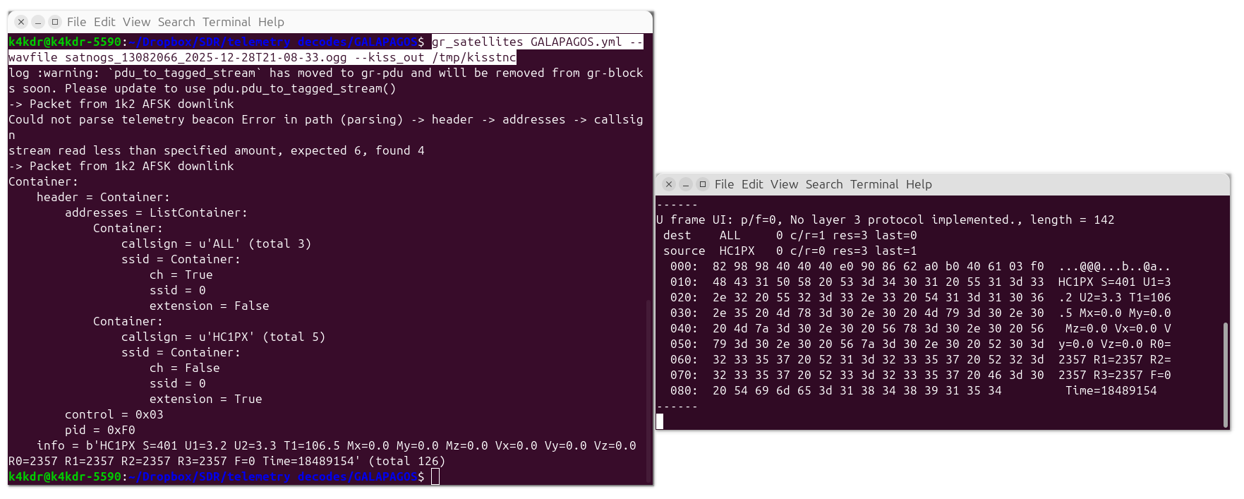

Great work to everyone involved w/ this non-standard AFSK situation!
And if, by chance, you would like to output those decodes to the direwolf display that I enjoy, note that if you add
–kiss_out /tmp/kisstnc
to your gr_satellites command string, the decoded packets will be sent to direwolf running in a separate window w/ the “-p” switch!

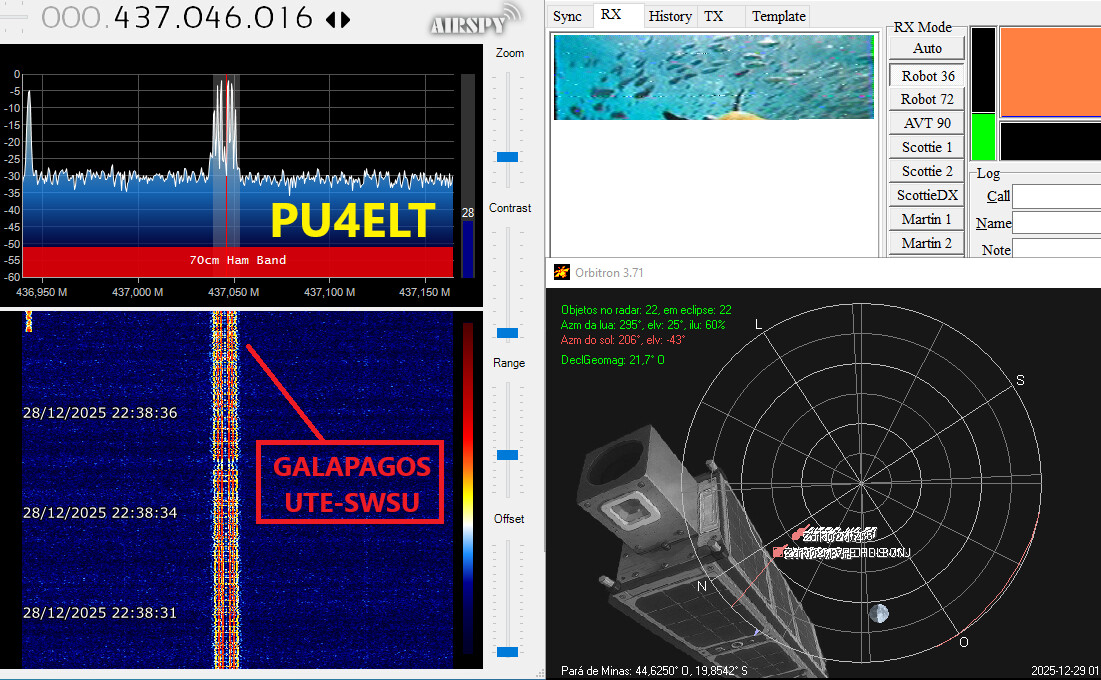

GALAPAGOS-UTE-SWSU over Brazil :brazil: !!
Several other signs were also received… I will try to identify them little by little.
It’s difficult work because my right wrist is having serious problems :cry: :rofl:

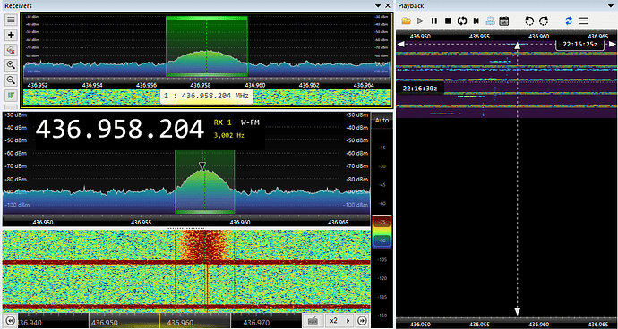

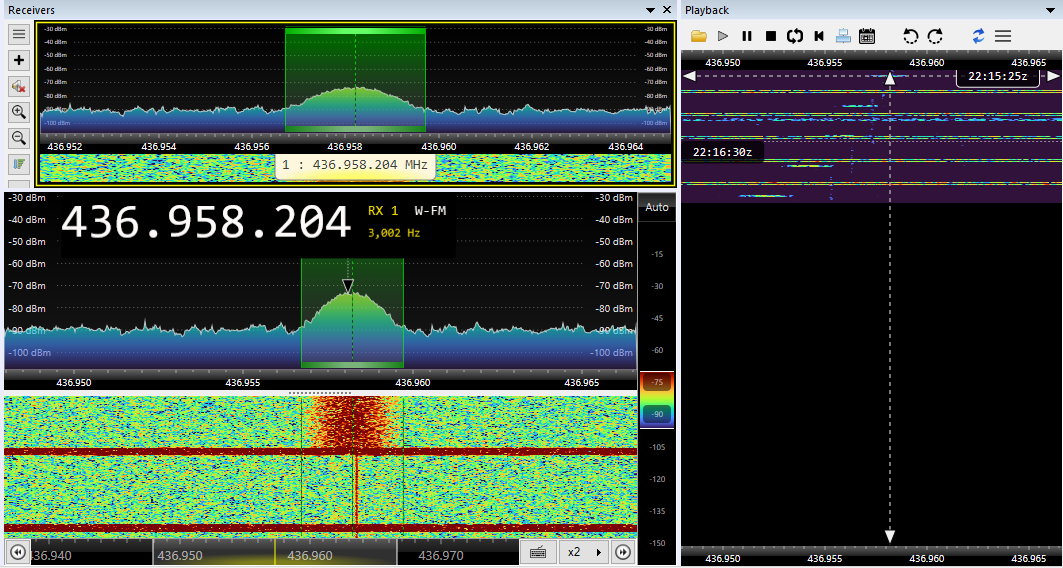

Guys, I noticed a modulated FSK signal at 437.2 MHz… Any ideas ??

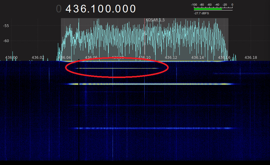

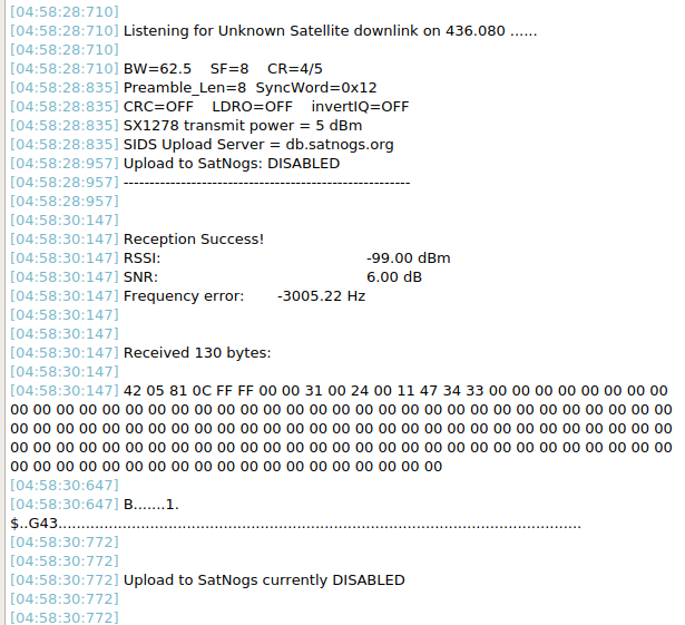

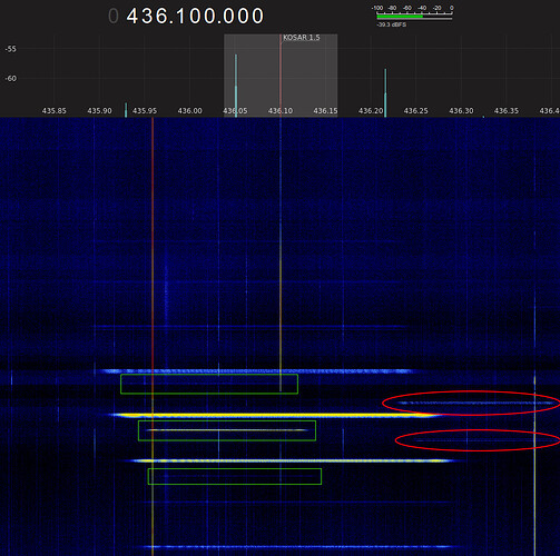

I know that SatNogs isn’t configured to do LoRa decodes, but since we’re all looking at the same spectrum, I wanted to pass along the finding of a signal that I’ve not yet been able to match to any satellite.
While monitoring the strong 125k LoRa downlinks from KOSAR-1.5, a 62.5k packet showed up in the waterfall….
… later, I isolated that packet and determined the LoRa parameters. Unfortunately no ASCII to help ID the source (unless ‘G43’ means something). So, if anyone sees a ‘smaller’ (62.5k) packet around 436.080 that you think might be FSK, it’s this LoRa packet. I don’t know if it might be from an existing sat (I couldn’t find a match) or a payload from this 28-Dec launch. Thanks if anybody happens to find a possible match at some point.

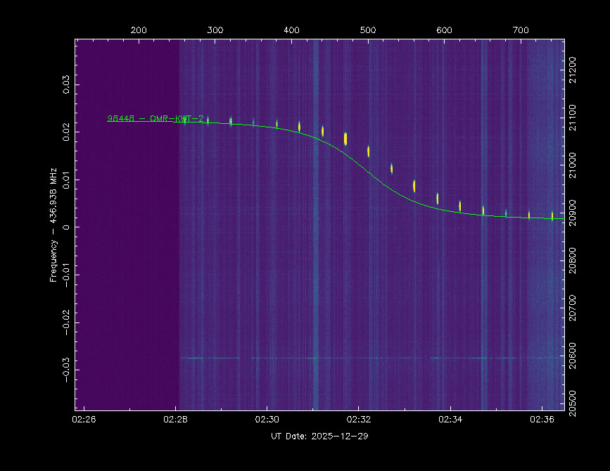

The decoded frame & LoRa parameters:
alternative_names:
  • RS95S
decode:
gr_satellites QMR-KWT-2.yml --wavfile qmr-audio_436960000Hz_01-21-47_29-12-2025.wav

Could be RTTY. Do you have a record?

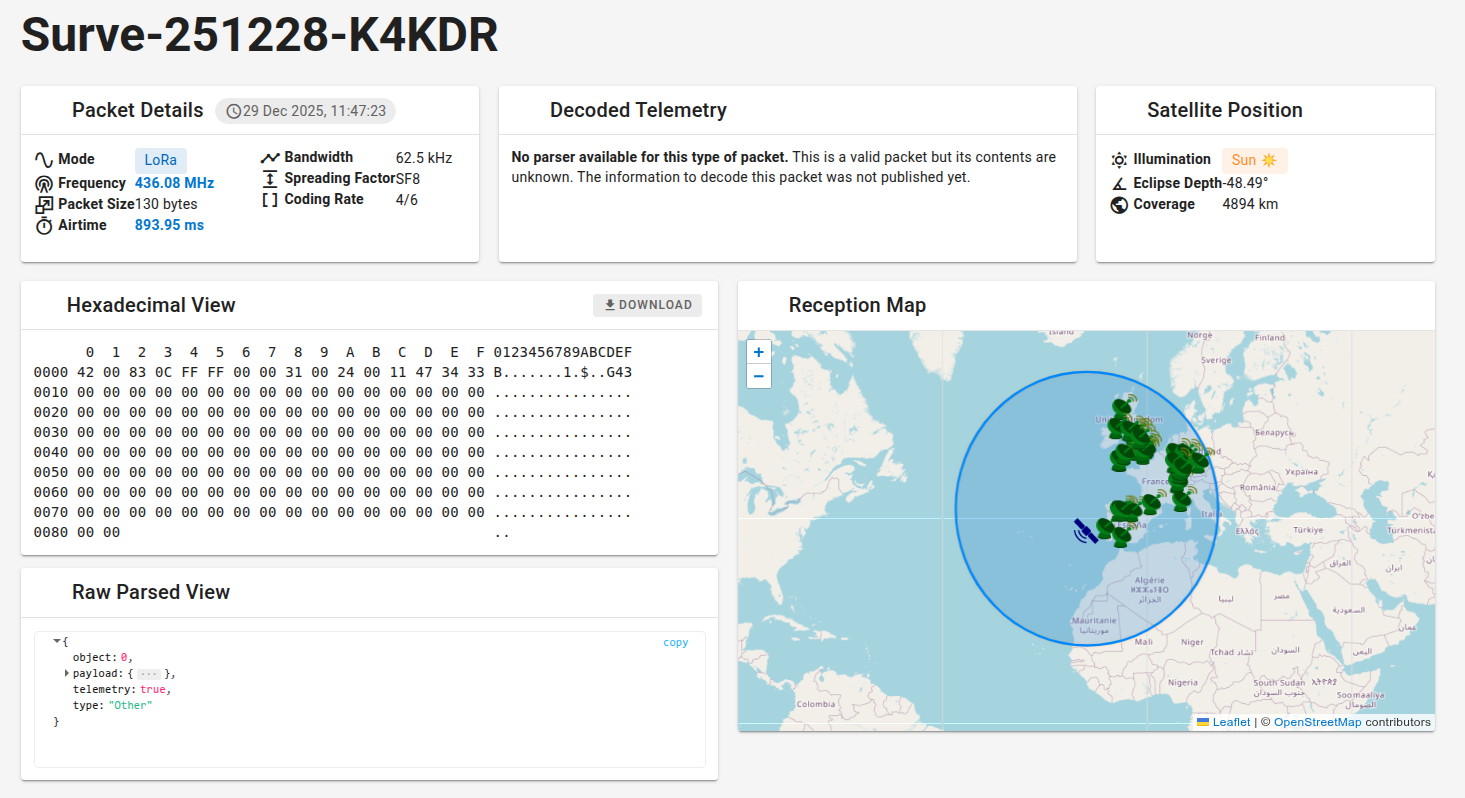

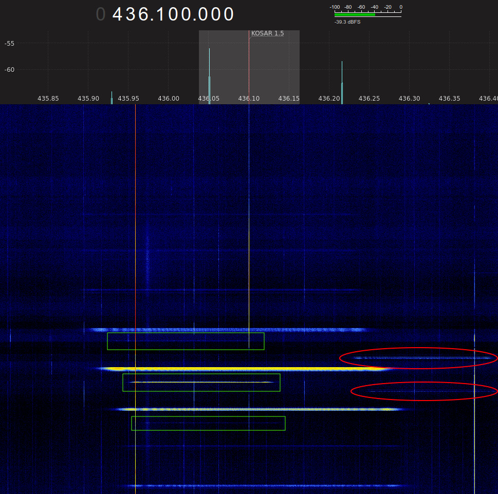

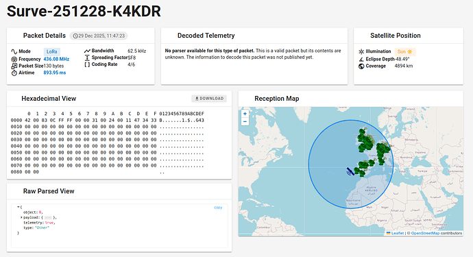

Thank you! And on further inspection, it turns out that there are -2- separate transmitters sending frames w/ the same parameters. The second is in the area of 436.320. (red ovals - both signals on 1-minute interval)
Temporary “Survey” objects have been created on the tinyGS network so that all stations world-wide not in-range of some known satellite are monitoring for these two signals. Those URL’s for anyone curious are:
-and-
… decodes started appearing almost immediately, so given time the approximate position will hopefully match a known (or sometimes UN-known) satellite!

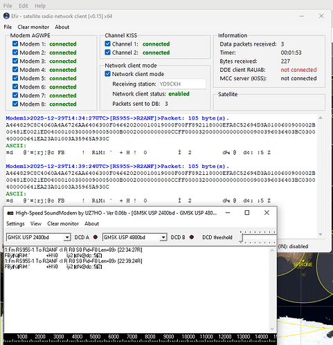

Yeep… Download the IQ file HERE

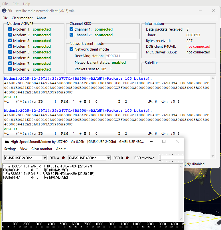

QMR-KWT-2 over Bali, OI71oi, 14:15 UTC.
Decoded from IQWAV file, 4800bd

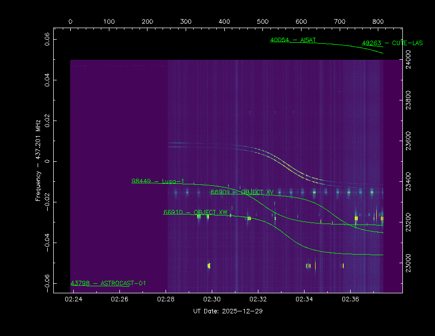

Hello guys! Here are preliminary corrected with strf TLEs for bunch of new satellites. Our NORAD ids not matches with selected by satnogs, sorry for this. Seems that TLE`s more accurate and reduces frequency error from 3kHz nearly to 300Hz. Hope they can be useful.
