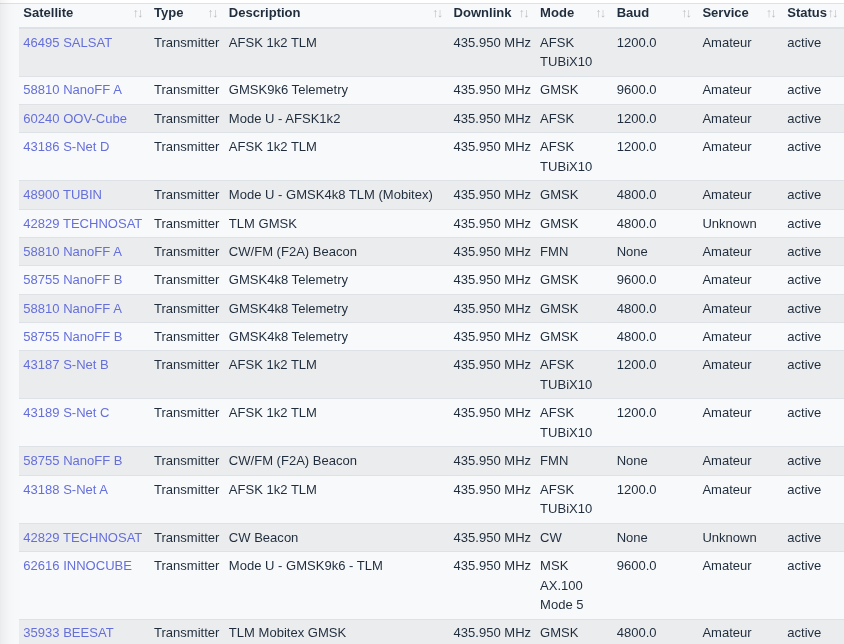

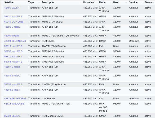

To upload each beacon to the correct Norad ID you may use the gr-satellites Uploader.
iirc I had to hunt for it, but got both rates from both NanoFF-A and NanoFF-B
You are seeing these frames now because gr-satellites main branch comes with the new Mobitex-NX deframer I implemented (#723). Happy to see it beeing used!

I’ve asked the operator: 9k6 has not implemented.

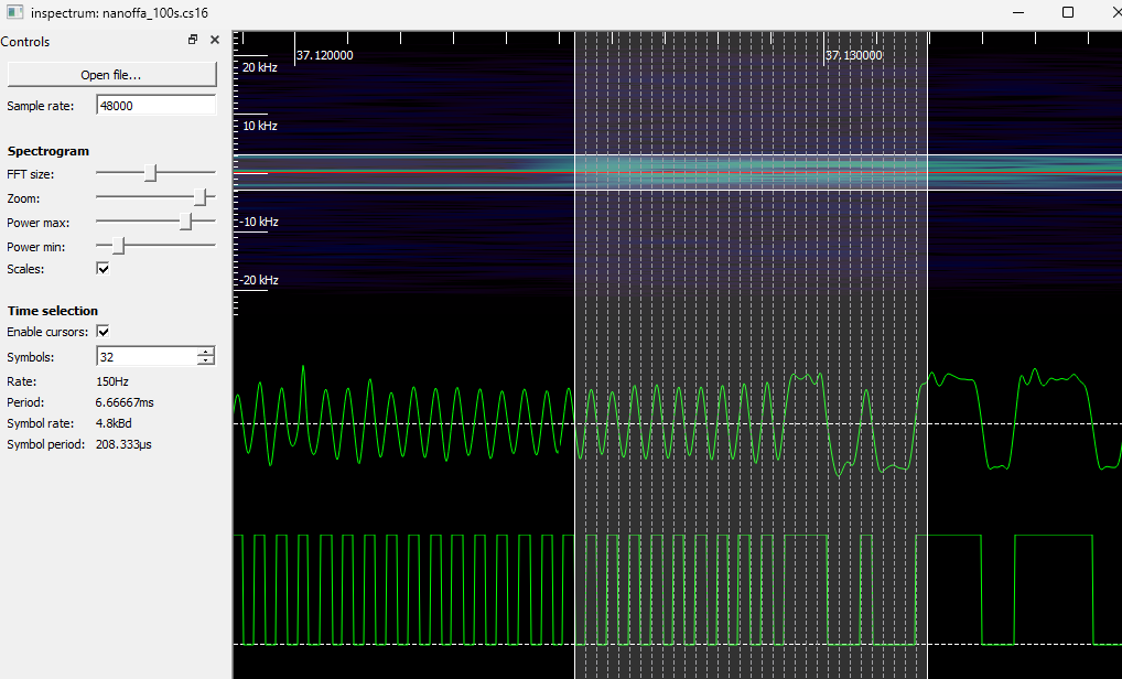

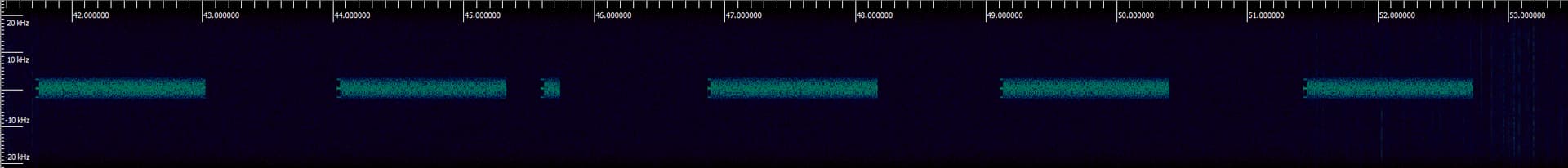

I dug out the recordings and looked at them with inspectrum, and indeed looks like there’s only 4k8.
nanoff-a_9741697_48000.zip (1.1 MB)
Disabled NanoFF-A and B 9600 baud transmitter in the db
How do you know what part to select and the what number of symbols ?
number of symbols is just the length of the ruler here, to see if the transitions line up or not. using the scrollbar to move between the different packets in the iq-dump.
also visible in the preamble tones being the same distance on all of the packets.
