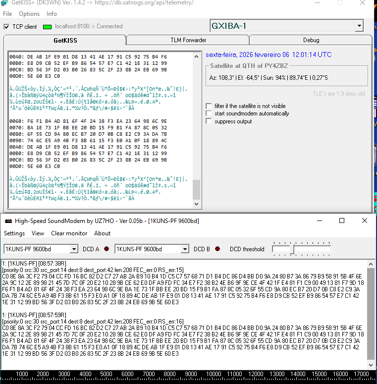

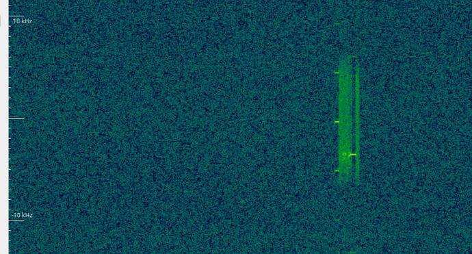

Great job, Bob!
I see the same distortion in your packet in the lower-freq section… perhaps the transmitter is injecting some trash making these frames more difficult to decode.
Based on this and given that 1KUNS was MSK AX100 Mode 5, I’ve changed the transmitter to that mode in DB for GXIBA-1.
Hi Bob,
Yes ! WideFM demod and 1KUNS Ver 0.05b is OK !
73 de Roland PY4ZBZ

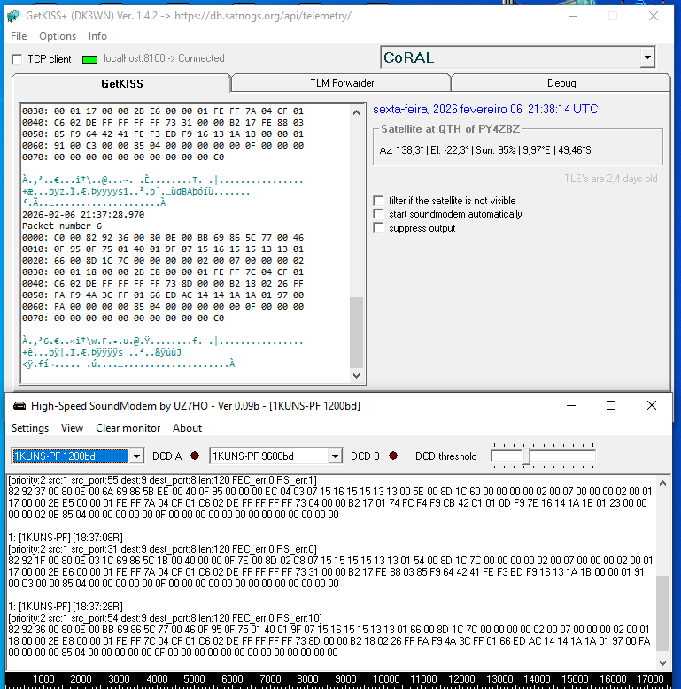

CoRAL @ 1k2

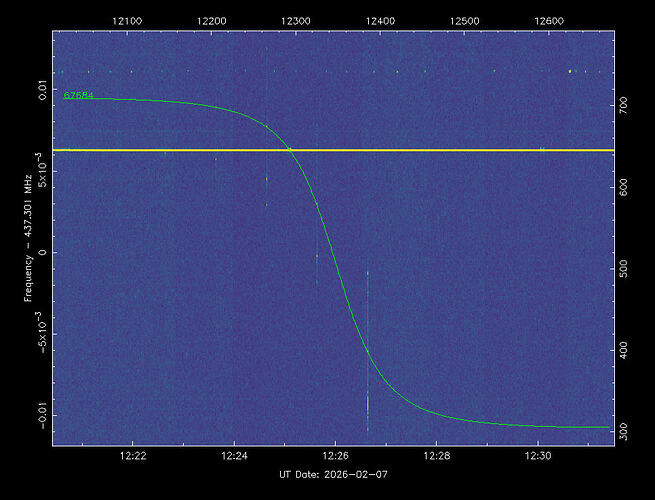

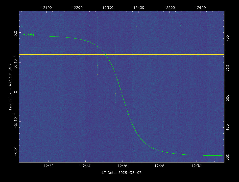

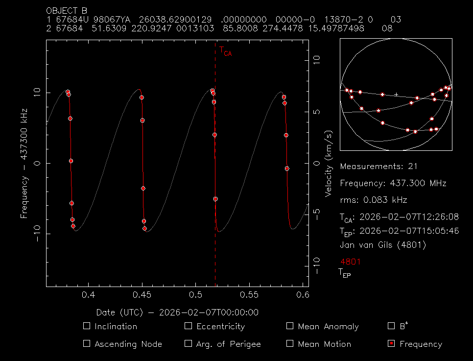

2026-02-07 12:2x UTC
GXIBA-1 TLE Update, matching object 67684
It looks like with the assigned TLE there are some changes:

This is one of these changes!
As noted in the previous post it seems there were some swaps, so here is the latest status update:

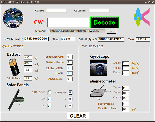

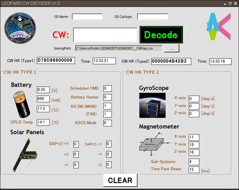

LEOPARD: QSL cards
X: leopard_cubesat

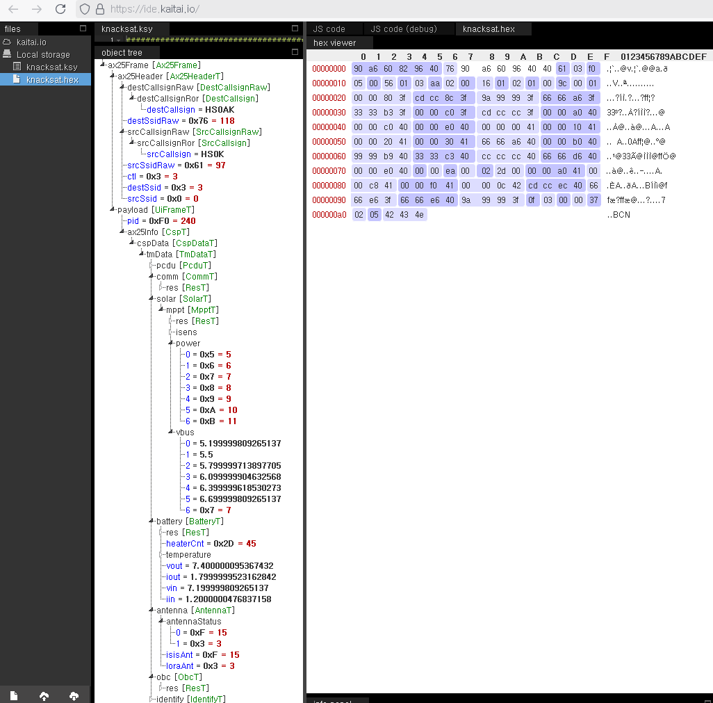

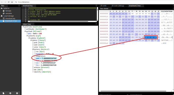

Tested on https://ide.kaitai.io with knacksat.hex.txt (165 Bytes) using knacksat.ksy.txt (8.2 KB) (remove .txt).
Looks impressive.

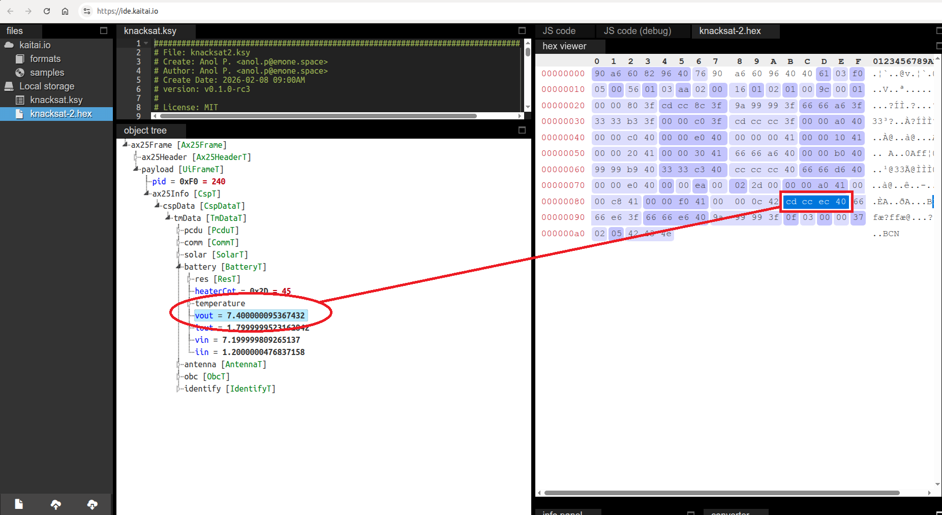

Excellent!
One thing I’ve always liked about the Kaitai site is that when you click on a telemetry item, it highlights the bytes that deliver that value. Really illustrates the role that the hex bytes perform in all these downlink packets.
