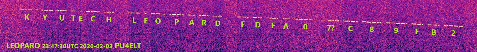

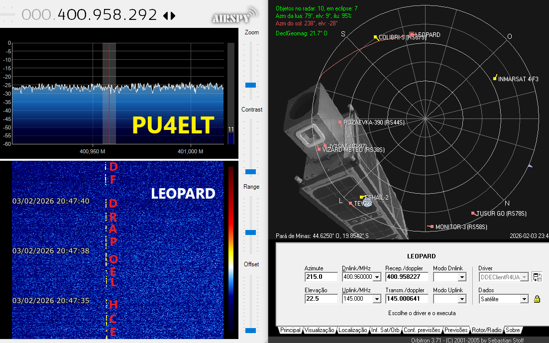

LEOPARD received here in Brazil during its second flight over my QTH (The first was at low elevation to the east… Location with many buildings here)
KYUTECH LEOPARD FDFA07?C89FB2 (23:47:30UTC)
Edit :
Good sign that what I believe to be CoRAL was received here in 401.14… so far I’ve checked 2 packets and both were demodulated.

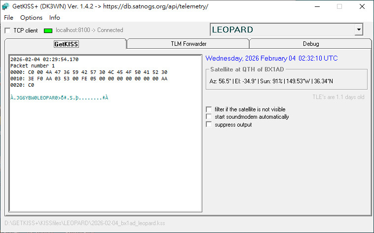

LEOPARD packet received during 00:29U pass, in 4k8 GMSK mode.

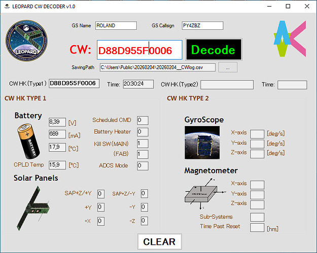

Managed to decode LEOPARD CW beacon partially from this observation.
Looks like there is a much stronger signal at TCA but probably the TLE is way off so the CW is not heard unfortunately.

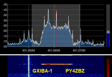

Now with the 15 dBi antenna I received GXIBA-1 with 30 dB SNR, but it doesn’t demodulate in FSK AX100 mode 5, neither at 4k8 nor 9k6… ??? What’s wrong?

Hello! Can you share an audio or I/Q recording?

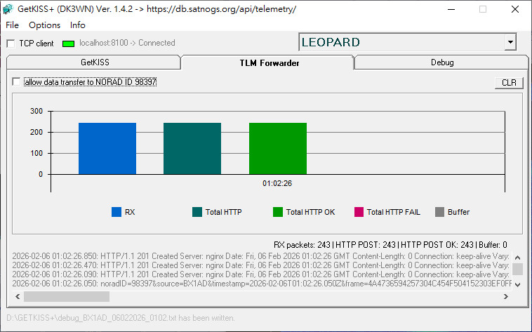

243 packets received from LEOPARD during 22:54U pass, could it be an image transmission?

Certainly appears to be 9k6 baud, but I’m not decoding either. I guess you saw that the left side of the waveform was distorted a bit… I’m not sure if that’s enough to bother things or not.

Hola Roland,
Lots of trial and error to decode even a few GXIBA-1 frames here, as signals RX were weak. But, had recorded an IQ file using GNURadio. Looked for and exported the strongest frames using Inspectrum. Then, converted the IQ snippet to a wav file format using SOX. Under Windows, replayed that snippet (IQ) wav format file in SDR Console. FM wide demodulation. By carefully adjusting the frequency and bandwidth, got decodes using UZ7HO 1KUNS (AX100 Mode 5) soundmodem. See https://x.com/n6rfm/status/2019588630906564869?s=20
