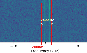

look at this HADES-SA waterfall …
you can custom the value for this variable, based on that waterfall:
USB_FREQ_OFFSET
the start point. because it is on the left of zero, it is negative.. default -900 hz
USB_BANDWIDTH
default 2600 hz
USB_NORAD
default: 68446 hades-sa norad id, add another norad id that you want record audio as USB here separated by space, example:
USB_NORAD=68446 40931 62715 61224

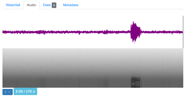

to validate if this add is work, open the observation page, look at audio download
click on Audio, and if you see the filename satnogs_xxxxxx_MOD.ogg, , that indicate it work! congratz!
now open the audio tab, replay, and open your fave modem + decoder
