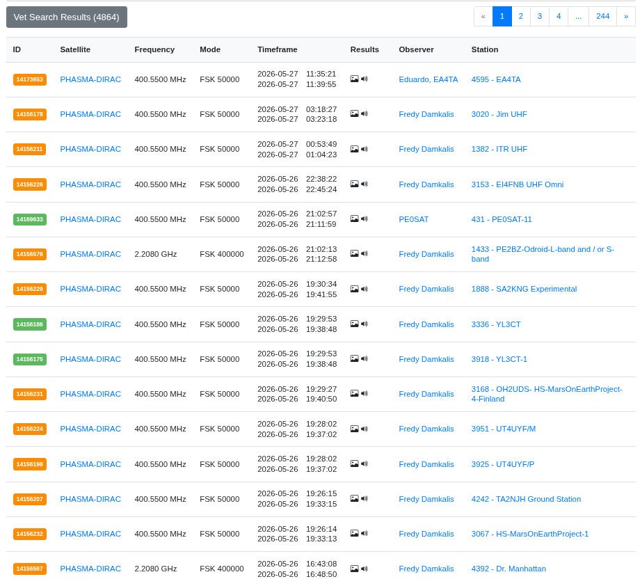

Then sorry to be the messenger of “bad” news as you can see looking at the PHASMA-DIRAC obs, there is no audio being created and/or uploaded.
Yes i saw it. I need to test it as I failed to reproduced it locally. Does for other modes work correctly?
Just changing the filter you could have seen that other obs do have an audio recording.

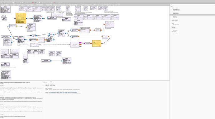

@mpalou brought to my attention that the flowgraph for PHASMA does not have an audio sink and never did fsk_phasma_decoder.grc. Observations with audio must run a older flowgraph version that does not use the specific flowgraph but the generic fsk_ax25.grc which has an audio output or some custom flowgraph.
Look at this query you can see that there was/is audio created.

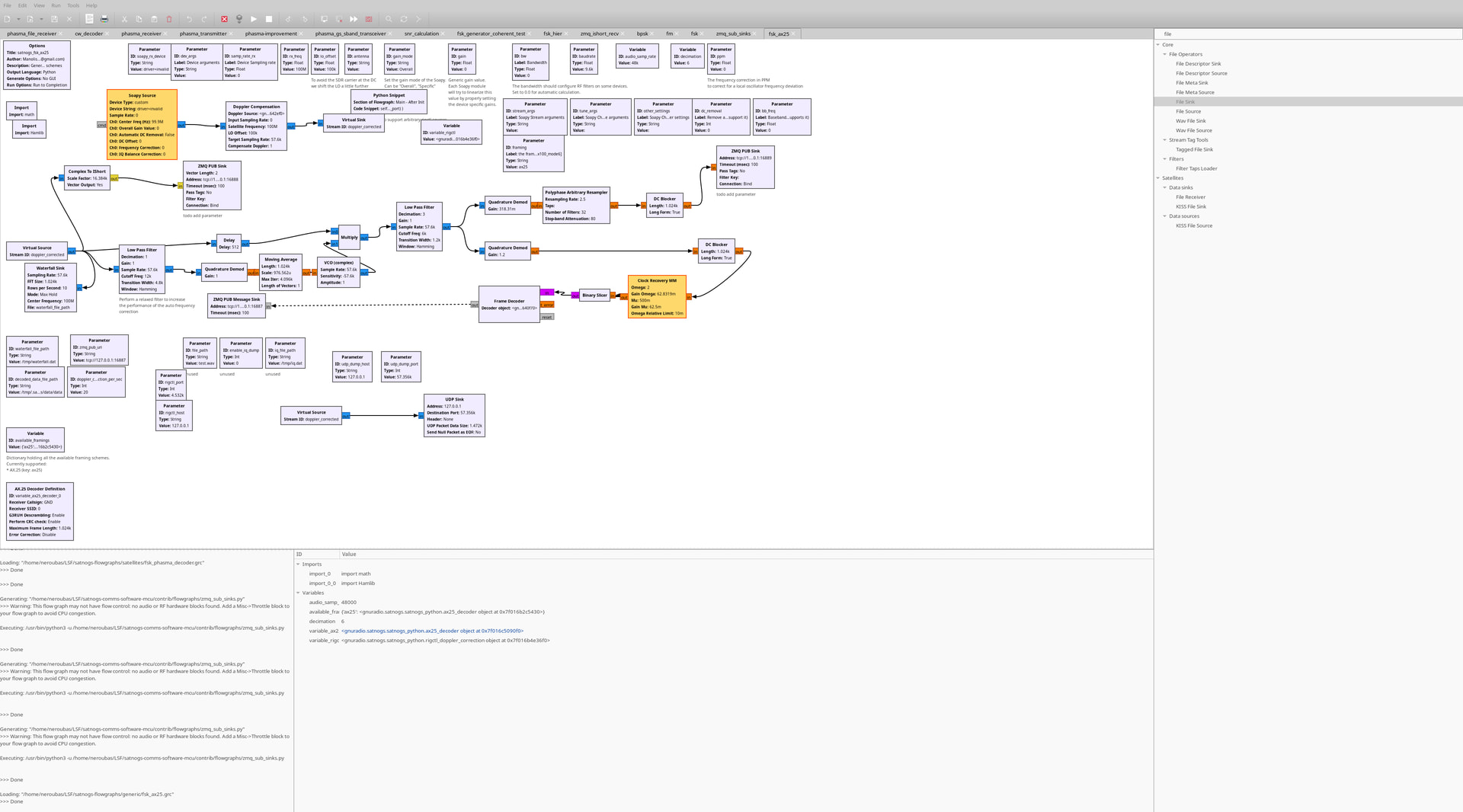

This is an image of the fsk_phasma_decoder.grc
As you can see there is no audio sink
If someone does not have the satnogs-flowgraphs with at least the release 2.1 won’t run the fsk_phasma_decoder.grc flowgraph but the fsk_ax25.grc which has an audio sink.
So there might exist observations, and still be scheduled new ones, with audio file output but in reality the phasma flowgraph never had an audio output.
