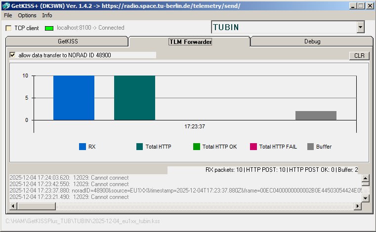

12029: Cannot connect

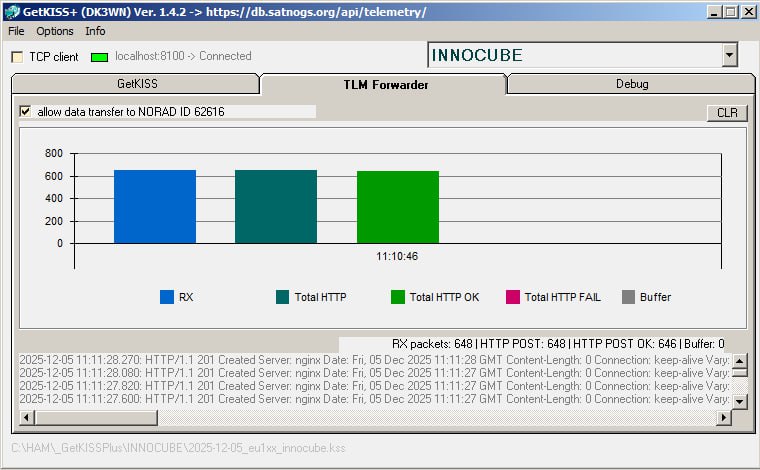

The counter doesn’t show my frames :disappointed_face:

Nothing prevents you from running 1 modem and several instances GetKISS+ at the same time
Of course, GetKissPlus is a client and you can connect multiple to the hs_soundmodem that acts like a server, thinking out of the box, I love it!
SIDS server is now working, thanks @PE0SAT for the testing. URL changed again (now HTTP instead of HTTPS again):
http://radio.space.tu-berlin.de/telemetry/send

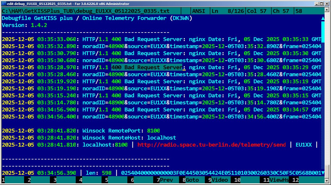

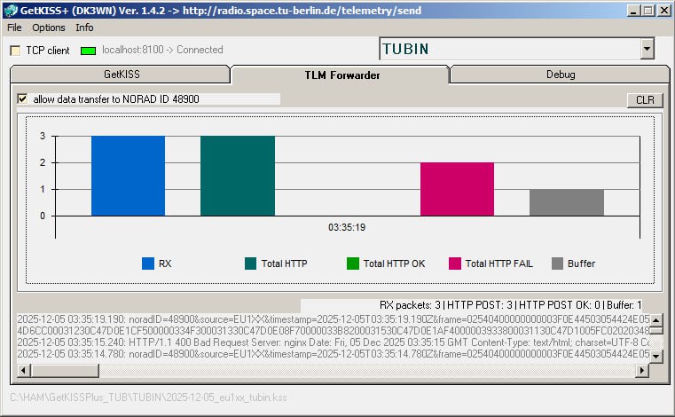

400 Bad Request Server :frowning:

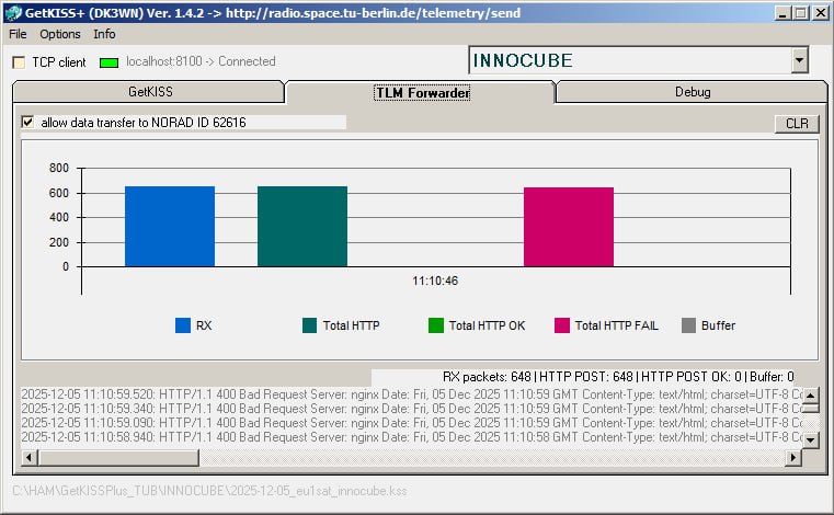

400 Bad Request Server :disappointed_face:
@EU1SAT The issue was found and resolved, please let us know if you encounter more issues.

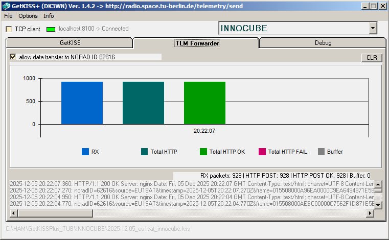

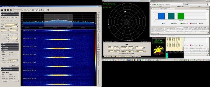

Server work good now!!!
Strong signal!
Server work fine. Perfect!
got this
