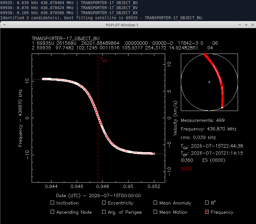

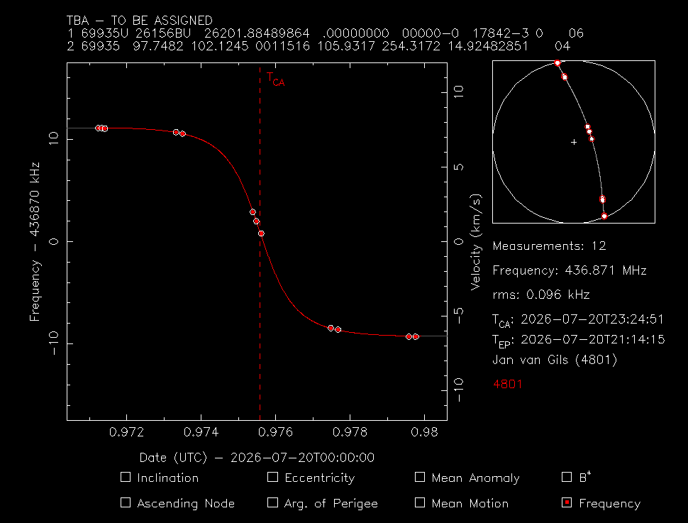

From these TLEs, KOSTKA is probably object BU - 69935, with alternatives 69936 and 69938.
Also KOSTKA will transmit additional periodic CWs over Europe today at 23:25-23:40 UTC.
Based on 2026-156:
KOSTKA: 69935
Alternative:
69936: 0.207 kHz 436.870805 MHz | TBA - TO BE ASSIGNED

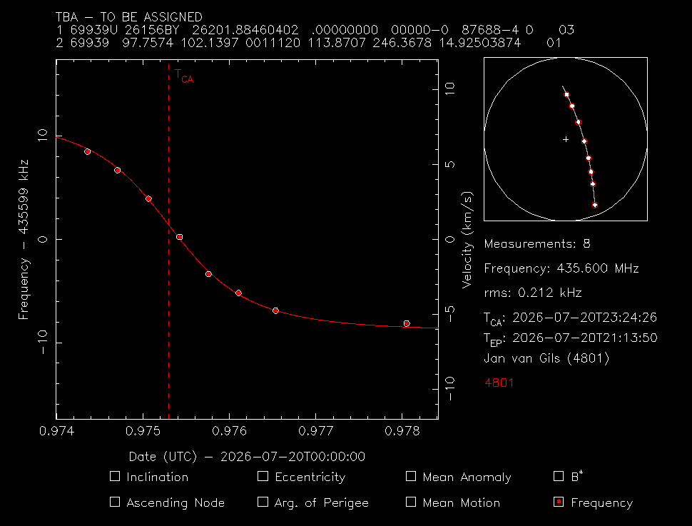

Based on 2026-156:
Unknown: 69939 (one of the Satellites on 435.600)
No alternative:

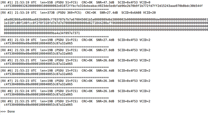

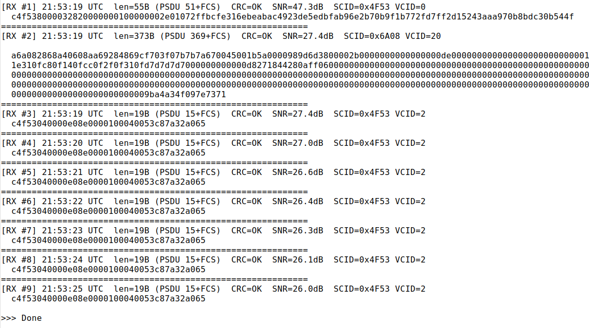

flowgraph_output.txt (5.1 KB)
Sorry - can you please clarify?
So you ARE receiving downlink packets on 402.000 MHz?
What modes / frequencies are you NOT receiving?
Our Astralintu GS is tuned to 402.000 MHz, but we are not receiving any DL packets and we don’t know if our UL commands are reaching the satellite (since we don’t receive back the beacon message that’s supposed to come down in response to the UL command).
Thank you! So these ‘RX’ items in your output are not downlink packets?
Oh sorry! I see the confusion I created by attaching this flowgraph_output.txt file and not explaining it. This file is generated from our factory SW testing using Yamcs SW and SDR (https://www.ettus.com/all-products/usrp-b200mini/) attached to Linux box.
