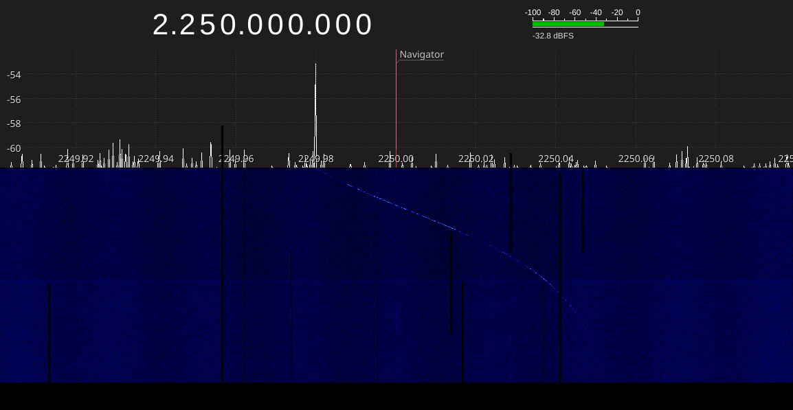

Using this TLE for Navigator:
1 98270C 26156BH  26188.34443476 -.00015589  00000-0 -30982-2 0  9990
2 98270  97.7571  88.7983 0007635 143.1901 230.9775 14.91796255    10
… there was a close match if I ran my computer’s clock forward 5 minutes.
Of course that’s an approximation when simply going by the SNR of the downlink.

See next post, this analysis is invalid it wasn't after 5min but 5min before that K4KDR seen the signals
Very useful info, from a quick check, after 5 minutes there are three objects near the supposed Navigator position, 88207, 88246 and 88248. From them I’ll choose to try 88246 for now, @K4KDR please also try it and let us know if you have better results.

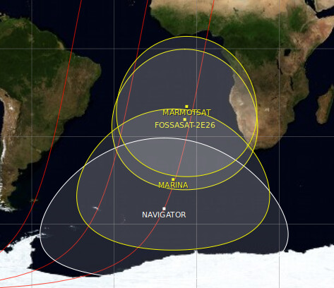

Thanks very much. I feel bad if I didn’t explain properly, but the signal arrived 5-minutes AHEAD of where the old TLE placed it. When I applied this latest update, I noticed that the position of Navigator moved substantially farther back.
I originally spotted Navigator’s signal while tracking Marina, so an update to the TLE based on Navigator’s “early” arrival this morning would, as expected, move it FORWARD up in the area of Marina. Not farther to rear of those T-17 objects.
So sorry if I framed my adjustment poorly!
No problem, thanks for pointing it out, I’m checking now what objects are the best to track by fixing this confusion. :slight_smile:
So, here is the fixed analysis for Navigator base on @K4KDR observation:
There are 4 possible objects, but one of them seems to fit better the 5min difference. The objects are 88265, 88266, 88267 and 88268. The one that fits better is 88267, so using that for tracking Navigator, here is the space-track.org analyst TLE, changed to use temporary NORAD ID:
Navigator
1 98270U          26194.10805992 +.00001318 +00000+0 +13423-3 0 00137
2 98270  97.7564  94.4749 0010526 130.3049 229.9091 14.92372951000866

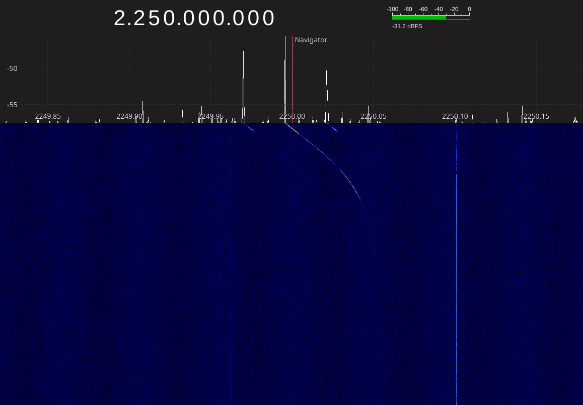

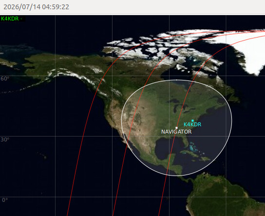

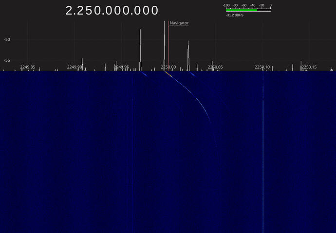

Well thank you again for what turned out to be just some spectacular TLE work.
On tonight’s 38° pass, I didn’t even know if I would SEE a downlink from Navigator. No data sidebands this time, of course, but the center residual carrier was plenty powerful enough to see - given some dish tracking that was accurate enough.
I can’t say if this was dead on or a fraction of a degree off, but either way it’s working very well. Much appreciated!

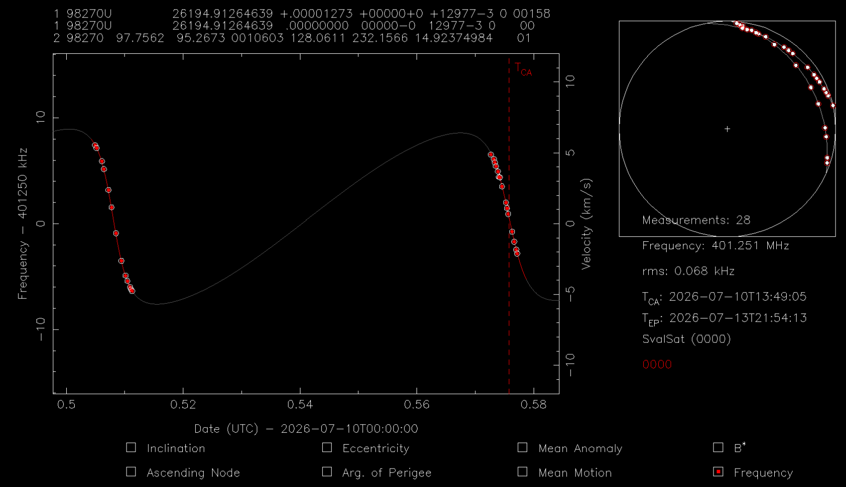

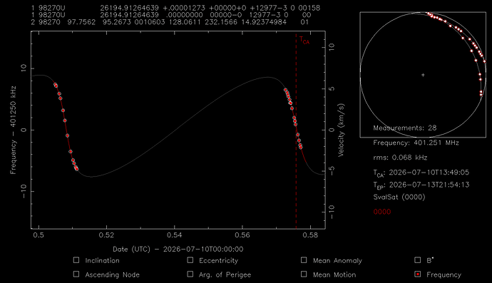

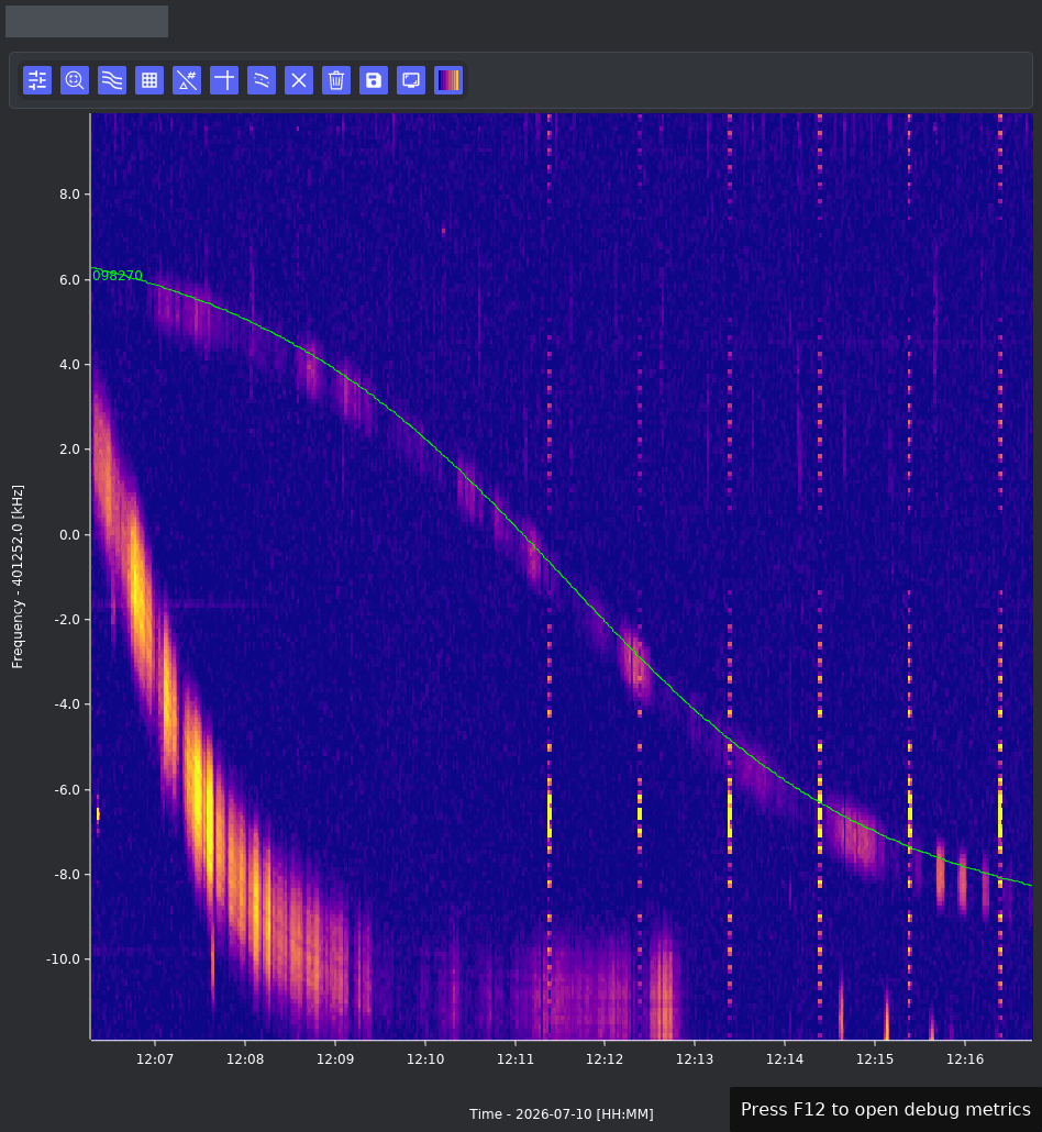

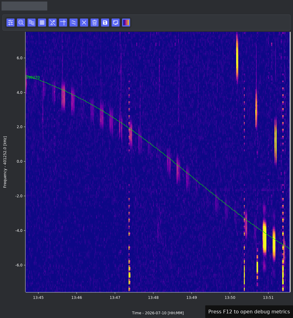

Looks like Navigator is active on 401.25MHz:
Navigator is not expected to transmit on UHF, so probably it is one of the other satellites, maybe one of the LEMUR sats.
I’m going to add it as Unknown 3 T17 in DB and use the TLE we used for Navigator and try to track it:
Unknown 3 T17
1 98255U          26194.91264639 +.00001273 +00000+0 +12977-3 0 00151
2 98255  97.7562  95.2673 0010603 128.0611 232.1566 14.92374984000981
