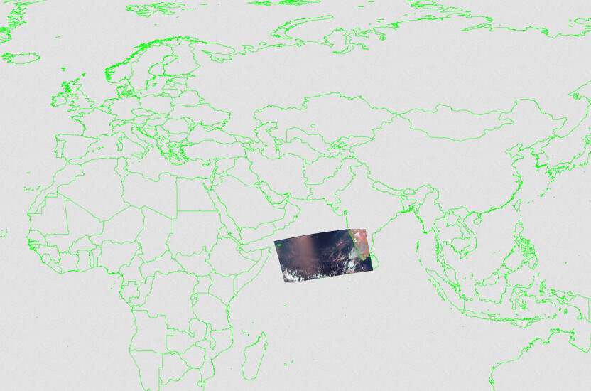

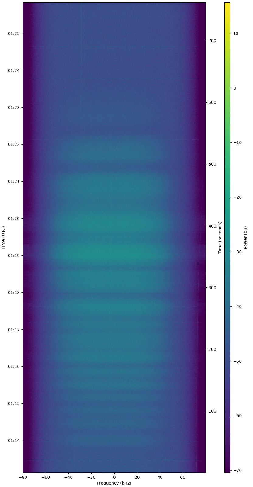

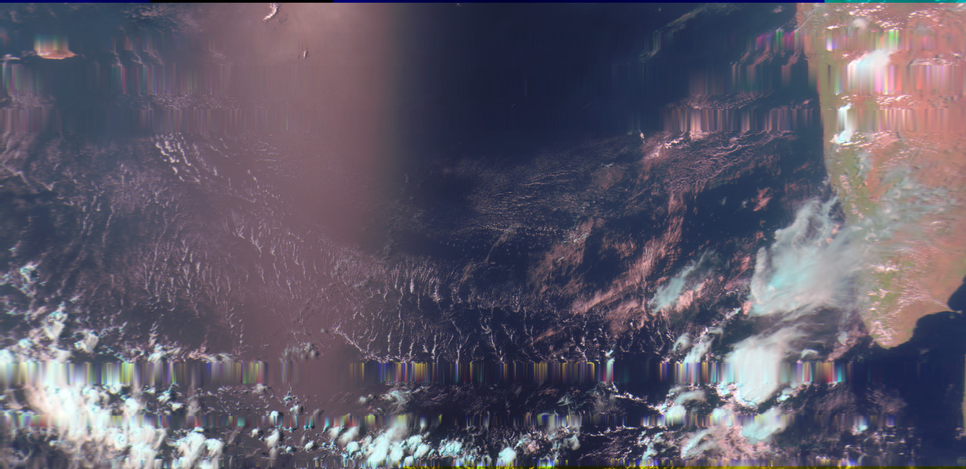

It worked now.
However, since the signal was not strong enough for my horizontal HB9CV without preamp, there was nothing to decode.

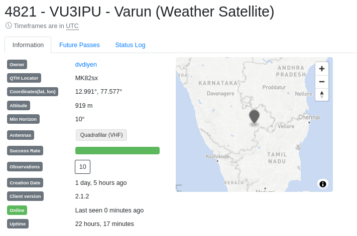

I was struggling to automate the LRPT. I had to install multiple times. Finally, figured out the method that works. Thanks to @bali and @PE0SAT for the inputs. @bali your frequent inputs deserve to be highlighted.

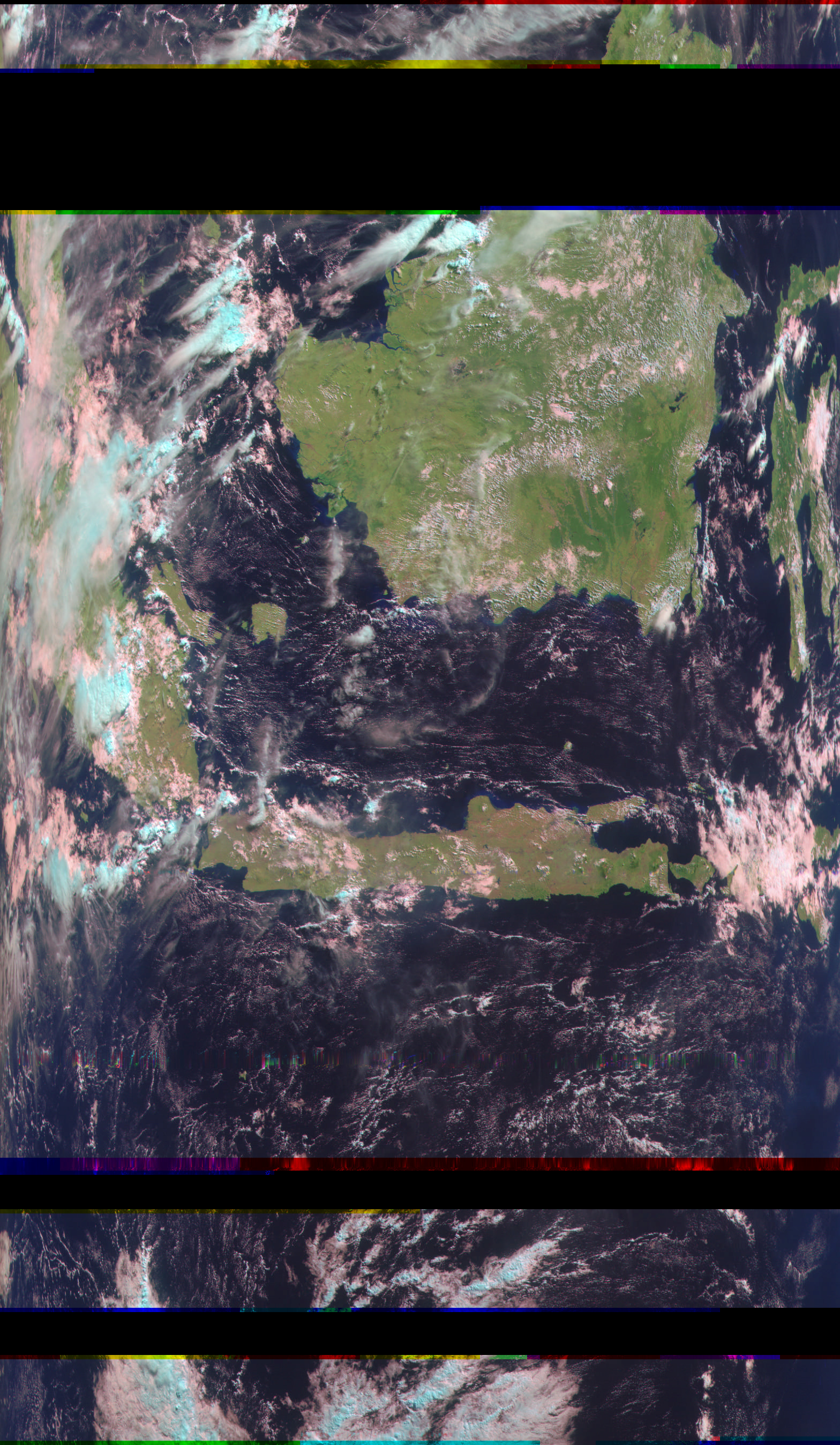

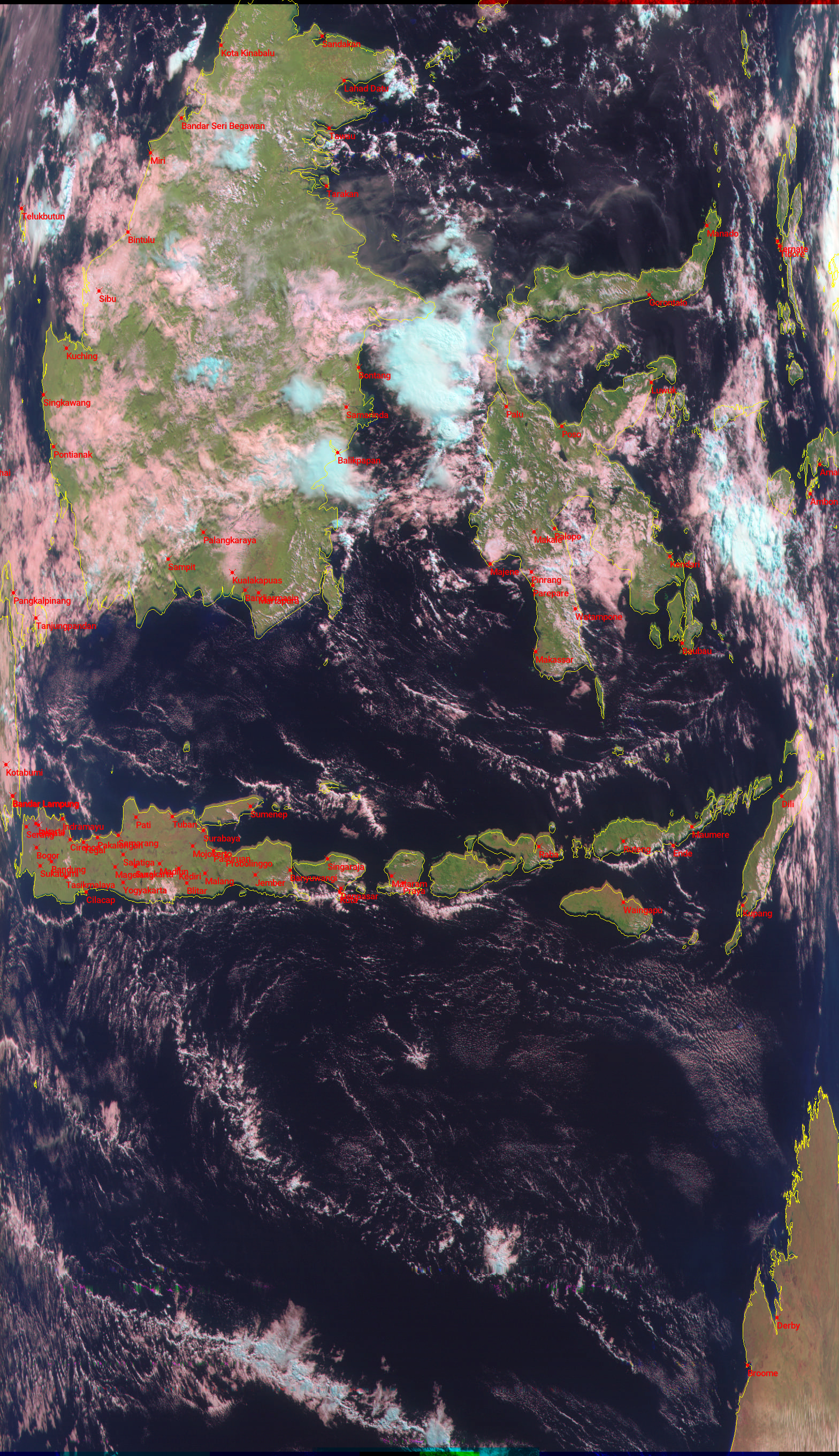

put here for archive. wonderful ground station:
source: https://network.satnogs.org/observations/14251745/
antenna: V-Dipole 137 Mhz
