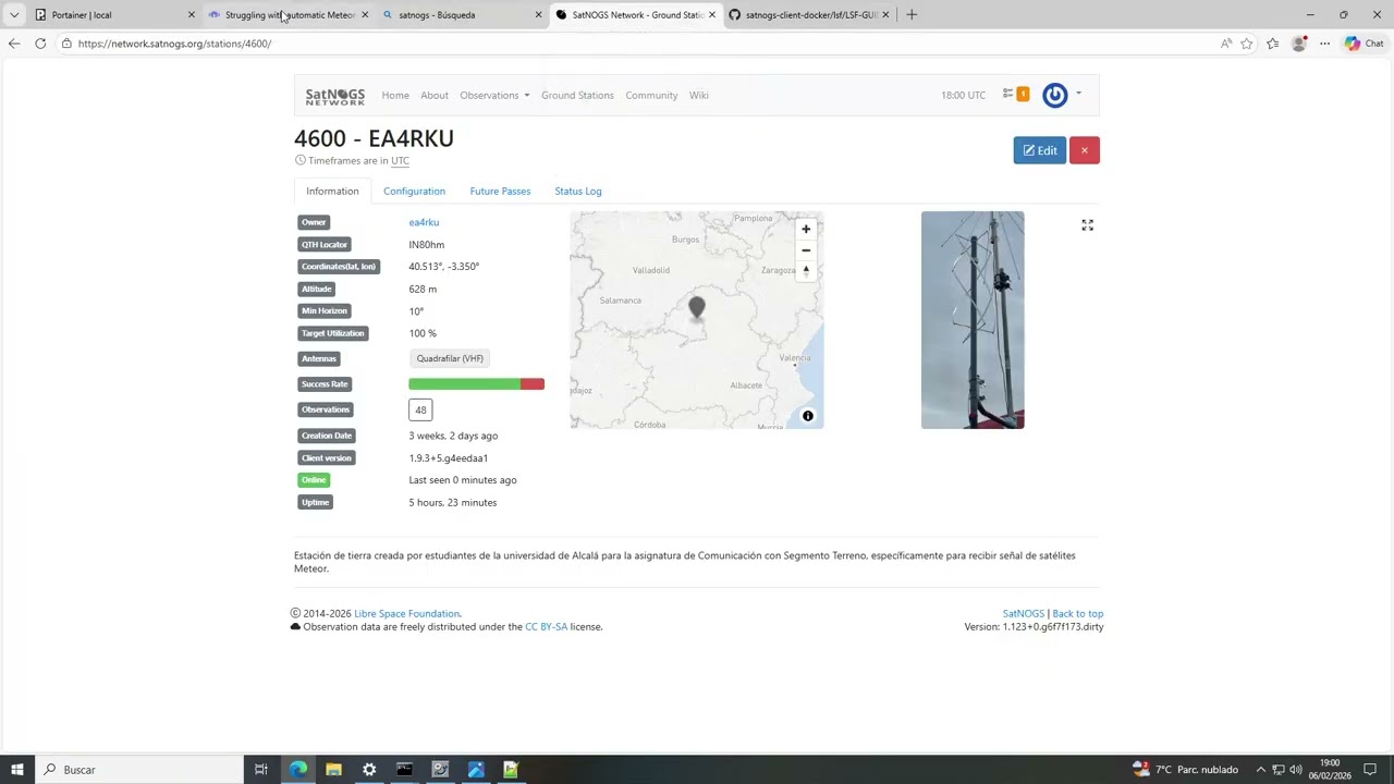

I am preparing a 5 mins video. Please stay tuned. In the meantime:
ea4rku_conf.txt (2.4 KB)
See attachment with docker-compose.yml and station.env
Thank you a lot!!!
I hadn’t set ENABLE_IQ_DUMP and IQ_DUMP_FILENAME… Of course, that’s what you need now. Let’s see if it works now!
Check this out. Sorry for the rush. I hope that you can understand the logic behind. Good luck and keep me posted.

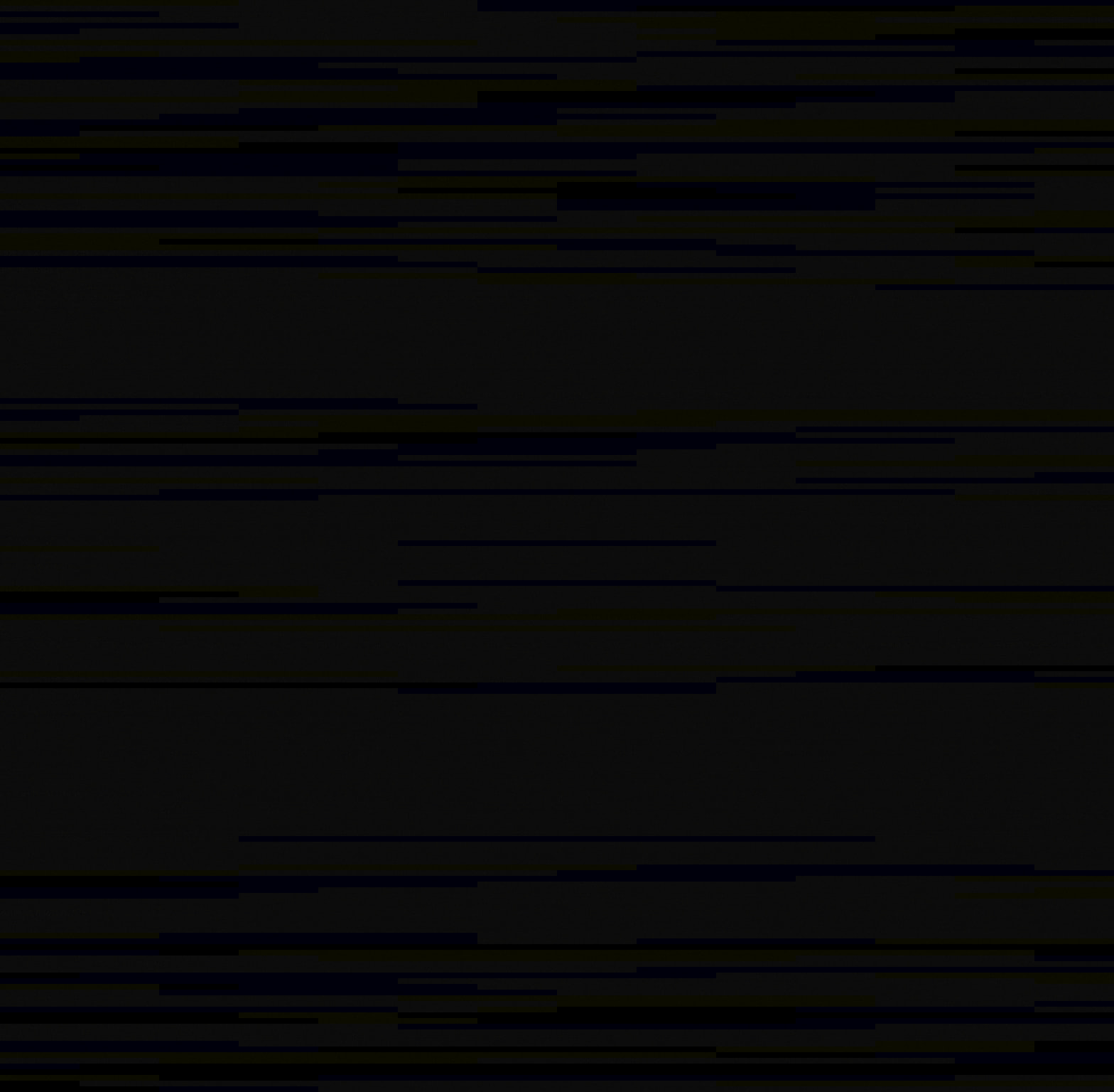

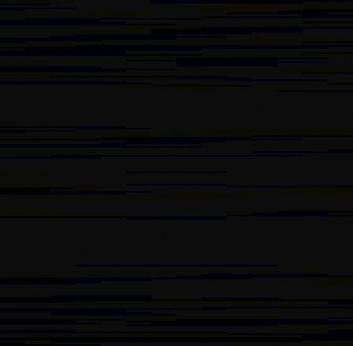

Hi guys! I’ve been struggling with the same issue, but I managed to get it to upload data. Could you help me figure out why I’m getting black images? Is it because the pass was bad, or is the gain too high?
Observation #13449924
Observation #13449922
Observation #13447111
the first one (short) did seem to have a little of an image) the other 2 large dark, is probably night time? I had that the first few times I was trying to get an image its frustrating. Hope it helps.

OK making progress:
mounted the usb drive and now decodes are working (note it was dark / night!)
and now I fixed the upload of png so its in the web / portal see link below (pats self on back and goes to bed)
