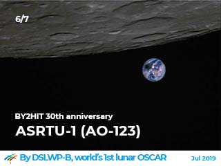

SSDV fm RS64S (ASRTU-1)
17Dec25 1214Z 25E FN41iq.
Excellent quality images!

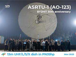

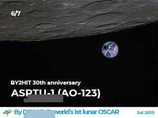

Small image snippet received by my SatNOGS #3538 station (See the observation HERE)
Unfortunately, my Yagi 4El couldn’t receive much (I wasn’t home at the time of the pass, so I couldn’t manually point it with another setup).
i’m downloading both now. on progress :smiley:
Congrats! Your 20-55-08 recording generated a very nice image. Will check the next one in a few.
… and the 20-49-54 image not quite as complete, but still a great capture!
superb groundstation!
decode using gr_satellite v 5.8.0
@K4KDR and @Bali - Thank-you both very much!! The secoond image was weaker, so I expected drop-outs.

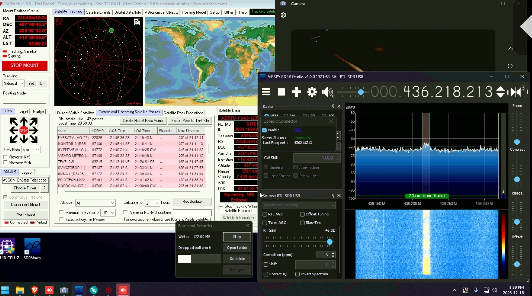

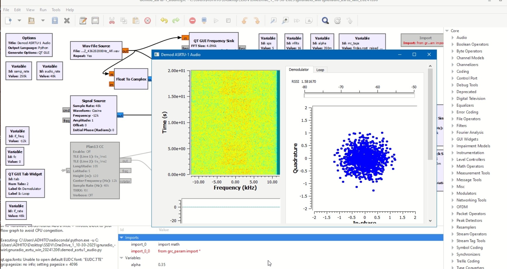

Any input on how to decode the SSDV transmission “manually”?
I usually get audio files from my SatNOGS station and feed that to GNU radio with no issues. Last night I tried acquiring the transmission with the newly installed radio telescope/rotator and getting what I assume a nice signals.
From what I read from early post here, it uses USB 24k bandwidth but no matter I do it never getting any lock and decode the frames.
*ps: nfm on the screenshot is not for what I use for the audio recording
Let me know if IQ file is needed to test the decoding.

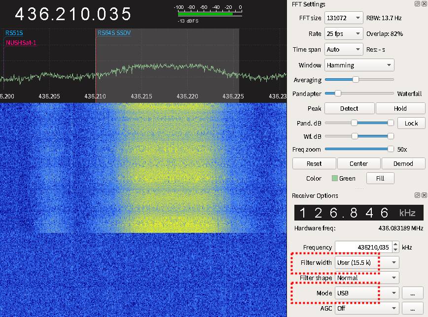

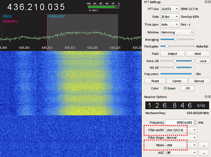

Do you mean by “manually” live on pass or afterwards from a record?
If you see the signal on the waterfall, just set about 15 kHz USB like on this screenshot.
And feed the audio as described in my first post on this thread.
Sorry for really late reply. Yep, I saw your post and tested from 24kHz and 30kHz and no success. Haven’t tried 15 though. @bali finally able to decode the image from the IQ file though. Thanks
