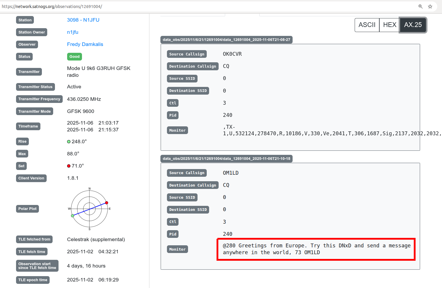

Here is an observation over the Eastern U.S. this afternoon that was obviously uploaded elsewhere w/ a delay included.

And CEVROSAT-1 hears even better than LASARsat.

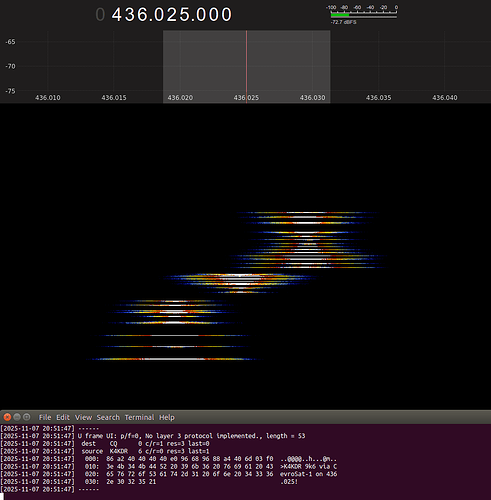

Quite a mystery… today I even ran my 9k6 uplinks thru the 80w RF amp (input level put me at 70w out) and still no luck. My ‘no antenna’ SDR nearby confirmed good 9k6 decodes and even illustrated my reverse-doppler adjustments during the pass. Don’t know, but have a higher CEVROSAT-1 pass tonight so I’ll keep trying!

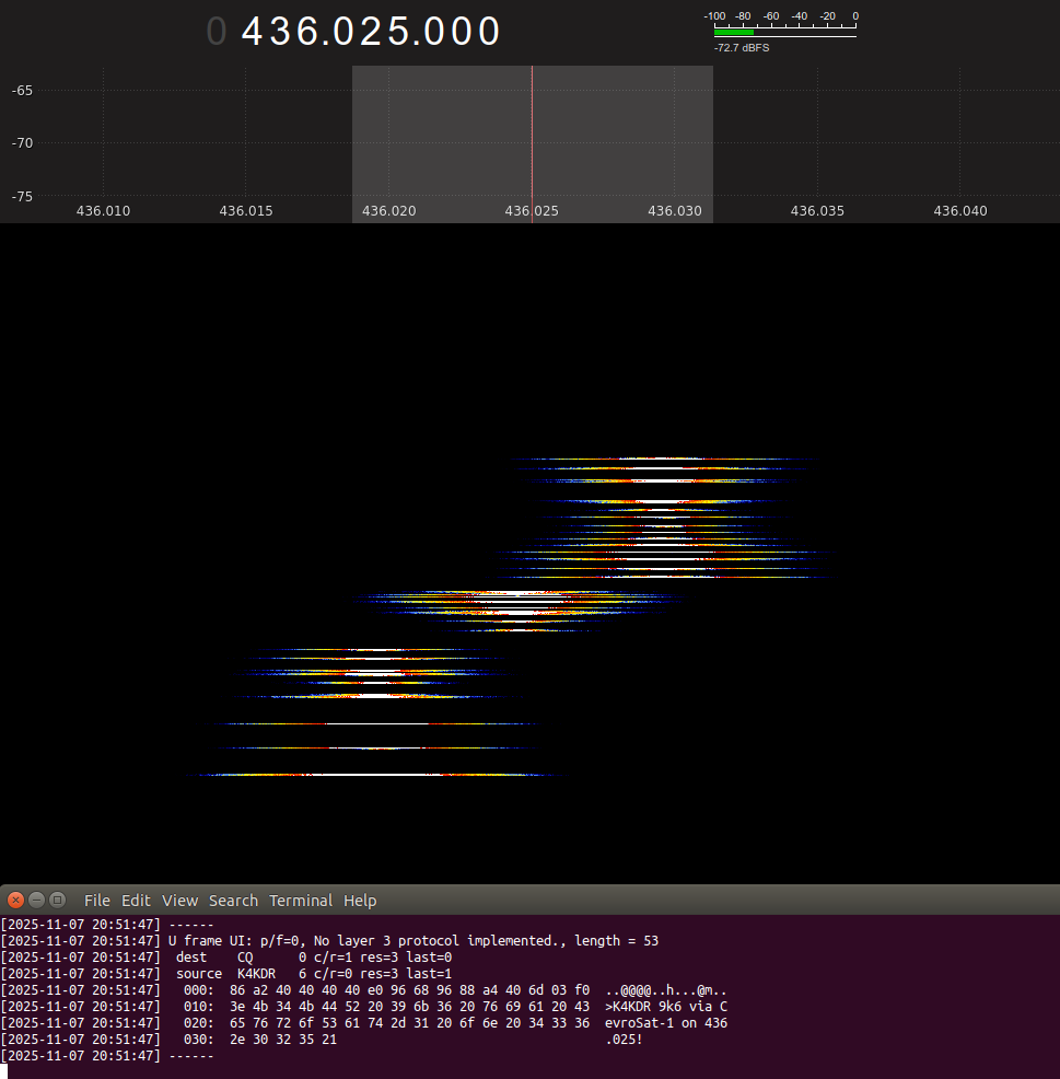

I’ve compared your frame to mine.
Apart from your SSID 6 (mine is 0), my c/r for the source callsign is 1, yours is 0.
source DL7NDR 0 c/r=1 res=3 last=1
I cannot imagine that this could be a problem for CEVROSAT-1, but if you like to try c/r=1, then modify your frame to
86 a2 40 40 40 40 e0 96 68 96 88 a4 40 ed 03 f0
You don’t have to add an info text.
Inject it into direwolf using
echo ‘c00086a240404040e096689688a440ed03f0c0’ | xxd -r -p | nc -N 127.0.0.1 8001

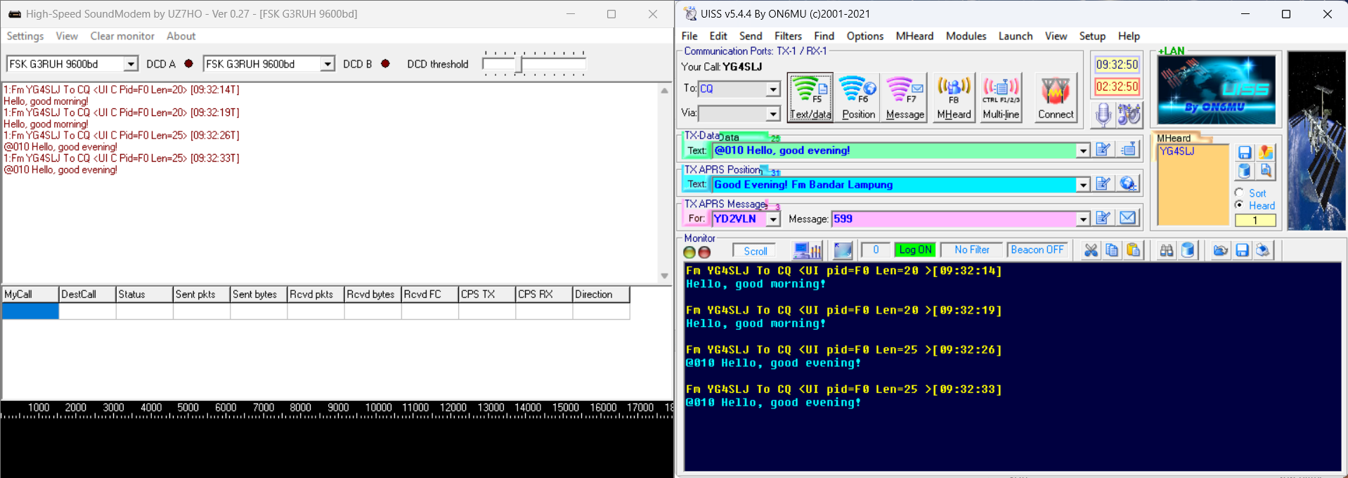

I read up from JI1IZR’s blog post on how to use the digipeater from GRBAlpha and Cevrosat’s website on using DNxD system and these setting should be correct it seems?
I’ve not had any luck, either, but plenty of stations have.
HOWEVER, it appears to be offline for the past 24-hours or so. Nothing heard over the Eastern U.S. tonight either.
That’s correct.
Yes, CEVROSAT-1’s website explains it pretty well.
If you send without @xyzxyz, then the respond would start like YG4SLJ to CQ via OK0CVR-7.
If you use DNxD, then your message would retransmitted starting with YG4SLJ to CQ via OK0CVR-8.
To be able to receive your own DNxD message, you should choose for example @001 or @097 for the following pass.
