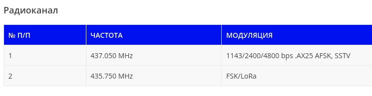

get information from here

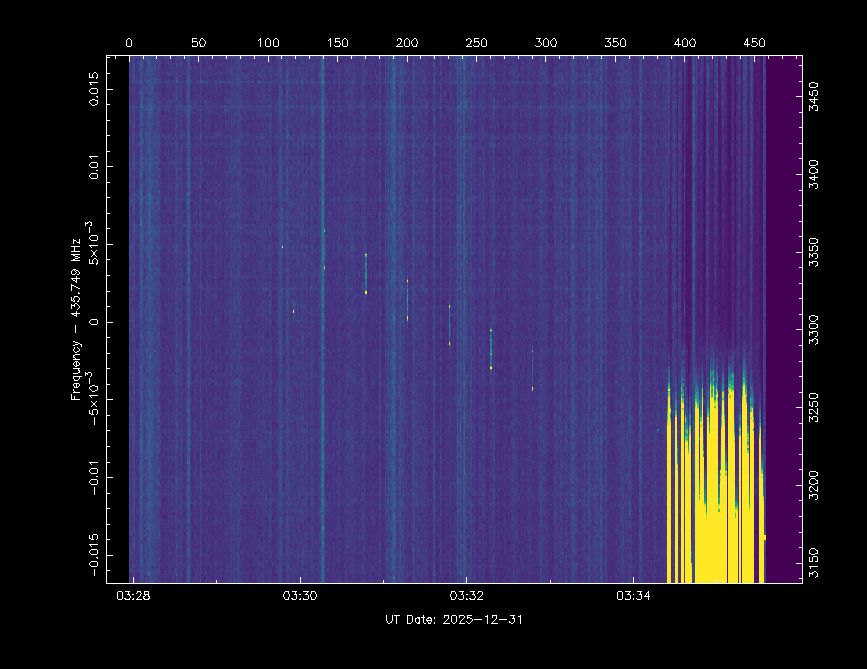

got two observation
2025-12-29 UTC
2025-12-31 UTC
seen like fsk with 2k4 bw

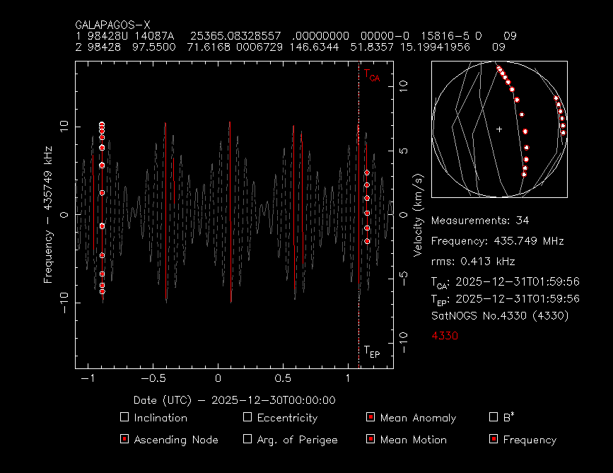

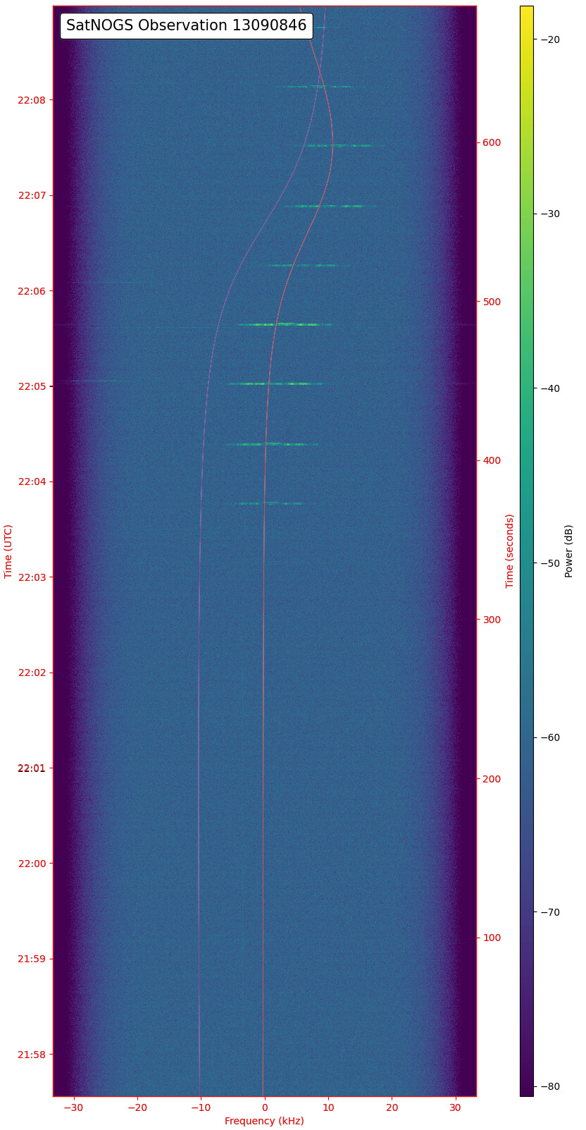

make TLE based on 435.750 Mhz from above obs and test it using ikhnos (437.050 Mhz)
seen it same satellite / tracks. i add X at the end name of satellites just to test it before add to DB.
GALAPAGOS-X
1 98428U 14087A   25365.08328557  .00000000  00000-0  15816-5 0    09
2 98428  97.5500  71.6168 0006729 146.6344  51.8357 15.19941956    09
