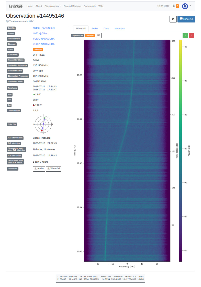

Hi everyone,
I am operating station 4950 (jp7dvx) in Hirosaki, Japan. Since setting up this station, I have been unable to decode any signals successfully.
Currently, I am using an indoor antenna due to my environment, which I suspect might be the main limiting factor. I would appreciate any advice or feedback from those who have experience with indoor setups.
  • Are there specific satellites that are easier to start with in an indoor environment?
  • Are there any configuration tips for a Ground Plane antenna indoors?
Any suggestions would be very helpful. Thank you for your support!
Best regards, Yukio Nakamura

Also I looked at your most recent observation and it looks like your gain value got reset.

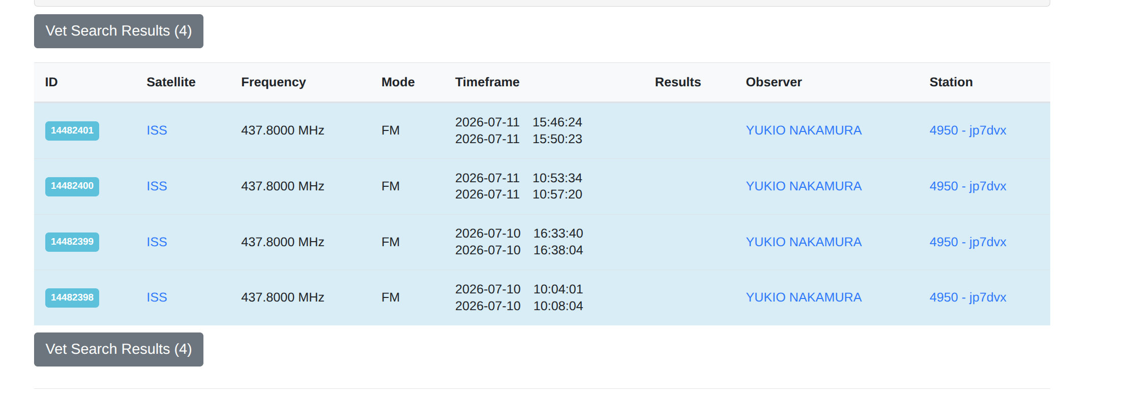

Hi everyone,
Thank you all for the quick and encouraging feedback!
Following your advice, I have just scheduled several observations for the ISS (437.8000 MHz FM) to test my current setup. I will try to position my antenna closer to the window as suggested to see if I can overcome the signal attenuation.
Attached is my current schedule for the upcoming passes. I’ll let you know how it goes!

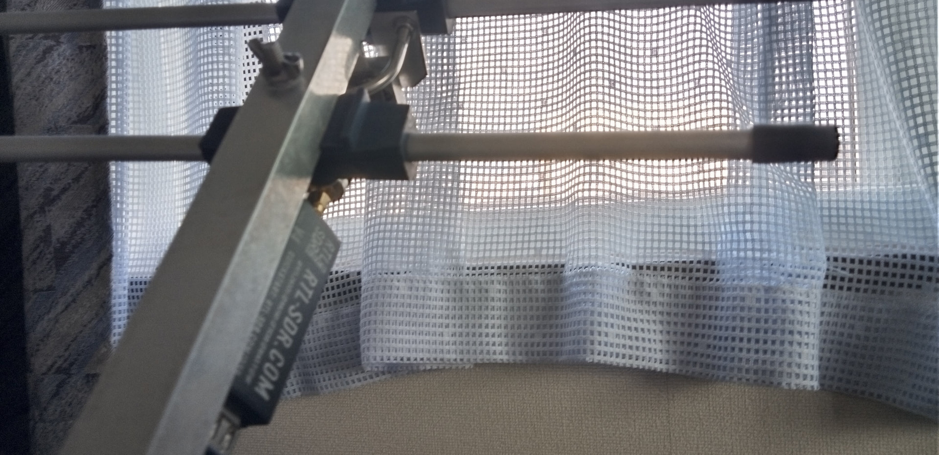

Also if you want you could open your window to possibly improve signal.
Thank you for the advice! I’ve moved my NAGARA DO-28 antenna to the window. I’m keeping the window open but with the screen mesh closed to keep the bugs out. I hope this helps improve the signal while keeping my room comfortable. Let’s see how the next pass goes!

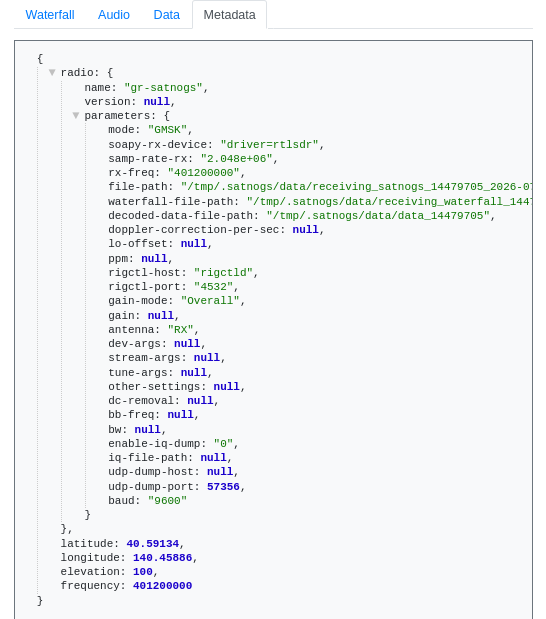

hi @jp7dvx you should check above:
look at
try increasing this value. for rtl-sdr can maximize to 49.6
look at variable SATNOGS_RF_GAIN of your setup
#Supported gain values (29): 0.0 0.9 1.4 2.7 3.7 7.7 8.7 12.5 14.4 15.7 16.6 19.7 20.7 22.9 25.4 28.0 29.7 32.8 33.8 36.4 37.2 38.6 40.2 42.1 43.4 43.9 44.5 48.0 49.6
SATNOGS_RF_GAIN=49.6
Thank you so much for checking the logs and the advice! I missed the RF gain setting. I’ve just updated my docker run command with ‘SATNOGS_RF_GAIN=49.6’ and restarted the client. Looking forward to seeing the difference in the next observation!

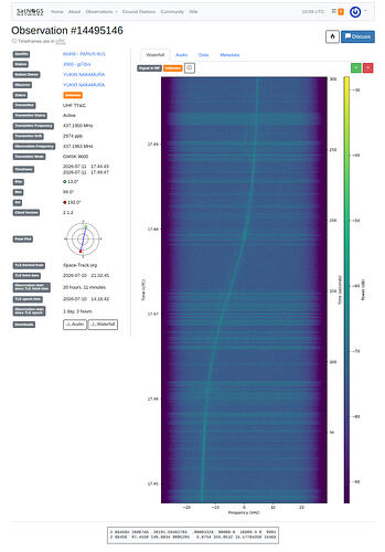

Thank you for this wonderful badge!
However, sitting here in my indoor-antenna shack and still struggling to stably decode the ISS, I feel a bit humbled—almost like an amateur wearing a pro jersey.
That said, I’m planning to refine my approach, starting with building a compact 70cm antenna to step up my game. I would love to keep learning from everyone’s wisdom here. Thanks again for the support!
