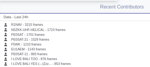

and the result:
with this secret sauce, and with all your best antenna setup lna etc, im sure your decoded frames will increase significantly and better than mine. :smiley:
