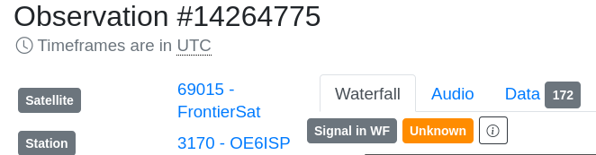

Observation 14183111: FrontierSat (69015) - Why is there no data demodulated?
Hi, it’s not clear for me what the issue is, but decoding of FrontierSat and similar fails constantly in satnogs, whereas the same signals can be decoded with gr-satellites. So it seems there is something wrong in the flowgraphs.
Stefan / OE6ISP
OK I ll take a look
… but there must be something else necessary for success. - something must be special with your station :slight_smile: . I have already activated gr-satellites, but still no deocde, even with a very good signal https://network.satnogs.org/observations/14251741/

and the result:
with this secret sauce, and with all your best antenna setup lna etc, im sure your decoded frames will increase significantly and better than mine. :smiley:
Still curious to see if we can pinpoint the issue in the default installation/configuration.
SatNOGS as an audio distributor is good, but SatNOGS working with full decoding is way better. When services half-work, it’s tough to trust anything from them.
As always, huge fan of SatNOGS! Hope someone with a little more time at the moment can try to get to the bottom of it.
Many thx @bali for sharing your secrets - I very appreciate it :slight_smile:
As I can see, I need to upgrade my know-how about how to handle the docker-environment - that’s kindof black magic for me. But I am on the way.
Thank you & 73
Stefan / OE6ISP
Wow - that works amazing now! many thx for your great support!
73, Stefan/OE6ISP
