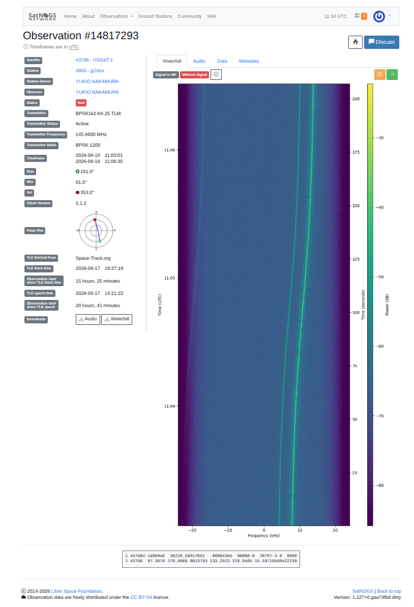

Hi everyone,
Thanks again to all for helping me get my RTL-SDR-only station running smoothly!
I have a quick question regarding RF gain adjustment. Looking at my recent observations (like ITASAT 1), the background noise floor seems a bit high, sitting around -70 dB.
Currently, I’m using SATNOGS_RF_GAIN=38.0 with an RTL-SDR Blog V4 and a omnidirectional GP antenna. For those of you running a similar setup without a physical rig, what gain value or strategy do you usually recommend to get a cleaner noise floor?

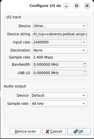

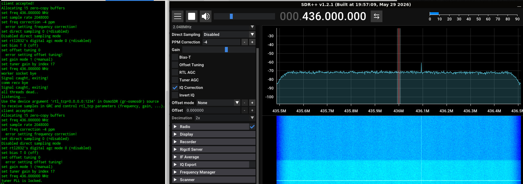

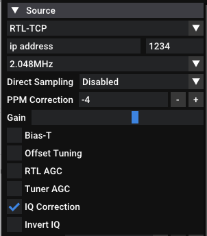

Use a SDR program and scan the bands you want to receive to find the ideal gain value.
You can also use rtl_tcp -a 0.0.0.0 and connect to the system remotely. There are multiple SDR programs that give you the option to connect remotely. SDR++, SDR#, GQRX etc.
GQRX Example:
rtl_tcp=<remote ip address>:1234,psize=16384
SDR++ Example:

Hi PE0SAT,
Thank you so much for the detailed and insightful guide!
Since my mini PC is running headless without a local monitor, using rtl_tcp to connect remotely from my desktop PC using software like SDR++ or GQRX is a brilliant solution. It will be a fantastic way to inspect the spectrum visually and dial in the ideal gain value.
I am going to set this up right away and give it a try. Thanks again for pointing me in the right direction!
