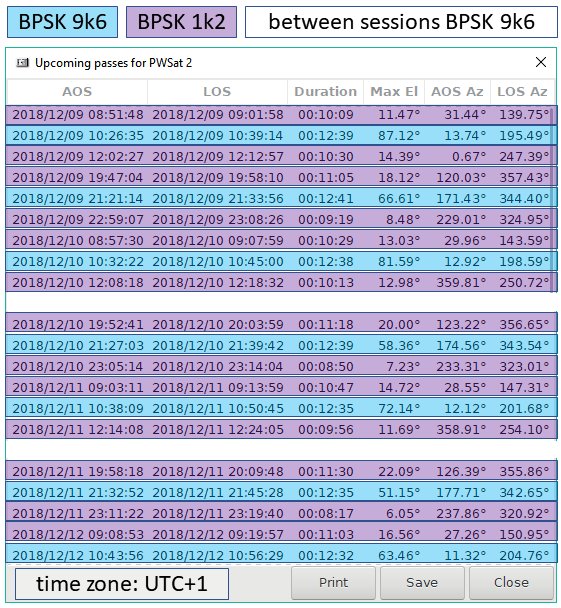

We’ve decided to stay on BPSK 9k6 for most of the time. We’ve finished commissioning of the satellite and now entering experiments phase, so we’ll demand more energy and higher baud rate is one of the energy-saving method.
Find out more:
Hi!
I think that we should remove 1k2, 2k4, 4k8 bps modes from the list - we’re using and will be using in the future 9k6 only.
