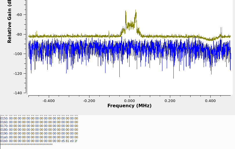

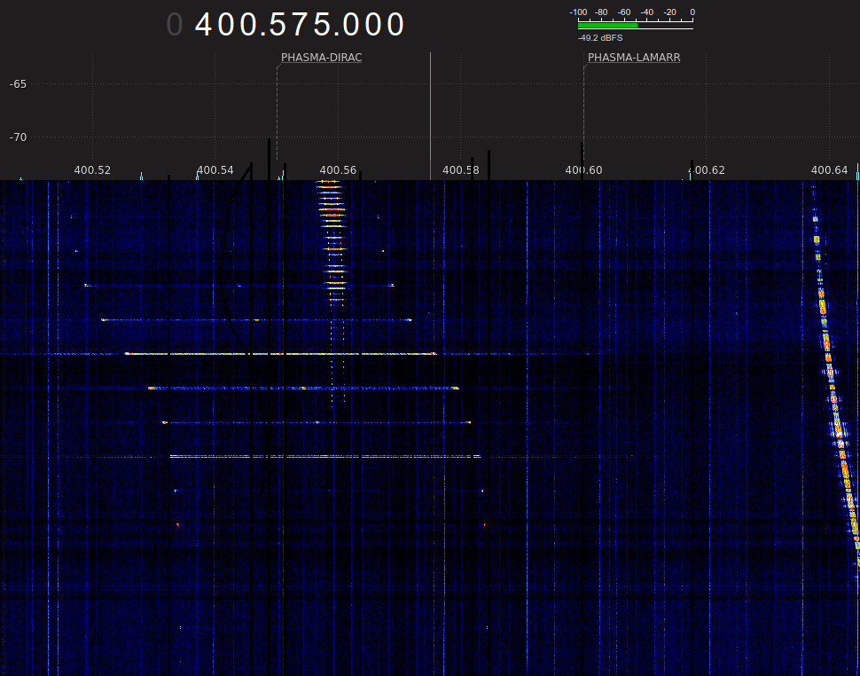

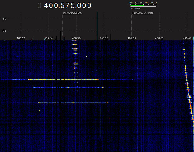

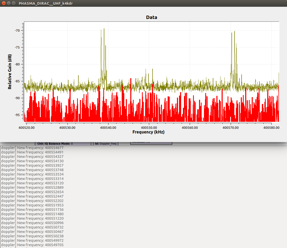

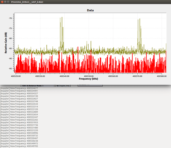

DIRAC continues to look very strong tonight w/ a 30-sec interval between packets. Nothing seen from LAMARR.
Even w/ the good SNR, I can still only get decodes (I/Q replay) w/ the CRC-check disabled.
Great to see at least one of them working well!
Question related to my decodes, please.
Is anyone getting decodes from the satellite that DO pass the CRC-check?

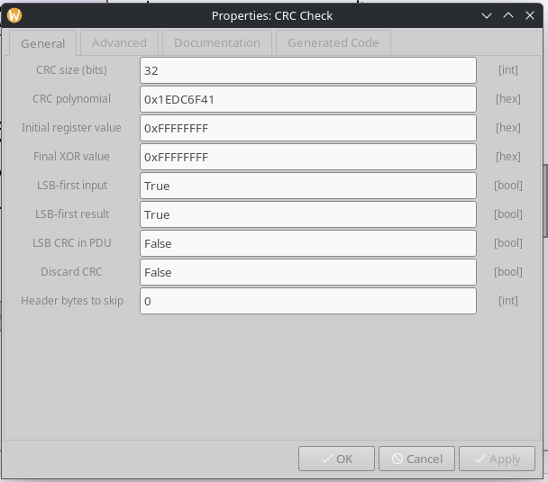

If so, can you please share a screen shot of the values being used in your CRC-Check block?
Thanks @K4KDR!
In mission’s ground stations we also get CRC fails but we also managed to get several good frames.

@K4KDR these values should work. From your IQ i see that there is some frequency drift. Is the signal not doppler corrected?
Thank you very much for the CRC settings! Mine match, so it’s very probably just an SNR issue on my end.
I was not attempting any Doppler correction in these early days after deployment since I was in ‘search’ mode to locate & characterize the signals. All of my decodes are on replay after the Doppler offset of each bursts of packets was determined.
Going forward, I have added a Source Block to GNU Radio for my Airspy-R2 SDR with doppler correction and will start decoding & uploading to SatNogs “live”.
As for the CRC errors, of course the higher the baud rate, the more SNR is required for 100% clean decodes. It seems highly likely that that’s all I’m dealing with here on PHASMA-DIRAC.
Thanks again for the help!

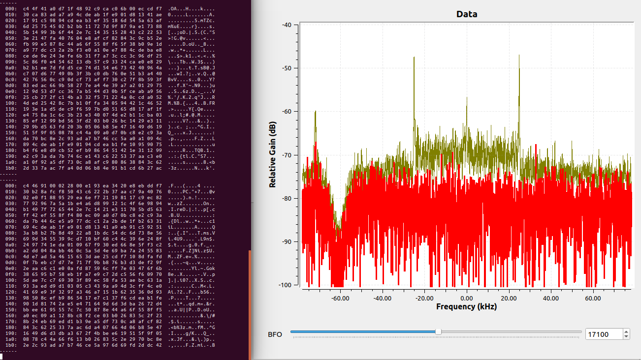

Hi Scott,

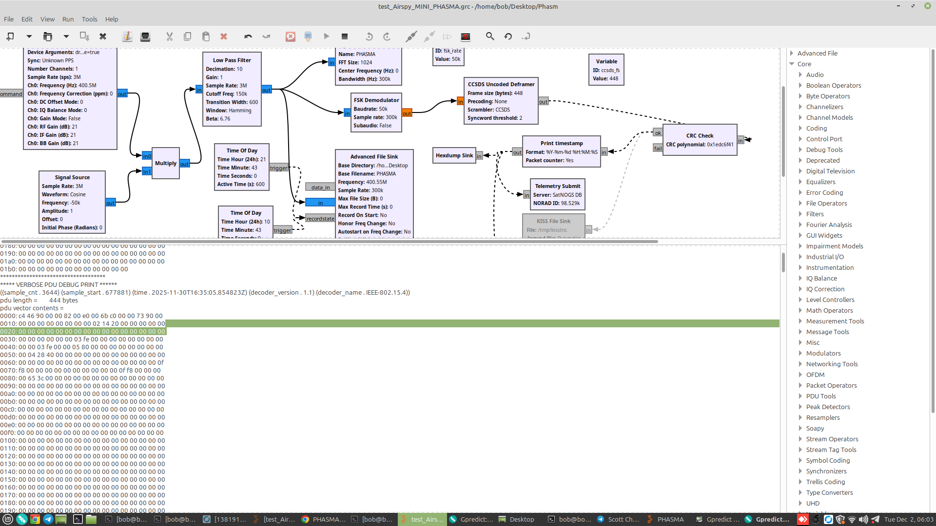

After some very strange GNURadio behavior and using the SigMF recorded by PI9RD I was able to decode some frames.
After removing the CRC Check block and the adding it again I got different behavior and decoded frames. I will share the full IQ and latest flow-graph at the following location.

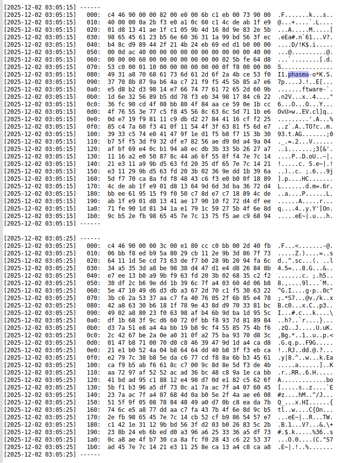

Thanks for all the info, Jan! As for the FSK Demod, CCSDS Deframer, & CRC Check blocks, everything is identical here. So, I’m comfortable that it’s just a signal quality issue on my end. Pre-launch, I got clean decodes from the sample file that was provided, so I’ll hope for a bit more SNR down the road.
Replacing the CRC Check block was my solution, I guess coping blocks out of other flow-graphs isn’t such a good idea.
I wonder if adding a FIR filter would also help in getting better results but I haven’t been successful in creating these blocks, some lack of knowledge and experience,

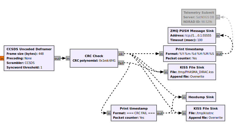

I just updated my output flow to only send frames w/ good CRC to SatNogs, but I’ll flag failed packets & display them locally for my own info.
(updated image below to NOT add ‘CRC FAIL’ stamps to .KSS File Sink)

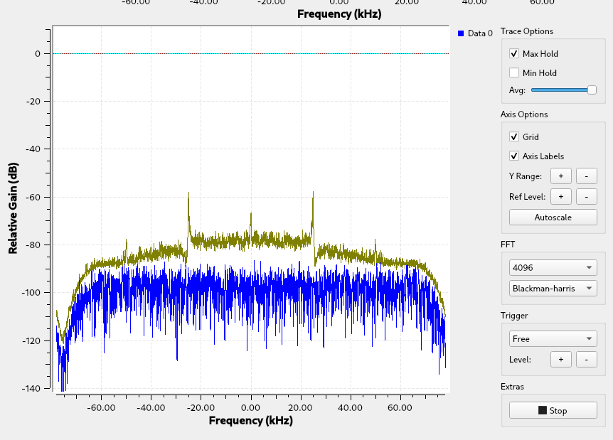

Using the SDR Source within GNU Radio (w/ doppler correction) worked fine on the DIRAC pass tonight… 15db and greater SNR. Was hoping for ‘live’ decodes for upload to SatNogs, but unfortunately, while numerous frames were decoded, not a single one passed the CRC-check.
Scott, do you happen to have a recording?

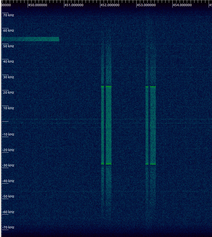

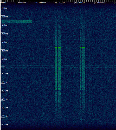

The file is so large… I made a smaller file of the strongest packets:
Thanks Scott, this looks pretty good, but indeed no valid CRC
Phasma-Dirac decodes. 12 frames in real time with CRC check. RX in EM12jw. After several failed attempts, chose to increase input bandwidth of demodulator to 300k sps. Tks project team, PE0SAT and K4KDR for flowgraph hints!
