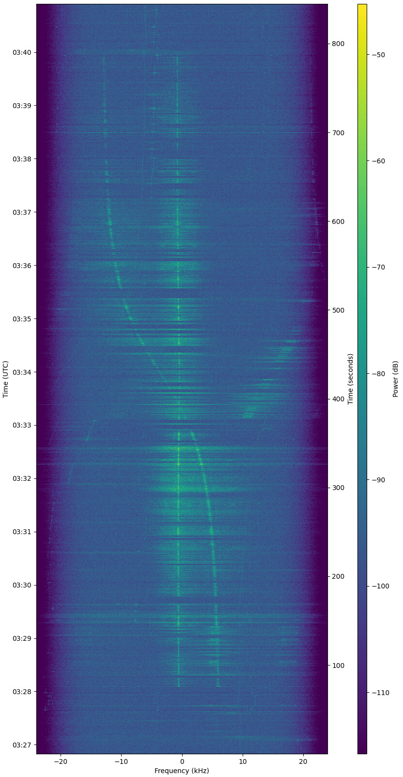

base on this obs, is the second signal is example of what you say as aliasing? i check the raw file and signal is not from terestrial, but same with main signal at center. or this error from rtl software? because the audio recorded is shorter than it should. (indicated by failed status). btw i use RTL-SDR v4, with samp-rate-rx: β3.2e6β
