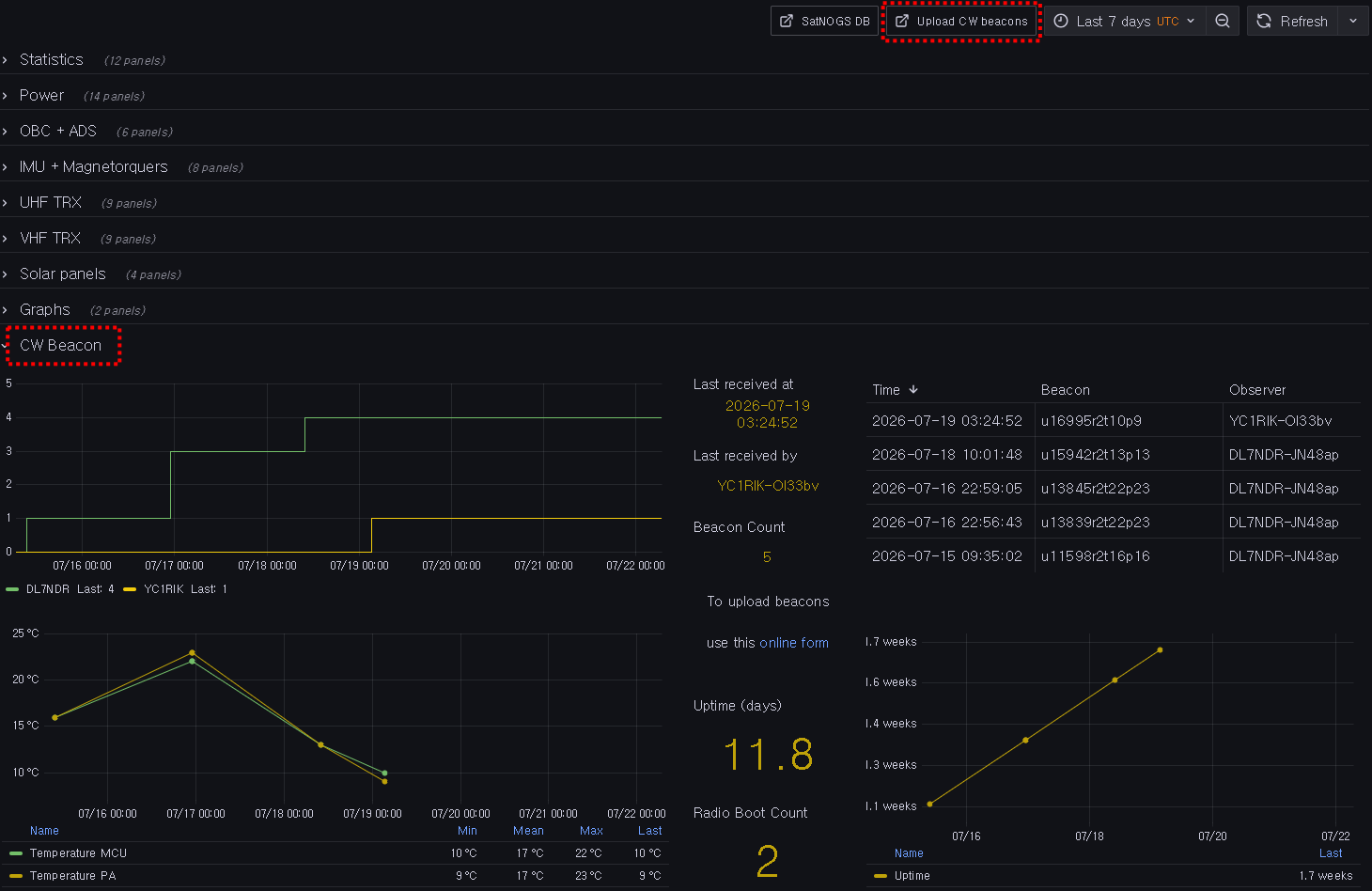

By the way, if you like to contribute CW data to Marina’s dashboard, you have to do it manually. Your observation’s data won’t show up on the dashboard.
Marina’s dashboard - CW Beacon row
However, your observations would be a good source for pulling out the necessary data.
