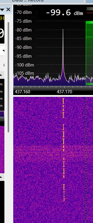

Signal is back at 12:34z over EU
73, Stefan/OE6ISP
During latest pass not a perfect match for TLE - a few KHz low at TCA - but no problem for CW :slight_smile:
73, Stefan
… and no more signal at 17:25z
