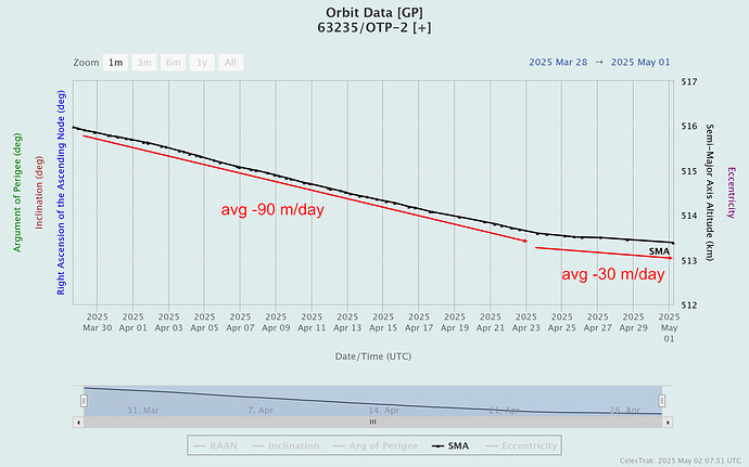

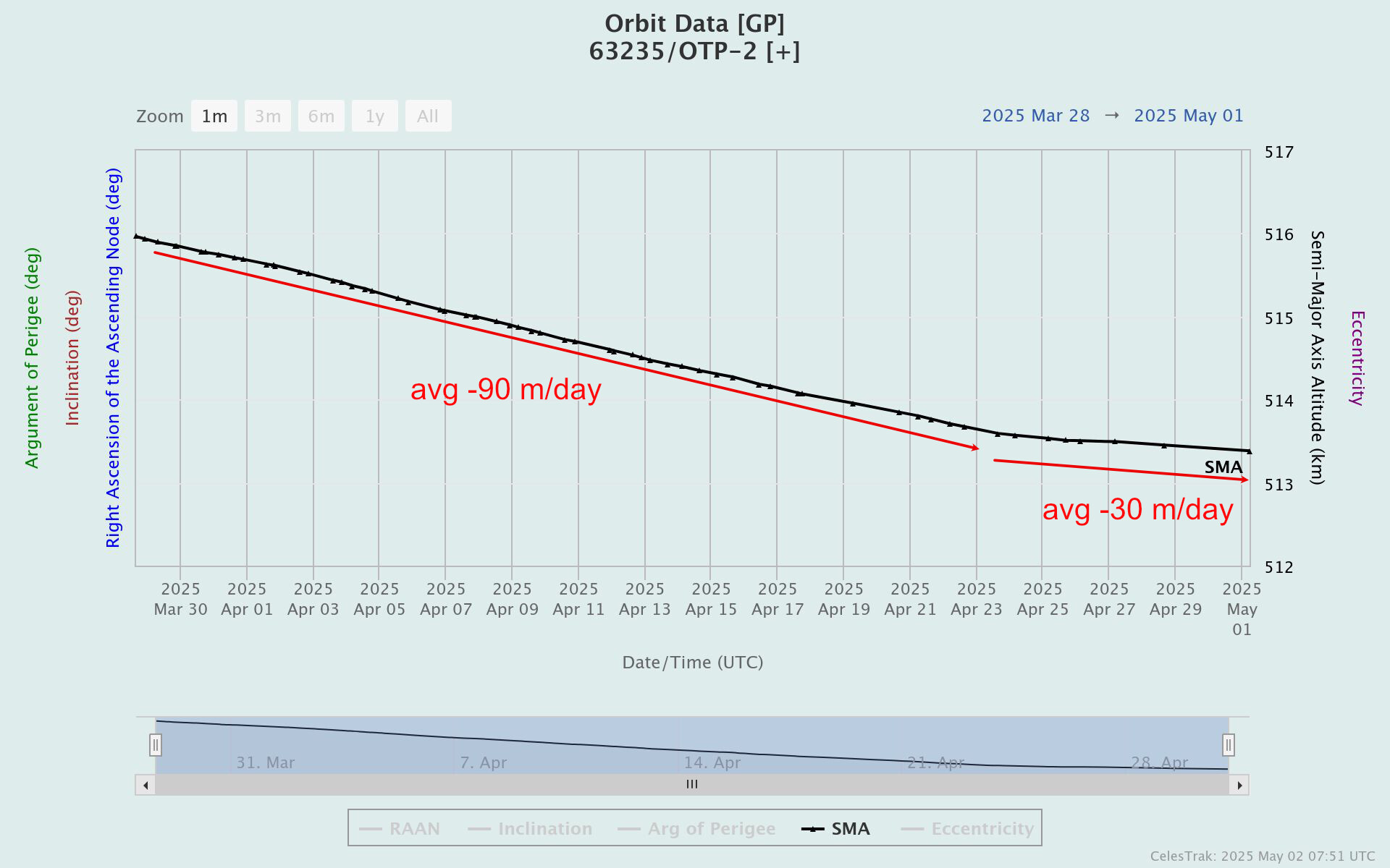

Do you have any idea why the drop rate (SMA) has slowdown in the last week to an average of -30m per day compared to the previous 50 days of -90 m/day. Thank you

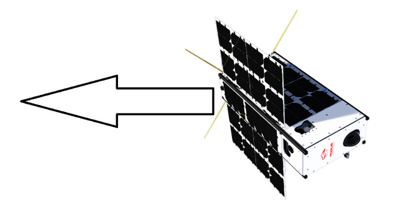

Most likely during the the previous 50 days the satellite has been maintained in an attitude with solar panel “against” the velocity vector. increasing the drag and therefore
most likely like in this picture. (probably camera is nadir pointing).
and now is flying with solar panel “flat” so minimizing the drag

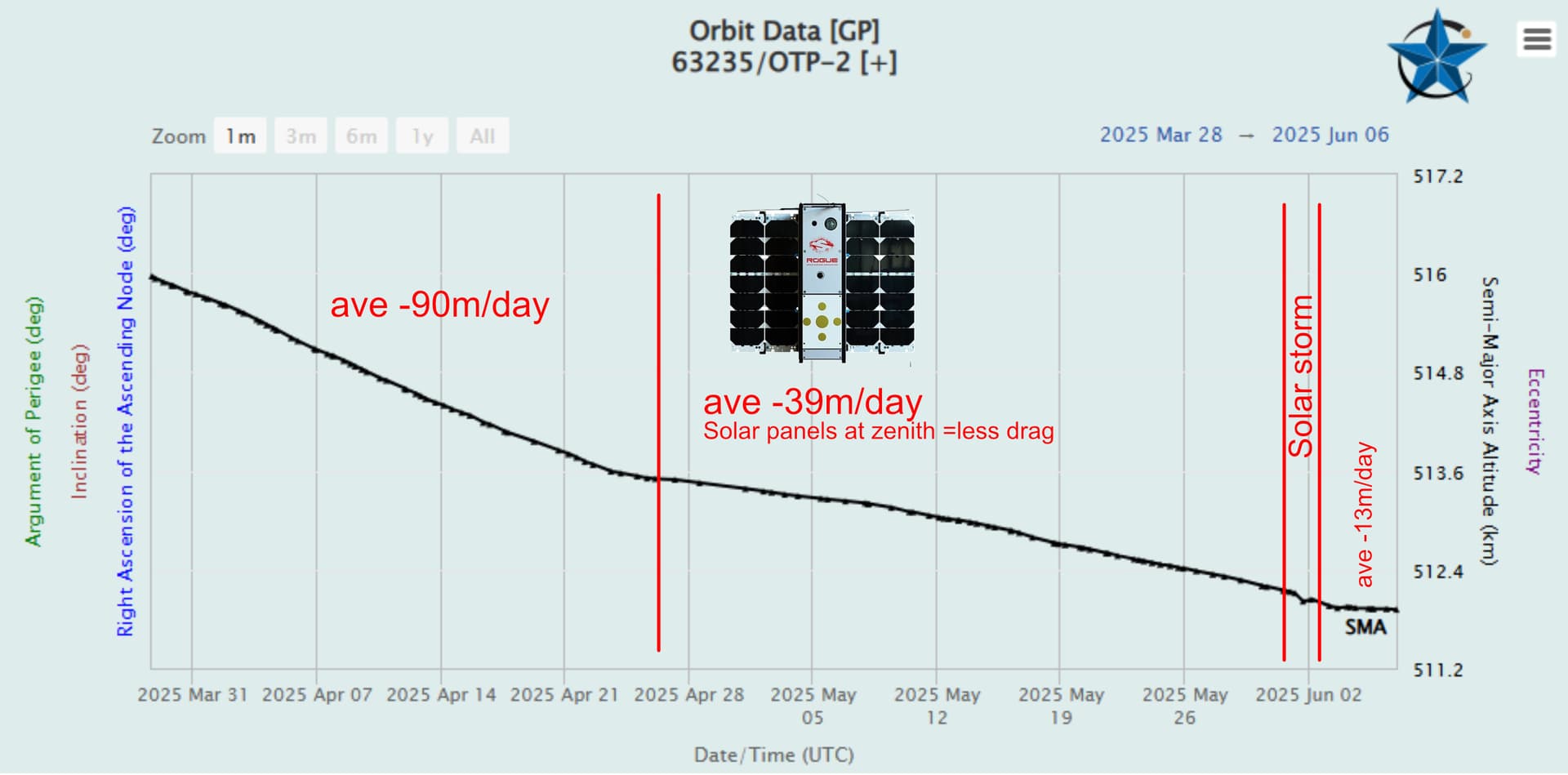

Yep. We are flying with solar panels zenith at this point - so lots less drag.
Thank you for update-you still in "System Shakedown’ Phase
I was looking that this “seemingly” random observation and baffled that it was starting to play KSP main menu song :sweat_smile:. Thank you @macphersonrss for schedulling this one, I really did not expect that haha. I think it’s always empty on all observation previously and I only expect regular telemetry transmission.
SatNOGS Network - Observation 11709129
hi - any idea wat happing in the pass week or so. Drop rate has now slowed to +/-13m/day- after the Solar storm. I presume this is more than the solar panels at zenith. Maybe Calligula can help?
