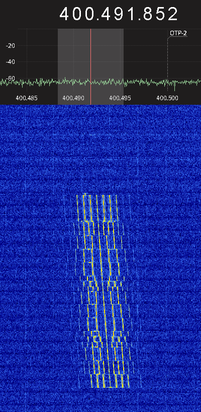

Observation 11488269: OTP-2 (63235)
Much Appreciated!
Thanks for your Guidance.

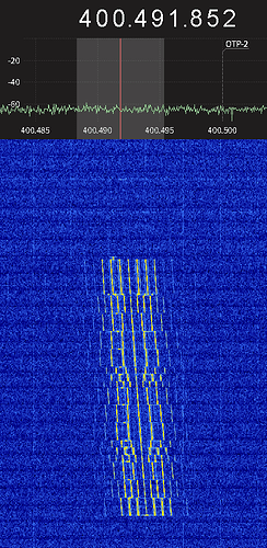

FSK signal with 7 kHz filter width in FM
decoding to something like this
OTP-2 audio level = 160(+88/-84)    ___|||___
Audio input level is too high.  Reduce so most stations are around 50.
[0.4 10:57:53] OTP-2>ESGS01:Y<0x11><0x01>3)<0x04><0x01>Q<0x00><0x01>“<0x00><0x00>µB‚<0x00><0x00><0x00><<0x09><0x00><0x00>6TŽHH<0x00>H<0x02>,<0x00><0x00><0x00>úC<0x00><0x00>;<0x01><0x00><0x00><0x00><0x00><0x00><0x00><0x00><0x00><0x00><0x00>ÀÌo\A<0x00><0x00><0x00>@à<0x1d>OA
U frame UI: p/f=0, No layer 3 protocol implemented., length = 80
 dest    ESGS01  0 c/r=1 res=3 last=0
 source  OTP-2   0 c/r=1 res=3 last=1
  000:  8a a6 8e a6 60 62 e0 9e a8 a0 5a 64 40 e1 03 f0  ....`b....Zd@...
  010:  59 11 01 33 29 04 01 51 00 01 93 00 00 b5 42 82  Y..3)..Q......B.
  020:  00 00 00 3c 09 00 00 36 54 8e 48 48 00 48 02 2c  ...<...6T.HH.H.,
  030:  00 00 00 fa 43 00 00 3b 01 00 00 00 00 00 00 00  ....C..;........
  040:  00 00 00 c0 cc 6f 5c 41 00 00 00 40 e0 1d 4f 41  .....o\A...@..OA
