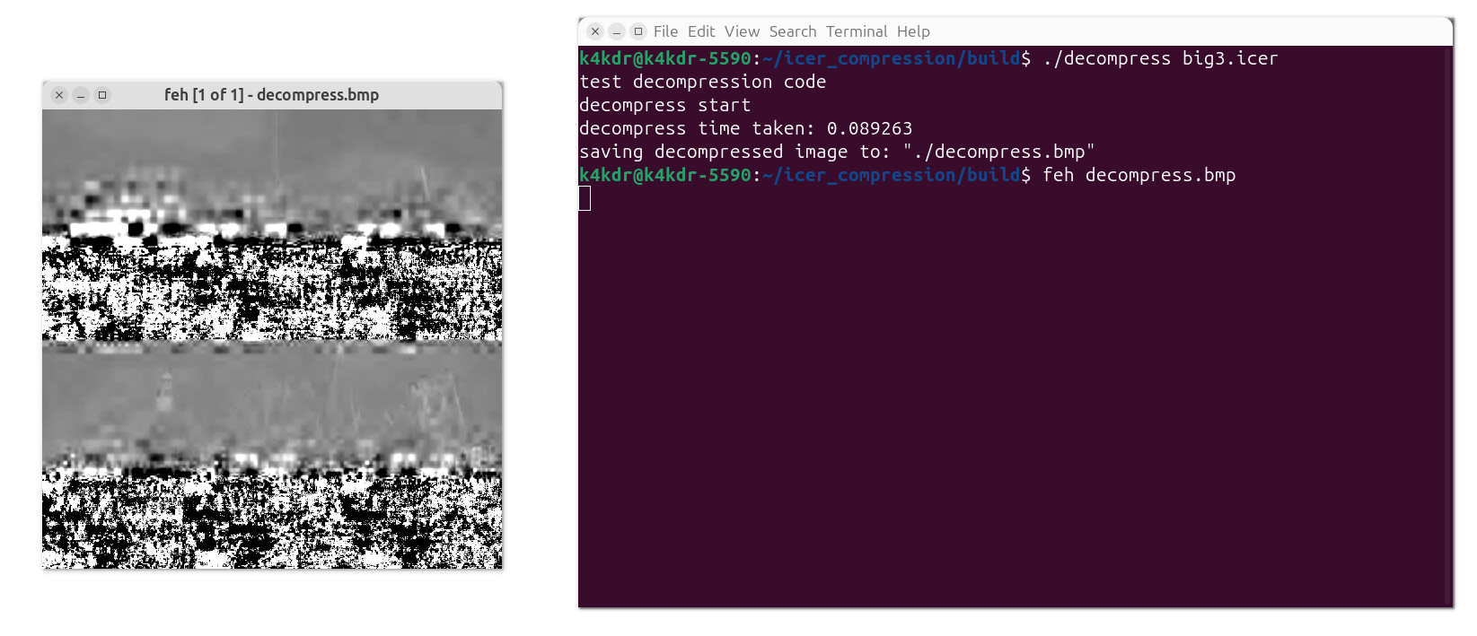

Well I feel silly. I never tested the ‘big3.icer’ file as black & white.
And it’s not a good image as the author stated, it’s a partial download.
But here is how to use the NON-color version of the decompress utility to render the image:

This is in fact a color image, not grayscale, which is why the grayscale decoder produces garbage. Missing/corrupted data does not lead to such artifacts (view README.md for some example images demonstrating this).
However, some parameters for configuring the decoder are not included within the image itself and need to be manually set. For the examples provided in the repository, these parameters are hardcoded, and must be modified to correctly reflect the configuration of the encoder.

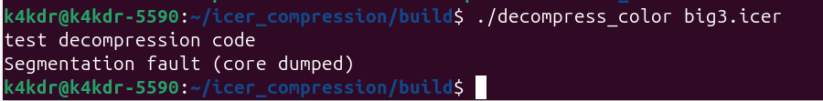

I am afraid that I get an error when attempting to decompress as color after making that source code change and re-compiling:
… am I perhaps not using the utility correctly?
Apologies, the examples were intended to demonstrate implementations of the library and not general usage as a utility, hence many values are hardcoded. The color decompression example has the input filename hardcoded and hence will fault if that’s not present.

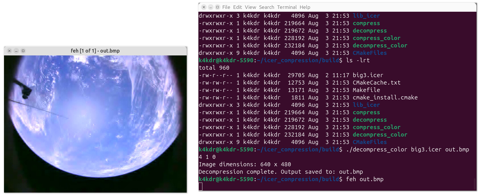

We can share a more general decompression utility. Replace the complete contents of ./example/src/example_decode_color.c with example_decode_color.c.zip (1.9 KB).
The utility provides a more complete and familiar command line interface. For example, to decode big3.icer to produce the decompressed image out.bmp, you can run
./decompress_color big3.icer out.bmp 4 1 0

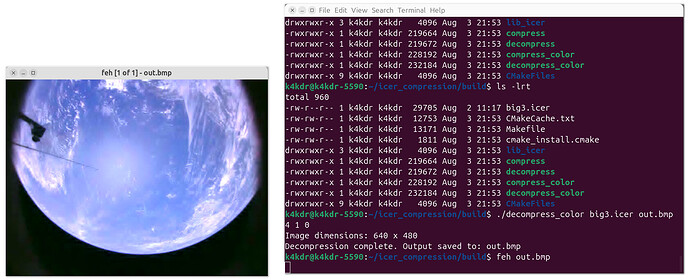

Wow! Now THAT is a picture!! Thank you so much for walking me through adjusting that utility to work with your data files. You might consider a Fork of that repository but adjusted w/ the new source file (so that people only need to clone & build it).
