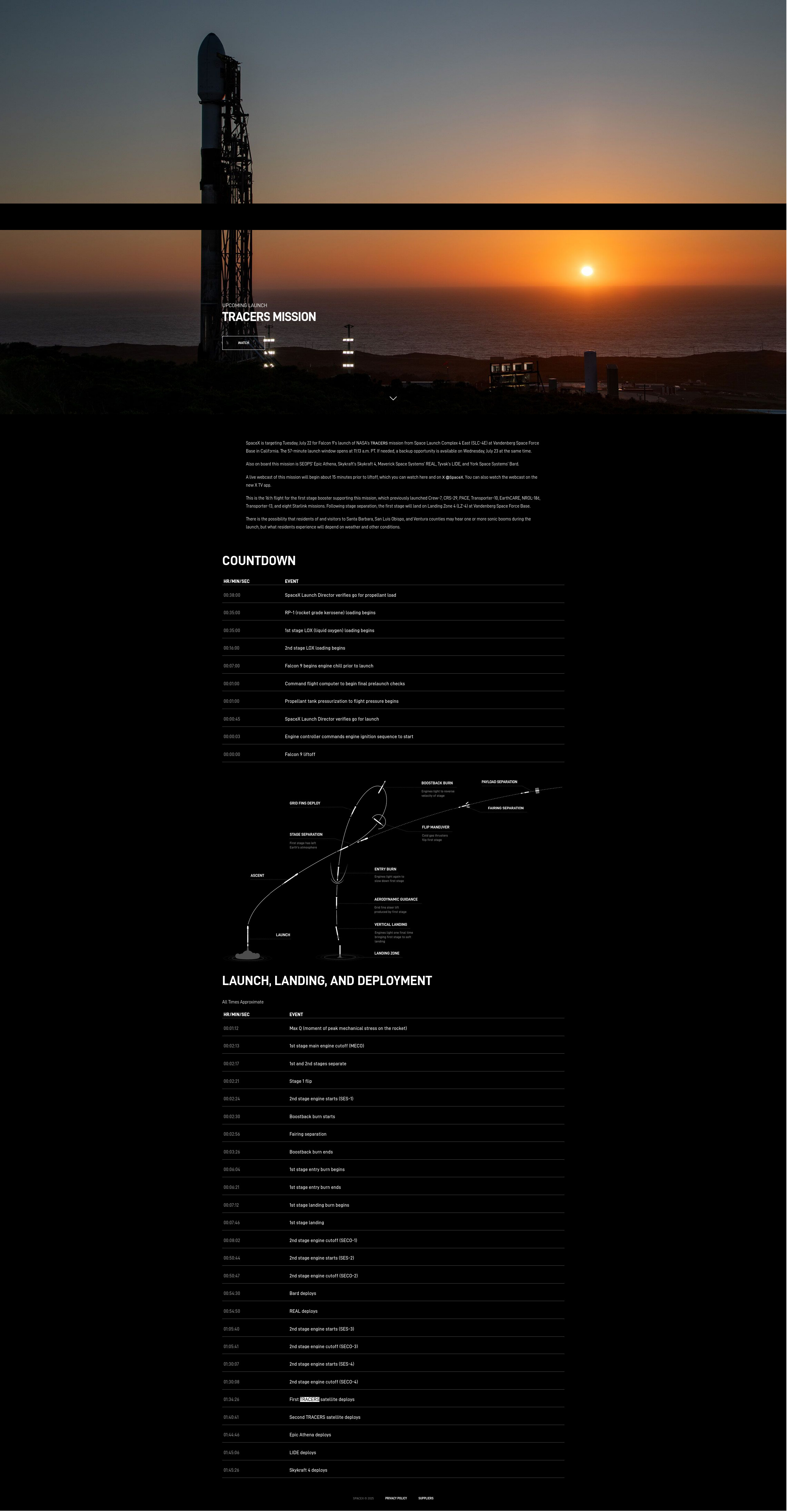

TRACERS Rideshare launch is later today, we are going to track REAL satellite at 450.060 MHz.
Sources for the launch:

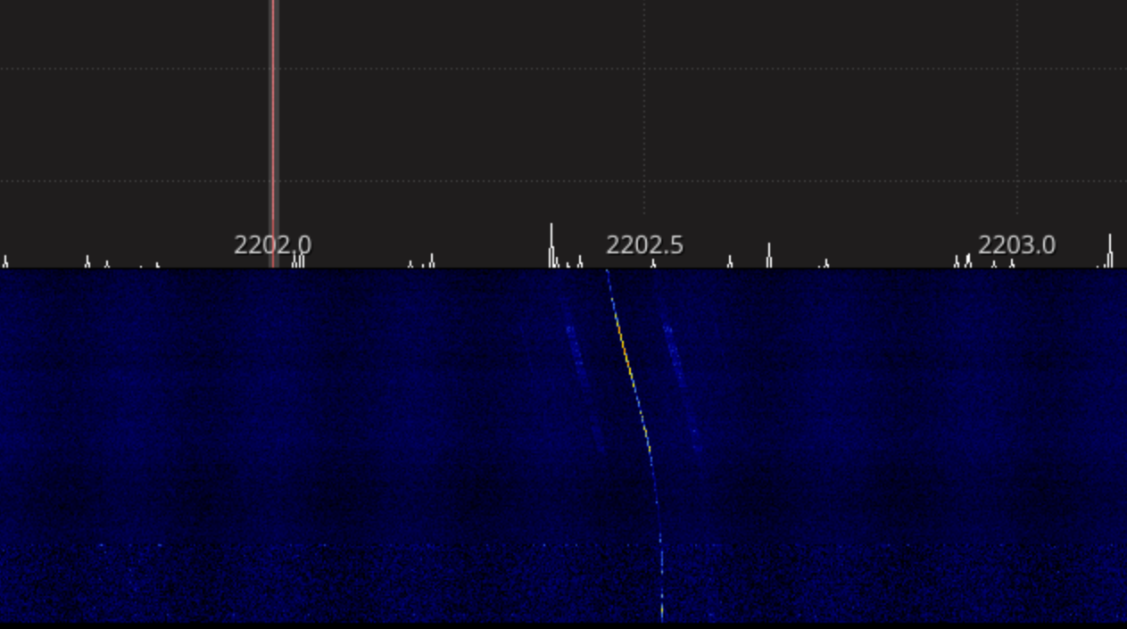

I was happy to finally get some 9k6 decodes from REAL on a higher pass over the eastern U.S. tonight, but a super-nice bonus was also seeing the S-Band downlink (with data sidebands!!).
Correct S-Band freq. appears to be in the area of 2202.450 MHz, but I’ll setup with narrow-er settings next time for a (hopefully) better view of the signal.

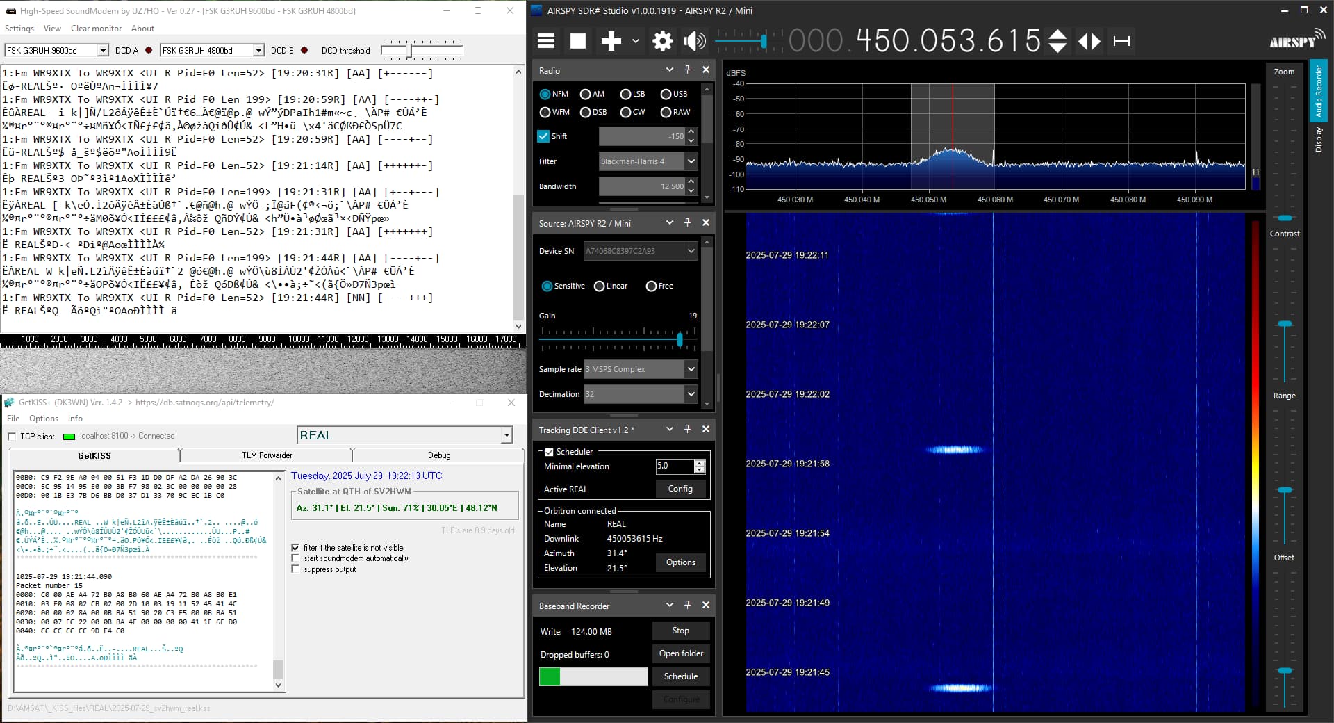

Good pass tonight of the REAL satellite at EM00.
15 frames were decoded from REAL but they were uploaded to the db with the followed NORAD id 64875, which looks a perfect match. Now, I am wondering, how these frames can be retrieved from the database?
well, it should end up here and you can request a export (when logged in) from the last week/month/everything.
Yes, it should, but it hasn’t happened yet. Maybe when the NORAD id is officially assigned to the satellite.
@PE0SAT do you know how this works for follows ? I guess it’s sids.
Yes it is and the Norad ID is determined by the TLE used. I don’t know what TLE source is used by @sv2hwm

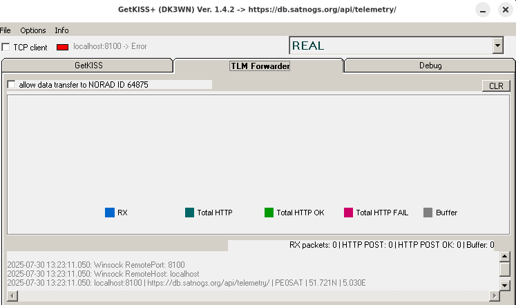

SatNOGS is following
REAL
1 64875U 25154G   25211.19365080  .00014221  00000-0  69638-3 0  9995
2 64875  97.4463 277.0514 0001826 120.0779 240.0636 15.18276189   968
When you use this with GetKissPlus it will forward with NoardID 64875 as can be seen by the statement “allow data transfer to NOARD ID 64875”
