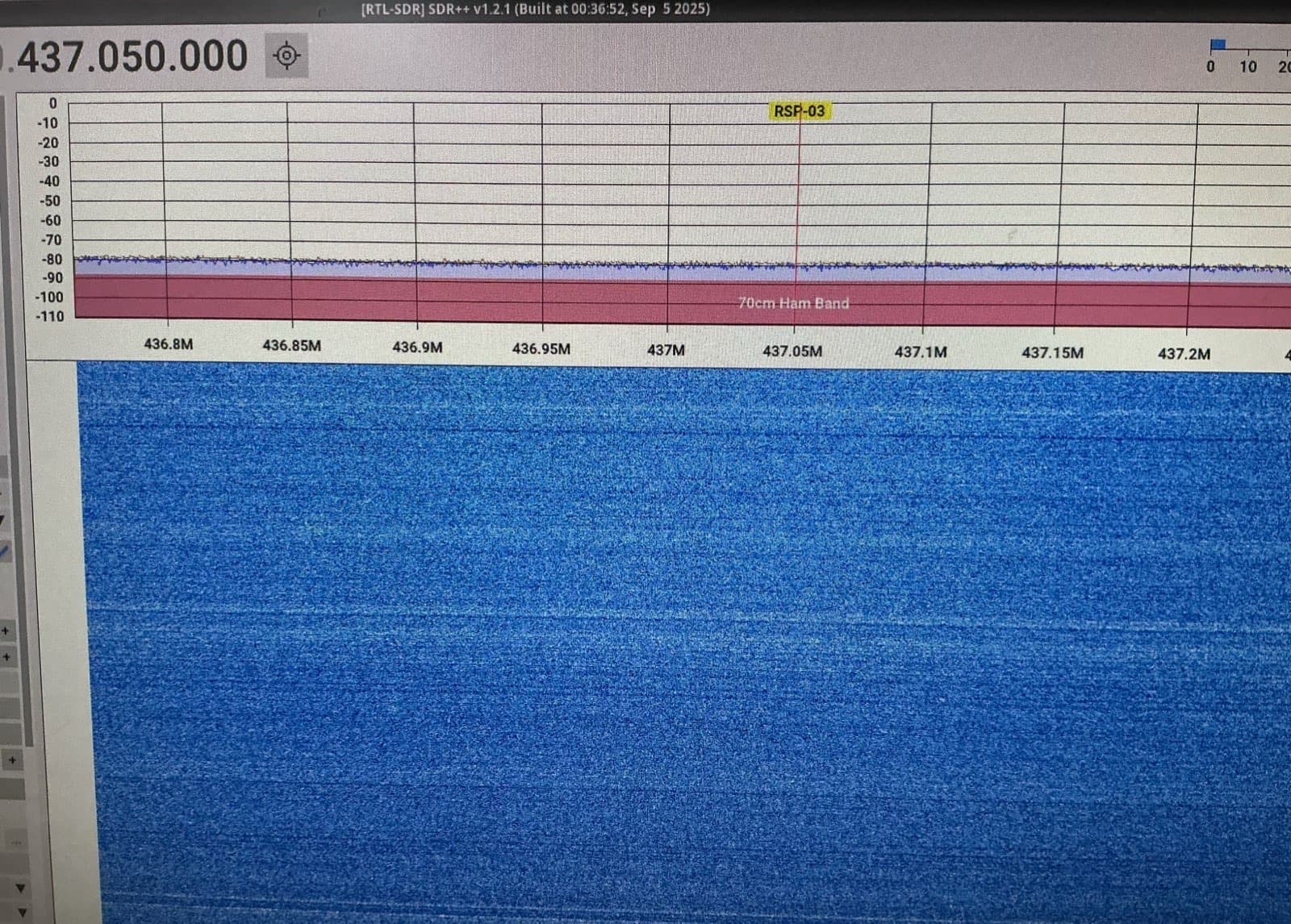

We may have heard a very faint CW-like tone from RSP-03 around 14:15 JST (~05:15 UTC). The satellite sat for ~6 months after handover due to launch delays, so we’re concerned about battery state. Still analyzing—could anyone cross-check recent passes and see a narrow CW trace near the expected frequency?
Any short notes or a snippet of audio/IQ would help. Thanks!
The only observation during that time shows no signal.

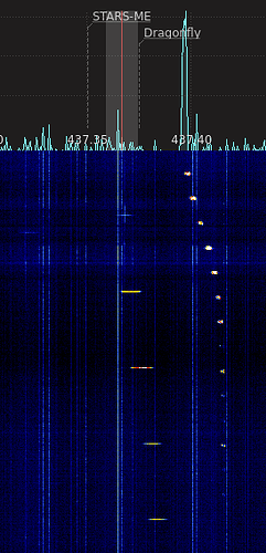

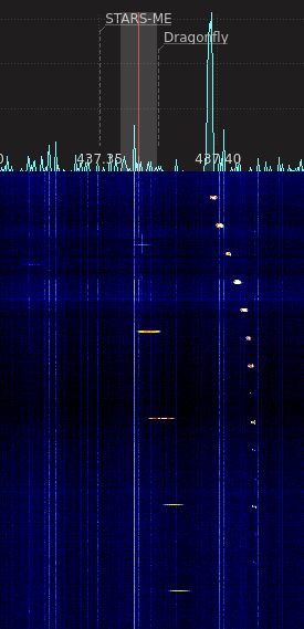

Seriously thought I had a strong signal from DragonFly over the Eastern U.S. tonight, but on replay-decode, turned out to be 9k6 BisonSat. An even stronger signal, possibly 1k2-something, was a little higher in freq. Was not able to decode that one.
Could the possibly 1k2 beacons in FSK (instead of AFSK) from STARS-Me2?

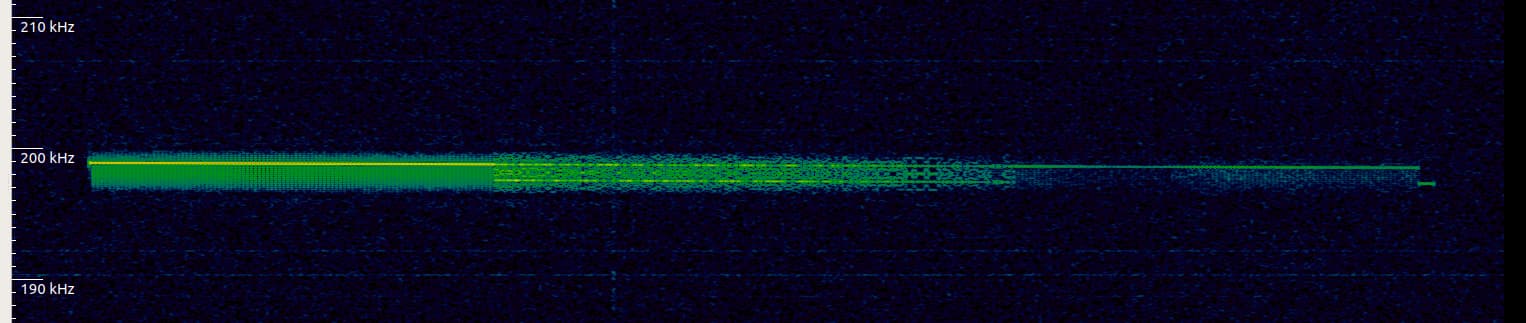

I can’t tell - and the RF freq would have to be way off. But at this point, we have to consider things like that. Here’s an I/Q of the strongest of those packets… about 200k above the center (zero) of the recording (625000 sample rate, float32)
https://www.dropbox.com/scl/fi/e8pr1bix2cjjdn0mf3tk0/unk_467sec_625000_IQ.raw?rlkey=7bemc84fv19mw9ic3pv86pwrm&raw=1
A similar observation in the Network:
Unfortunately none of the three signals belong to either Dragonfly or STARS-Me2.
From left to right:
  1. CW signal is KKS-1
  2. The wider FSK9k6 is BISONSAT as you noted
  3. The FSK1k2 is UPMSat2
