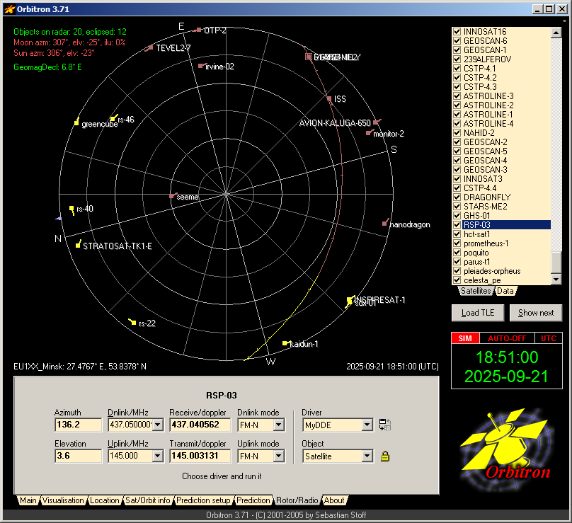

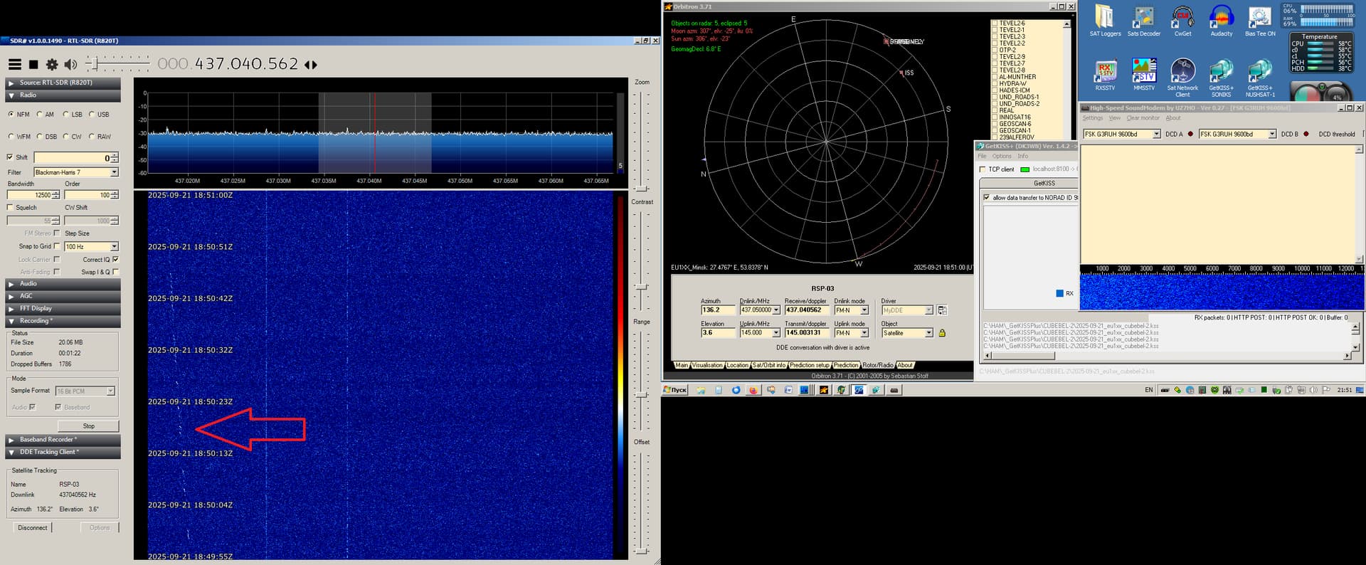

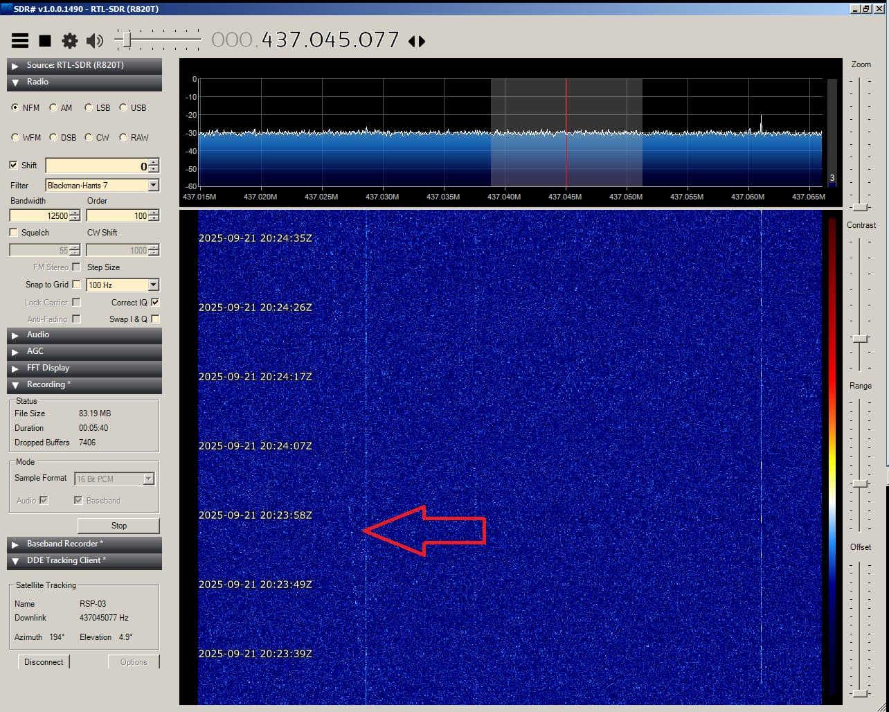

Today, at the alleged time of the RSP-3 pass, I several times observed a weak signal similar to CW with a pronounced Doppler effect.
The frequency is approximately 25 kHz below the calculated one, i.e. approximately 437.025 kHz.
I do not know any sat at this time at this frequency over KO33ru.
In SatNOGS observations I did not find this signal, or too far from the central frequency, or too weak.

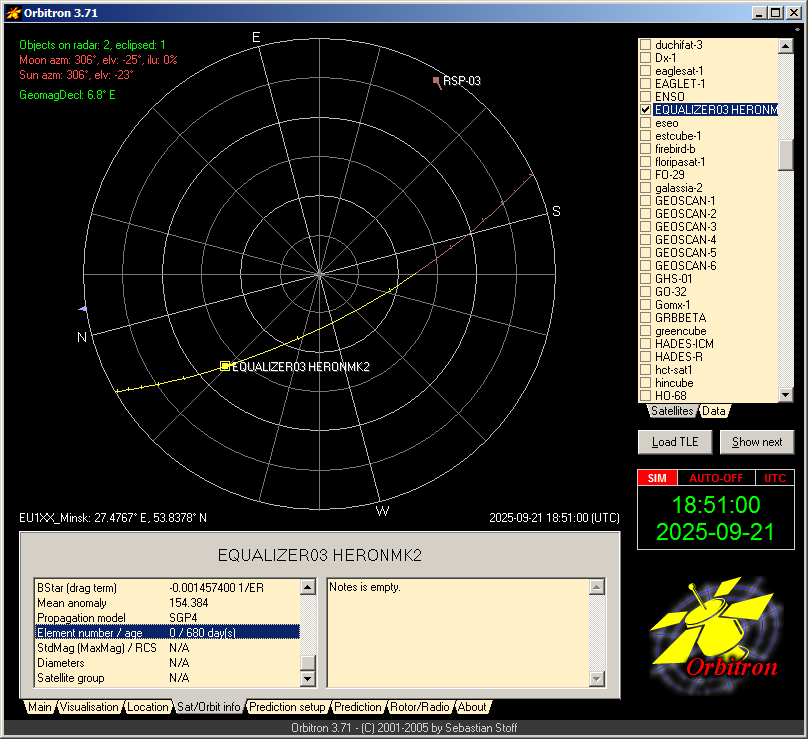

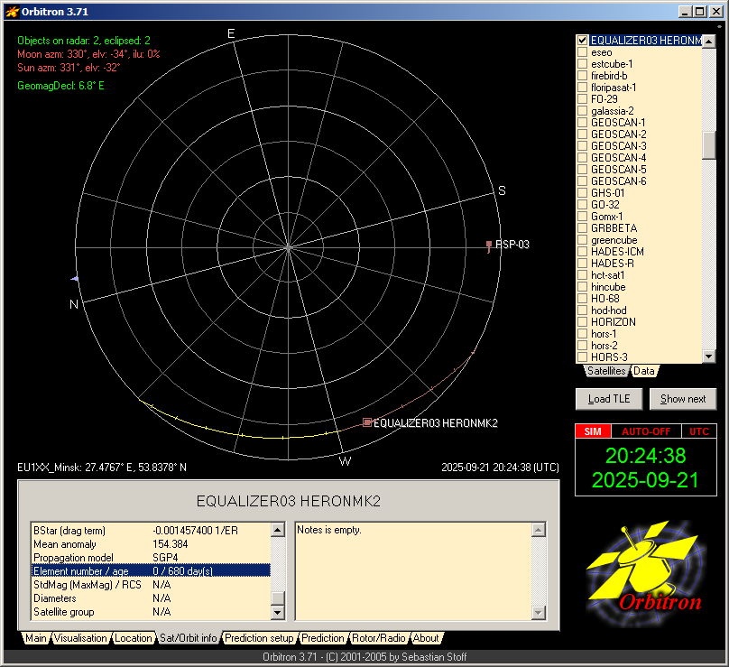

EQUALIZER03 HERONMK2
1 70375C 23174CC 23315.83661433 -.00026412 00000+0 -14574-2 0 09
2 70375 97.4819 28.7762 0009329 264.3585 154.3842 15.14010932 14

Before adding another transmitter for experimenting, I would suggest we get a couple more observations from different locations from this signal.
All these satellites except 55103 and 70375C are in my base and have already been checked.

RSP-03 437.050 kHz over KO33ru:
12:45-13:25 UTC - NOTHING HEARD
14:05-15:00 UTC - NOTHING HEARD
15:50-16:40 UTC - NOTHING HEARD
17:40-18:05 UTC - NOTHING HEARD
19:20-19:50 UTC - NOTHING HEARD

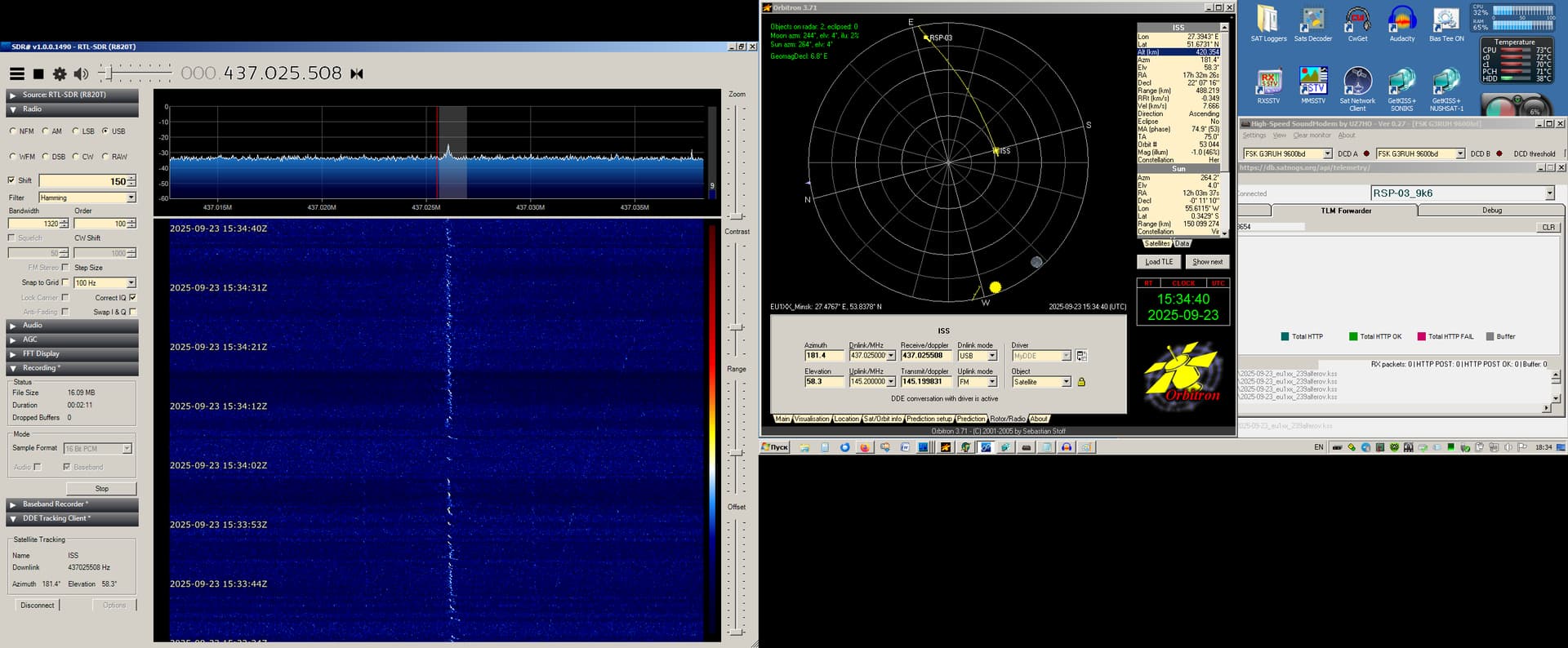

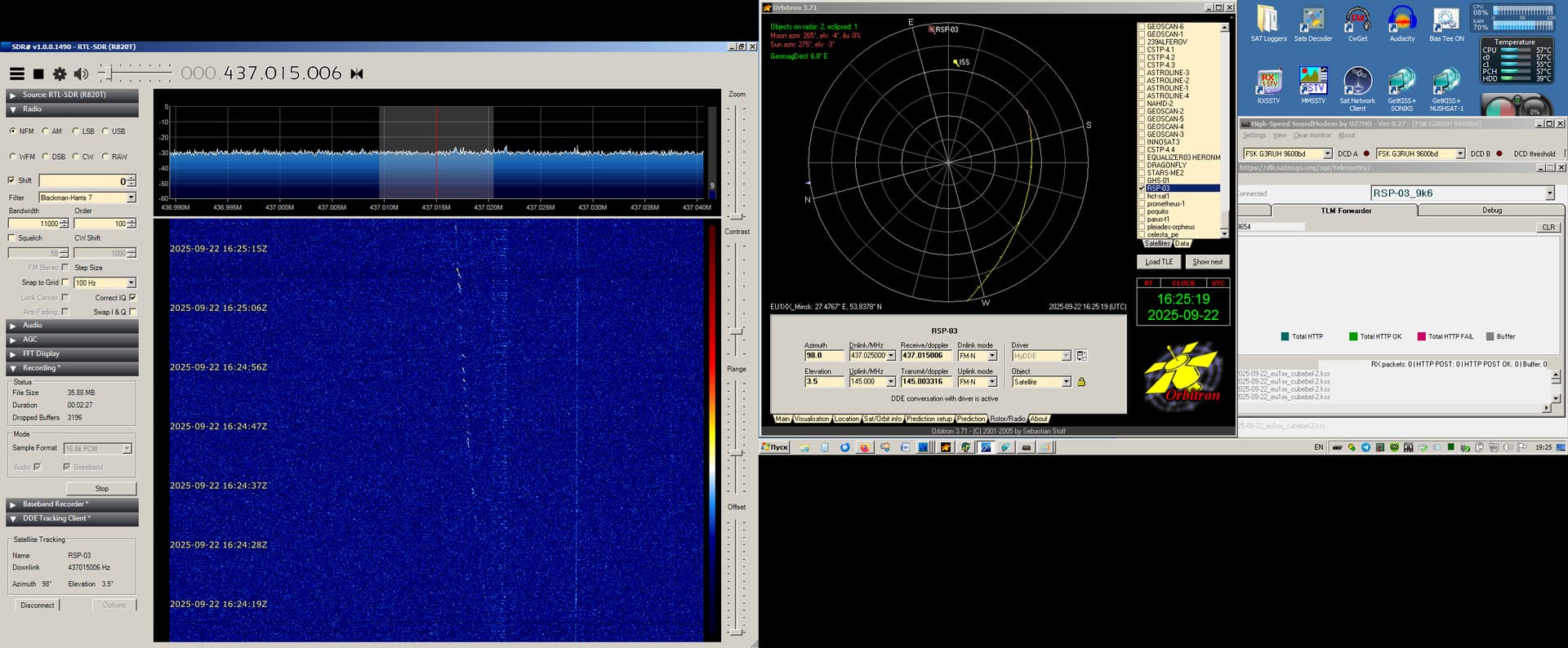

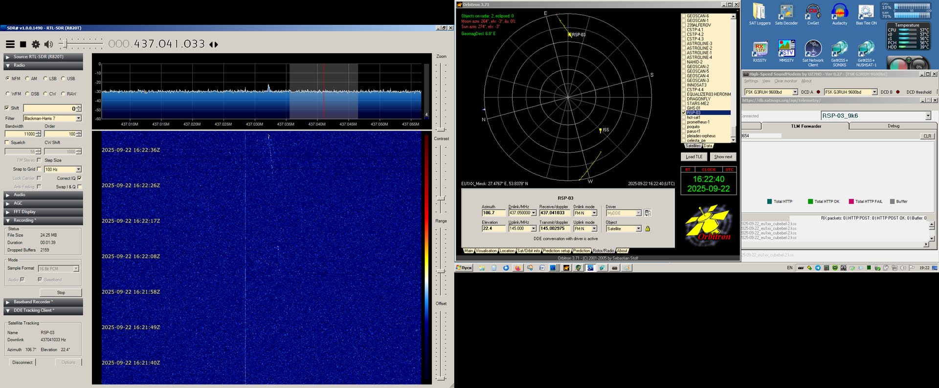

at 437.025 kHz Unknown satellite heard again
16:18-16:26 UTC
17:59-18:01 UTC
19:38-19:39 UTC

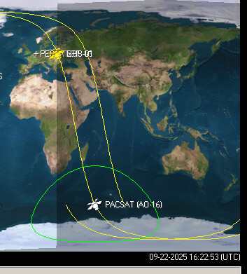

Thanks for sharing the audio file, listening, I immediately reconsigned the garbled AO-16 tones and that is sometimes active on 437.026 MHz
I guess when you add object 20439 you will see Amsat Oscar 16 also passing.
According current TLE It can’t be 20439 !
Or Space-Track again confused the satellites in places?
MTV …MT approximately in CW as I hear
Thanks,
Looking at the date and time AO-16 shouldn’t be in your foot print.
A mystery, let investigate further.

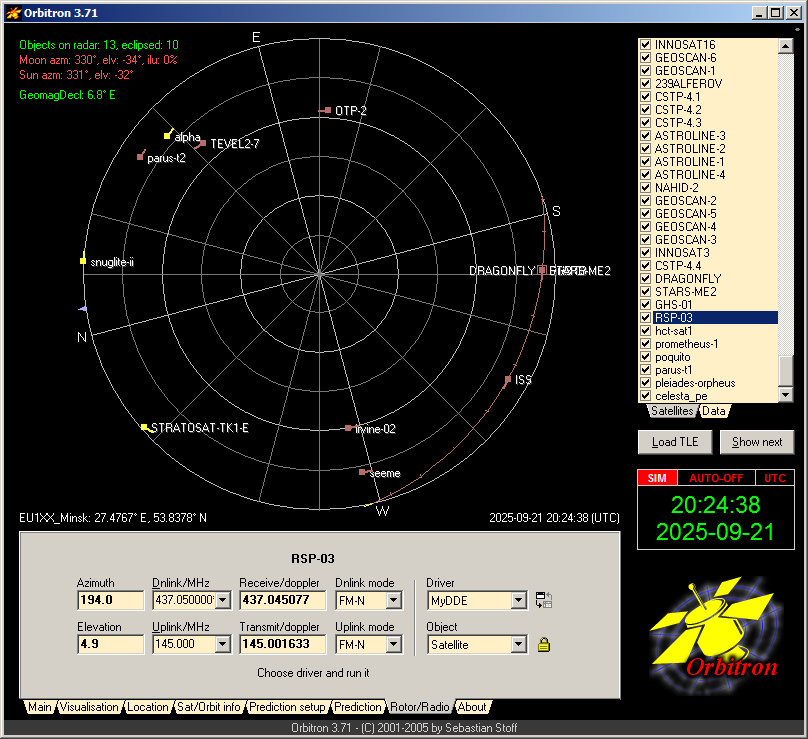

@EU1SAT I checked your observations and based on the UTC timestamps you provided either in the screenshot or the text, here is the list of the LEO satellites that were passing over your station (at KO33ru) at all these timestamps:
| NORAD ID | Satellite Name |
| 25544 | 0 ISS (ZARYA) |
| 36827 | 0 PRISMA (TANGO) |
| 49044 | 0 ISS (NAUKA) |
| 63129 | 0 PROGRESS MS-30 |
| 63520 | 0 SOYUZ MS-27 |
| 64751 | 0 PROGRESS MS-31 |
| 65077 | 0 DRAGON ENDEAVOUR 6 |
| 65304 | 0 DRAGON CRS-33 |
| 65586 | 0 PROGRESS MS-32 |
| 65616 | 0 CYGNUS NG-23 |
To be honest I wouldn’t expect any of them to transmit at ~437MHz, so my guess is that it could be one of the deployed satellites. Except if we miss something.

Unknown satellite is ISS !!!
“The truth is out there”
SDRSharp_20250923_152914Z_437035028Hz_AF.zip (7.5 MB)
IQ Files in my Telegram channel:
Unexpectedly an unknown satellite is the first object from your list ![]()
